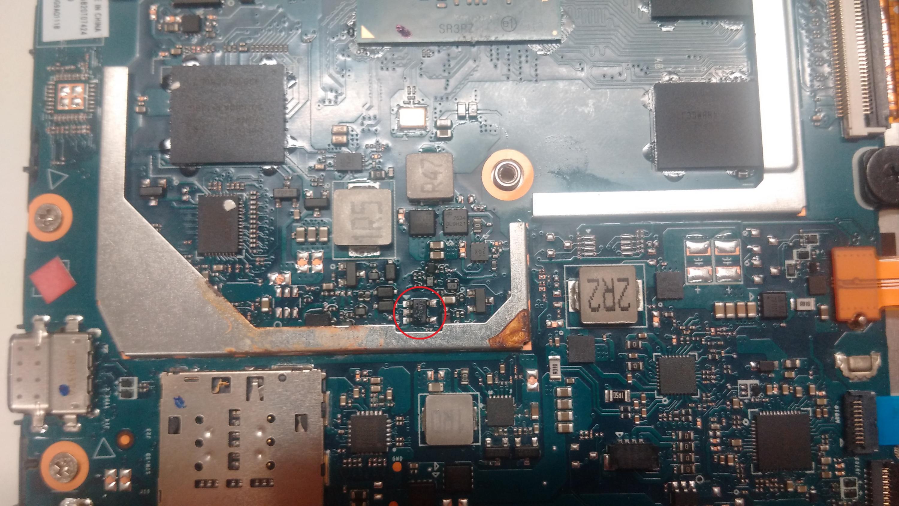

    Hello, I have laptop Lenovo ideapad D330-10IGM which won't turn on. It was water damaged, but as I know it was clear water. I cleaned the board already.
    Now, I noticed, that some component is heating up (see picture) there is a code GAASKJ on it. I don't really know what component is this and what is it's function.
    It seems that charging works normally because current draw is about 1A and voltage is 19V.
    Could you help me with it?
    Thank you
    BTW there is a flux on component. No damage.
    Martin

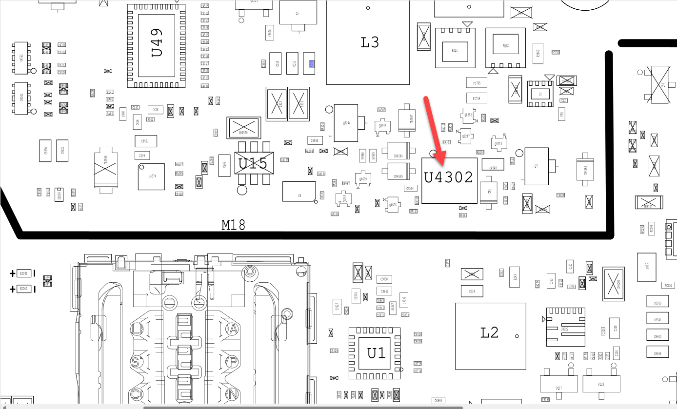

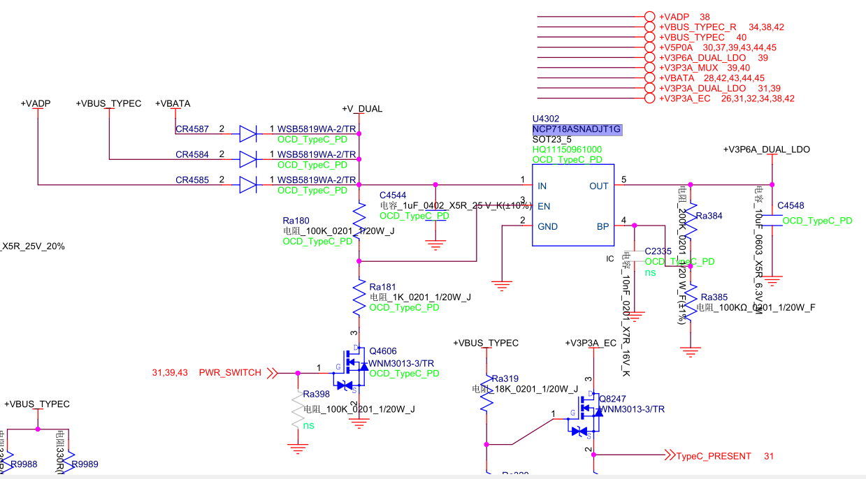

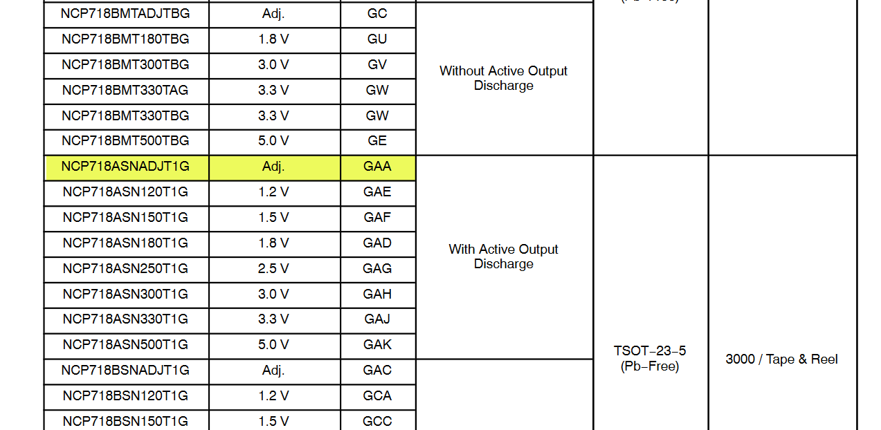

    Re: Lenovo ideapad D330-10IGM can't power on (water damaged)
    p/n NCP718ASNADJT1G
