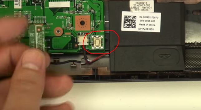

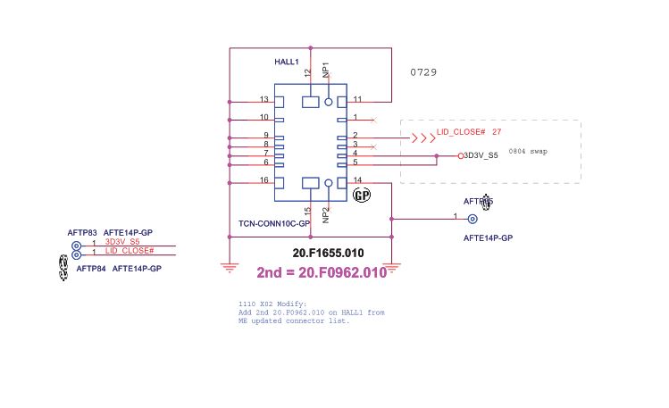

    Check Hall1 connector on the mb.What is the voltage on PIN2 and 4?? If pin2 has no voltage, then jumper a wire between pin2 and pin4 and you will get display for sure.

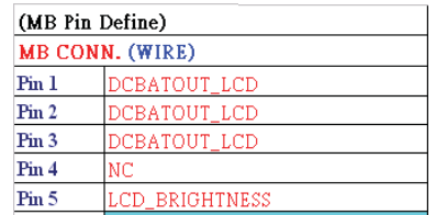

          this is shcematic

              see this shcematic i have 1.2.3 pin i have 19 v and 4 pin i have 3,3 v

                      Hall sensor is there on Pg70 and pin1 and3 are non connected. How you have 19V there. The hall sensor is located at the extreme right hand lower side near 3/5v regulator IC. I still feel you are measuring at some other location or your measurements are wrong.

                        see in schematic bro is 19v for light lcd pin 1,2,3 . pin 4 is NC and i not have voltage
                          see is pin 1.2.3.4.5

                            You've proved i was right in assuming that you are measuring at wrong location. You are measuring at LVDS ConnectorLCD1. I asked you to measue HALL1 connector for which i've given you even an idea about its location.
                            Now locate it correctly and measure pin2 and 4.

                                pin 2 i have 1,3v and pin 4 i have 3,3 v

                                      yes understand jump pin 2 and 4 now i have more brights but not figure
