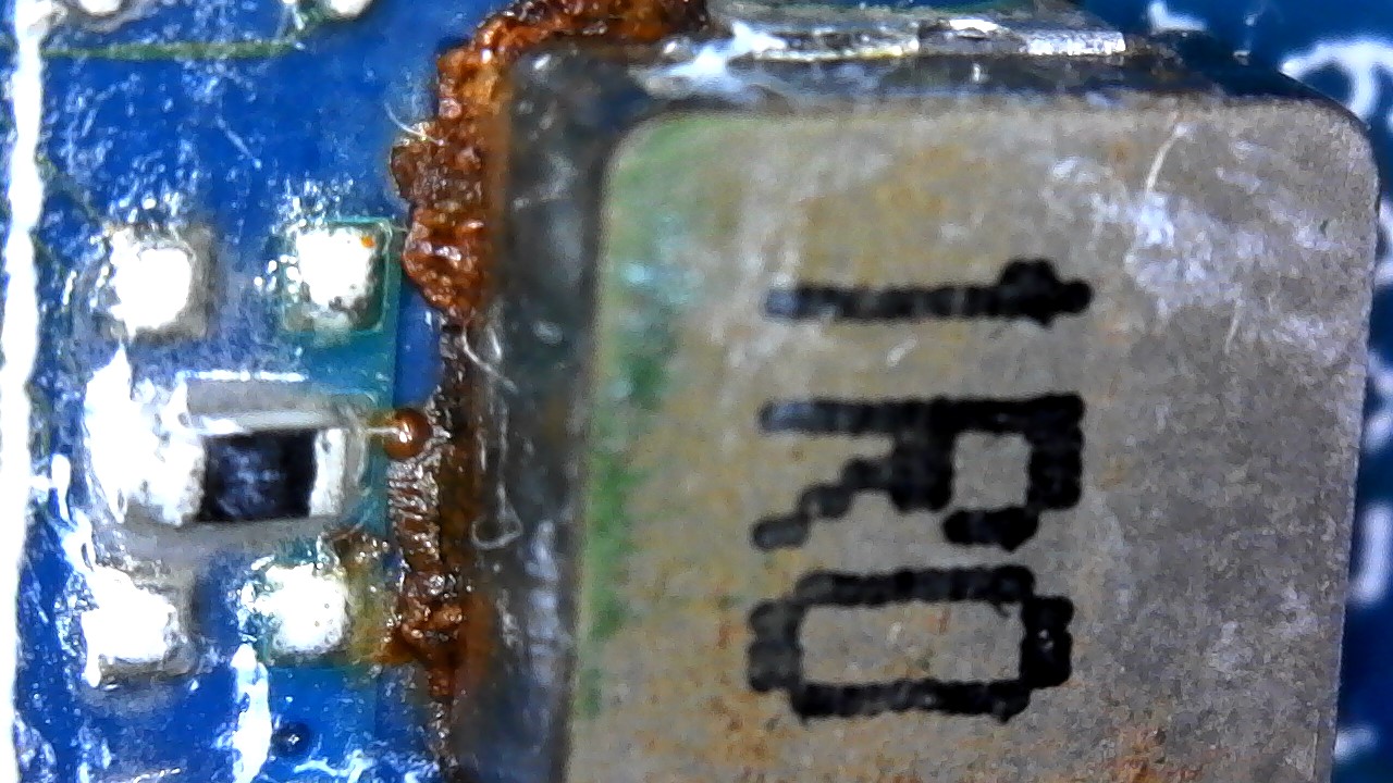

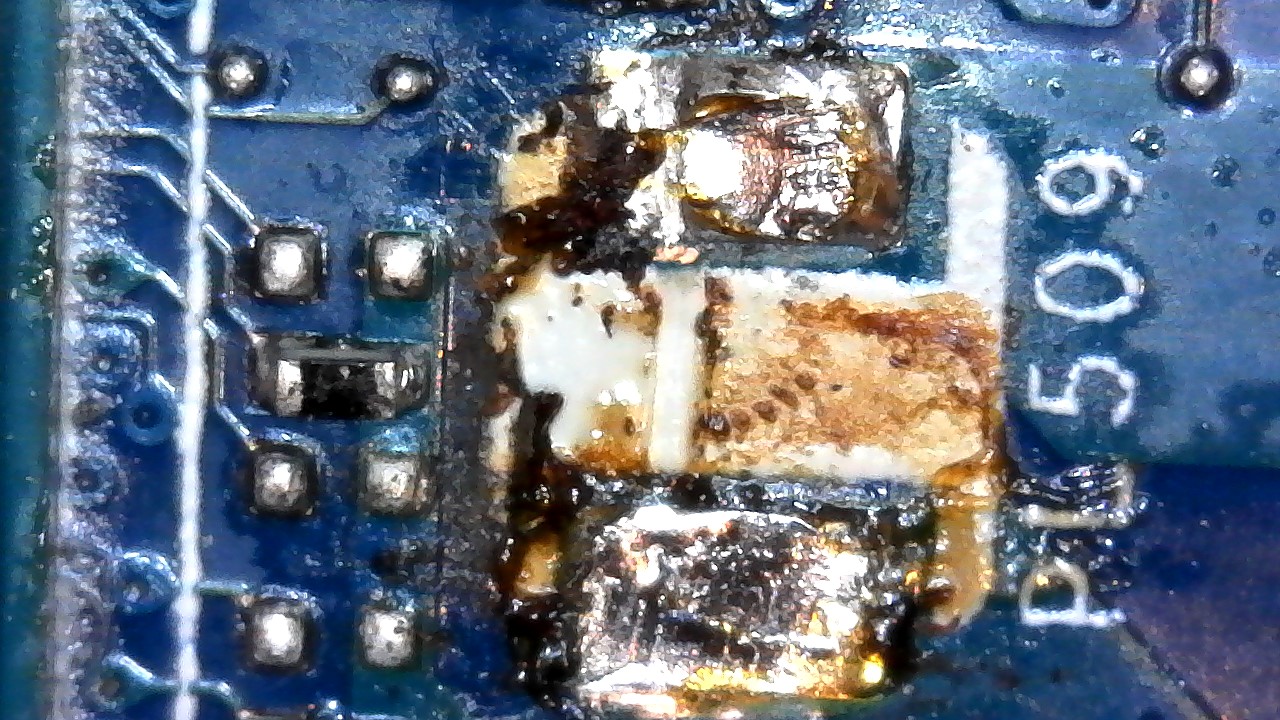

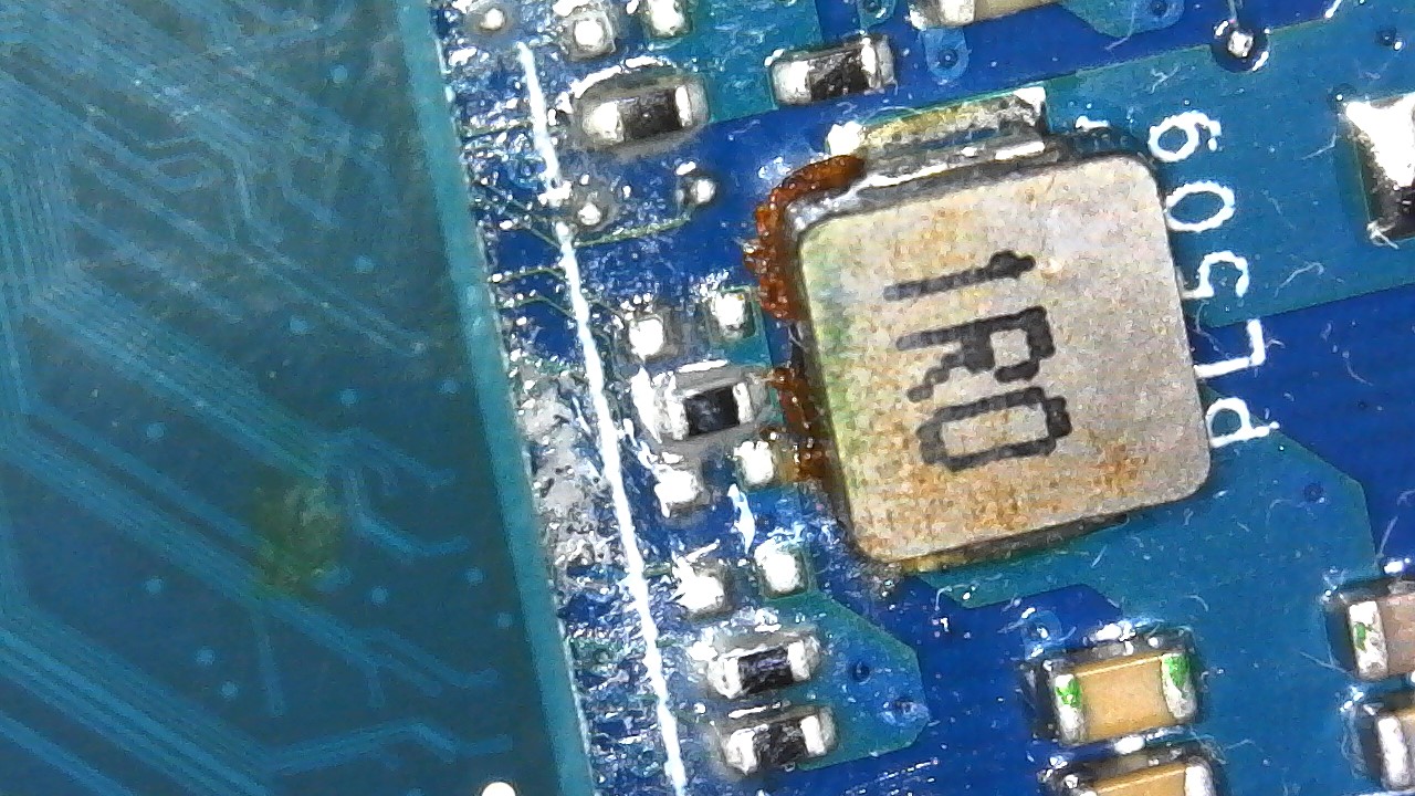

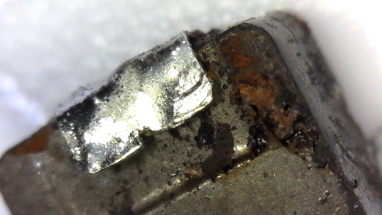

                    I flashed the firmware, no help. I found a leaking inductor at the CPU. The inductor measures 4.18mm LxW 1.83mm H. I believe that it is a series 4020 chip. The part I found is SRP4020TA-1R0M, would this be the correct one and will this cause the CPU overheat fault code?
                    Sorry for the noob questions. I'm new at this.
                    Thank You very much for your help
                    Dave

                      1uH inductor coil try to clean the board and put new 1R0 coil try also remove the mosfet connected to this coil and replace it.. and see how it goes... please post progress
