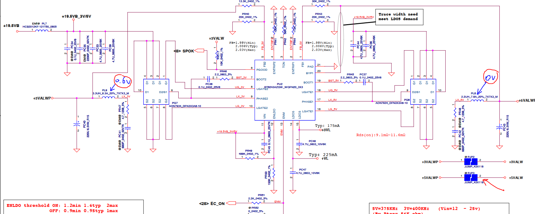

    Hi everyone
    hp 250 g4 LA-C701P is dead
    when i plug in the charger the power led is on but when i press the power button nothing happen
    when i press the power button the ic PU2 (RT8243AZQW 3/5V) becomes hot ; i change it with new one but same problem
    EC_ON , MAINPWON signal are exist and LDO3 AND LDO5 Exist too
    VIN voltage exist
    everything is ok and no short on output pins
    but i don't know why the ic becomes hot .

      Check boost capacitor and feedback rasistor

        What is the voltage on pin 13 of PU2 when you turn it on?? Impedance on coil PL8/PL9 in diode mode?? Resistance in Ohms mode??
          pin13=3.3
          PL9 1014ohms
          but pl8 360ohms sometimes becomes 30ohms .

                i desolder the jumber PJP3 but same problem i think the whole problem in 5VALW side .

                  Remove jumper PJP2 also and check again whether PU2 is still getting hot. may be bad KBC.
                    I do but PU2 still getting hot .

                      Measure resistance on all pins of PU2 and voltage on each pin. Are you sure you soldered a new PU2 or pulled from scrap mb??

                        op said i change it with new one but same problem.
                        something is shorting pu2.. if you done desoldering the jpj2 jpj3. and still the ic overheat.. maybe its a bad ic batch... can you picture the pu2 for us.. tnx..

                          i pulled from working motherboard , i'm sure .
                            yes i desolder jpj2 and jpj3 and i also desolder pl8 but pu2 still overheating without output .

                              unfortunately the client take back his laptop , thnx mcplslg123 and duration for help .

                                I'll still bat for this ic being bad or badly soldered. However, its useless now since its no more with you.
