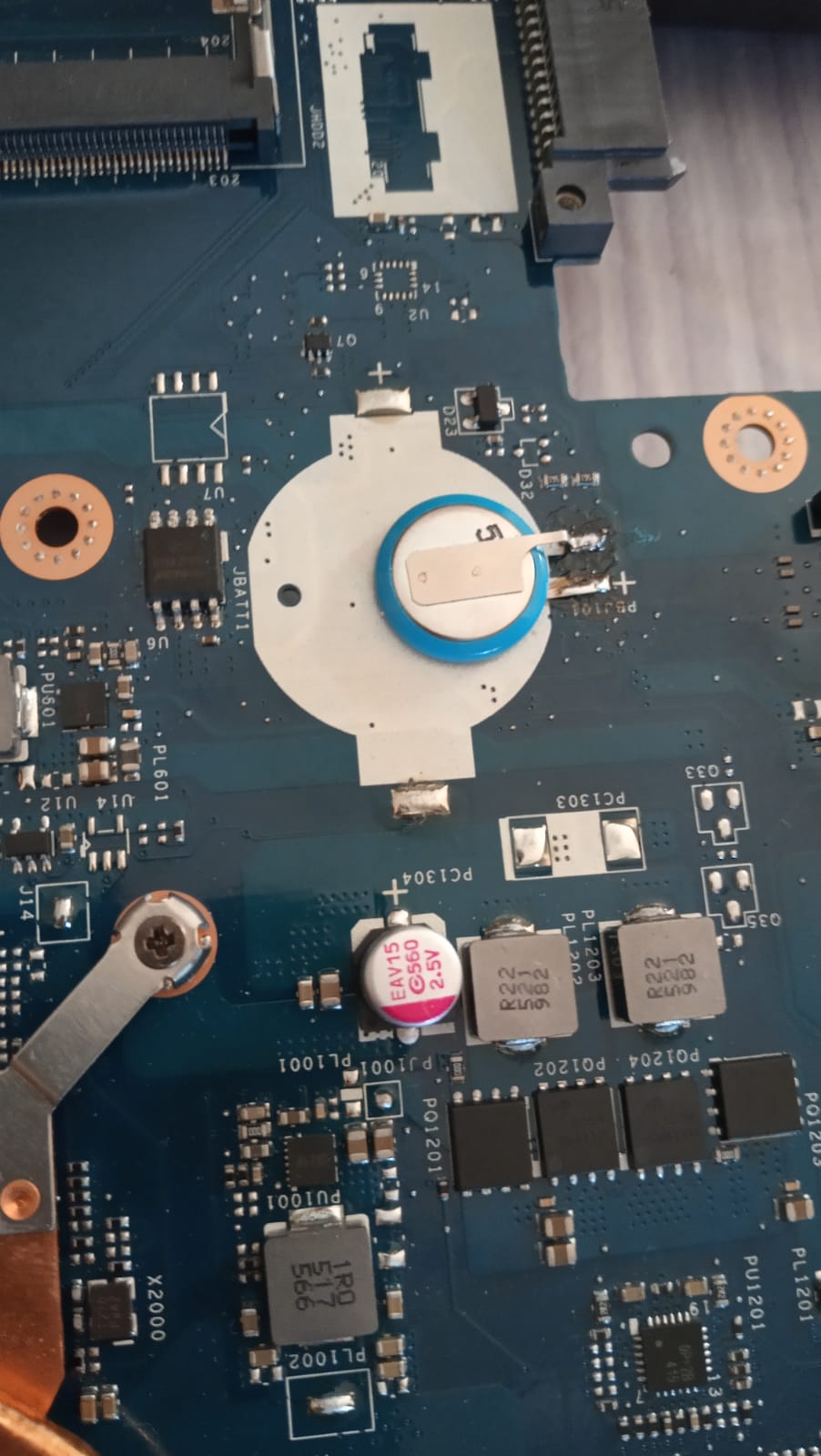

                    Re: Asus E5-571G no power
                    Originally posted by Duranitron
                    check all voltages specially the always on voltages.. 3.3vALW 5vALW and also the voltage supply for the bios ic.. check also the cmos battery..
                    The buffer battery that powers the cmos is 2.66 volts. It is a normal value ?
                      better yet change it to isolate the problem,can you post the model number located on the motherboard and lets try to find the original bios dump for you laptop.. did you check the bios ic pin voltage?

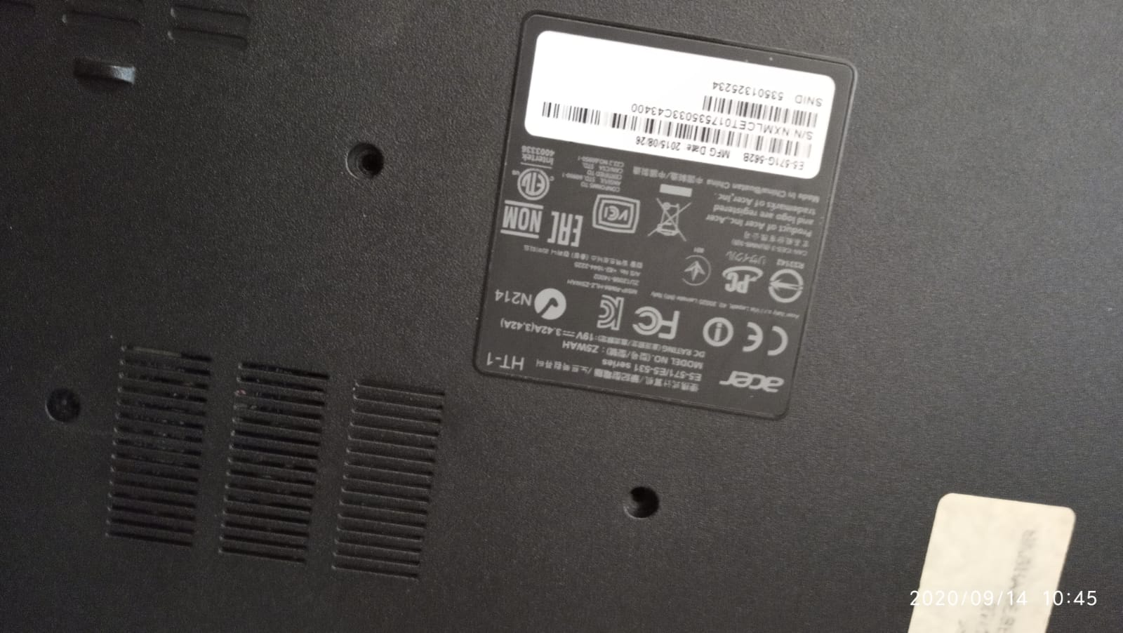

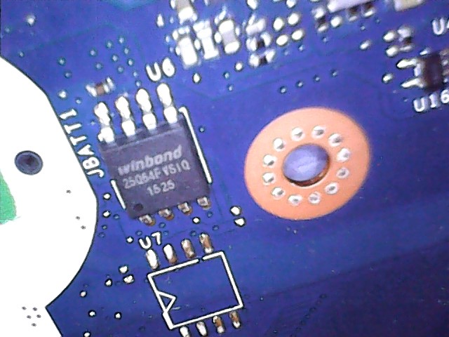

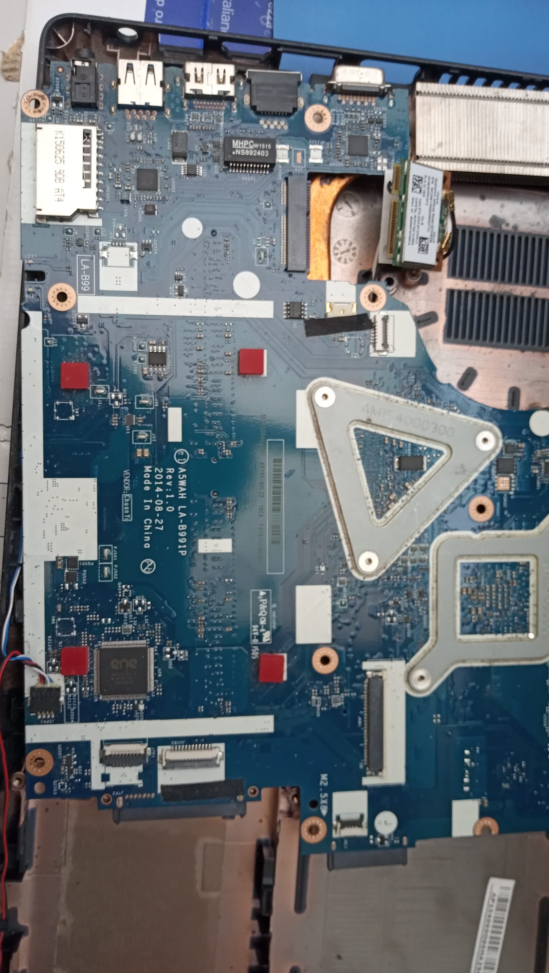

                        pin 8 of the 0 volt port, it is possible that the bios winbond 25Q64FV SIQ at this point is not powered ...
                        it's possible that it's broken ... in the meantime I ordered some empty bios to be programmed
                        Acer E5-571G-562B A5WAH LA-B991P.
                        I am attaching the motherboard
                        I also attach the photo of the bios ()

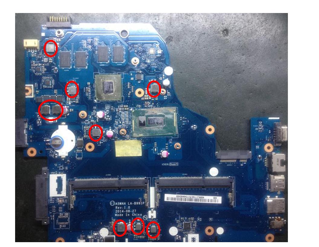

                          when you power on the laptop you get 0 volt in bios pin 8 vcc must be 2.7 to 3.3 volts... did you replaced the bios battery?.. trace it why it has no voltage...
                          Never stop LEARNING because life never stops TEACHING!

                            here is the schematics trace the vcc of the bios ic first...try to take off the eeprom and measure the voltage in pin 8 of the board.. you must get 3.3volts..

                              The CMOS battery voltage is a little low. You don`t have +3VALWP voltage, check voltage on PU401.

                                I have made a more accurate measurement .. I find myself the following measures:
                                Battery voltage 2.8 Volt
                                Integrated PU401 to pin 8 I find 3.40 volts

                                    here is were you measure all the voltages.. be careful when measuring it dont short anything...
