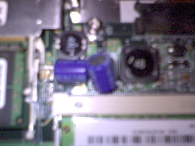

    Hiya, decided to take the plunge and attempt to repair my tempremental Lappy.
    After going round in circles with a bizarre power up issue [takes 100's of button presses to fire up] and being told numerous answers that all failed, i think i have narrowed the problem down to the 2 sanyo caps next to the pcie wifi slot.
    Warming them a little with hot air allows the machine to boot normaly, cooling them causes the fault to manifest again. I guess they must have been cooked by the wifi card? As long as the laptop is warm it behaves impeccably and passes every test possible. But from cold it just flashes the battery light briefly.
    I was under the impression that OSCON caps were more reliable than regular electrolitics?
    So to get the point, the caps in question are 560UF and 390UF Sanyo Purples. I cant seem to find them online to order so am asking what you guys suggest i replace them with?
    sorry about the blurry camera phone image btw
    Cheers, kZ

      Well, your picture really is one of the worst I've ever seen but anyway that does still not look like a Sanyo OS-CON capacitor
      Either take a better pic or provide all what is written on them
      Of course your diagnosis seems correct, but you need to make sure to replace them with suitable capacitors (and since these have failed probably better capacitors than what it currently has)

        Ah i'm daft, i meant to add more info about the caps themselves
        Markings are - reading around the can:
        sanyo
        390
        6.3
        OSCON
        G
        SP
        106c 6A
        and
        560
        4
        OSCON
        G
        SP
        106c 76
        My appologies

            i doubt its the oscons.probably some lytic on the other side you are warming.
            do you have an esr meter?

                >>and cooling the can of the caps with a lump of metal fresh from the freezer<<
                Very ingenious.
                Try pushing on the area with a wooden or plastic stick. i.e.- a pen
                Could be bad solder joint(s). The pressure you apply with the "freezer metal" could be enough to trigger it.
                My suspects would be the 2 coils nearby (black squares) as they are SMD's.
                Just my 2p.
                Toast

                  Prodded around with a plastic prodding thing i found in drawer but couldnt find an cold joints, the solder all looks nice and bright tbh. So i took a sheet of card cut from a cereal box and made a head shield around the caps so that the hot air only hit them and was deflected away. The laptop boots when the caps are hot and they seem to run quite hot as well when the machine is in use.
                  All the components around the area are noticebly cooler than the caps. Just for piece of mind i reflowed the leads on the caps to the mobo with a dab of fresh solder and loads of flux when i 1st suspected the area was at fault, no change.
                  When you say the 2 coils, do you mean that they are possibly faulty or do you mean they might have cold joints?

                    Yes, I meant the coils are SMD and could be cold solder joints. The flexing of the area you did rules them out though.

                            Somewhat odd failure, and they're right next to the pot-core inductors which are more likely to have vibration or stress-induced failures like cracks and cold-solder joints. Anyway, you can try replacing the OSCONs with polymers of similar value, say Nippon Chemi-con PS* series (there are about half-a-dozen series with slightly differing specs).

                                      Update, reflowed all the solder around the area to no effect. Looking more like the os-con's every time i look at it
