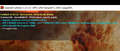

    Hello Friends,
    I'm puzzled about this laptop.. It has a dedicated Nvidia 820m GPU and BSoD's
    randomly. The GPU works fine with 3D Mark and FurMark. Memtest reported no
    issues and the CPU is fine. So far so good.

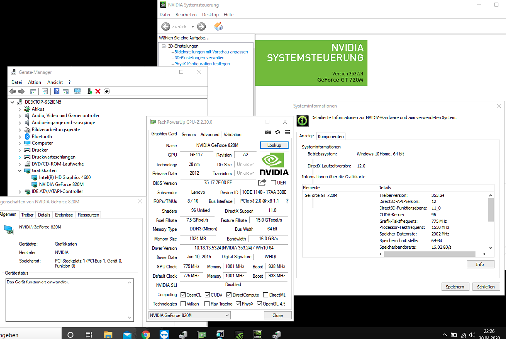

    Now the weird part begins:
    Furmark reports the GPU as a GT710m. GPU-Z as 820m and the Nvidia Control
    Panel sometimes as 820m and sometimes as 720m. I can't install the official
    drivers from nvidia for either the 720m or 820m. It always says that the installer
    can't find a compatible GPU. But Windows installs the 820m drivers by itself.
    When running 3D Mark or Furmark no BSoD's appear. But it instantly crashes
    when closing the internal "benchmark" in GPU-Z with
    VIDEO_SCHEDULER_INTERAL_ERROR. This typically tells me that the GPU is
    dying. But no other Benchmark causes issues, even when running it for hours.
    One thing I noticed: When stressing the CPU it thermal throttles to around
    0.8GHz after some time. The frequency does not normalize after that, even when
    the CPU sits at 50C. It just stays at 0.8GHz. Restarting the Laptop has no effect
    either. Only completely shutting it down once restores the normal clocks.
    I'm confused to hell... Did someone experience this behavior?
    Screenshots were taken via TeamViewer. I don't have physical access to it at the
    moment but I can do remote tests.
    Sidenote: I analyzed the minidumps of all crashes and it was never caused by the
    Nvidia driver. Always something random kernel or windows related. Only when
    forcing it to crash via the GPU-Z benchmark it fails with the usual nvxxxxx.sys file.

    Re: Lenovo G710 Very weird GPU issue
    Entry-level GPU are often the exact same GPU rebranded over several generations so it's not surprising to see different names. Here GPU is GF117 and apparently it can be 620M/625M/630M/710M/720M/810M/820M. The official NVidia driver package for any of those should still install properly.
    Maybe you have a power related issue rather than GPU issue itself.
      Thats pretty stupid but hey Nvidia isn't known for logical product names, right?
      Anyways.. I'd also imagine that it is a power issue. But why doesn't it crash when everything is under stress? Temps are also irrelevant. Sometimes it crashes instantly after powering on and sometimes after hours.
                I googled for curiousity and it appears the discrepancy between 820m and 710m being reported is normal - you can find any number of screenshots of furmark showing the same thing for other people.
