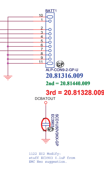

        • piernov
          • Jan 2016
          • 4439
          • France
          Re: DELL Vorstro 3550 Battery not detected
          First make sure there's no physical damage near battery connector.
          Measure voltage on SMBUS data and clock lines on the battery connector with and without battery connected.
          And measure diode mode on the same lines with all power disconnected.

            • piernov
              • Jan 2016
              • 4439
              • France
              Pull out the schematics, find battery connector and you'll see which pins are concerned.
              • Conste
                • Oct 2018
                • 235
                Okay, I hope the schematic is right...see picture for designation
                w/o battery
                1 2,76
                2 =1
                3 3,36 SMBCLK
                4 3,36 SMBDAT
                5 3,33 BAT_PRES
                6 ground
                7 0
                8 ground
                9 ground
                w battery
                1 9,57
                2 9,58
                3 3,32 SMBCLK
                4 3,3 SMBDAT
                5 0 BAT_PRES
                6 ground
                7 0
                8 ground
                9 ground
                So I think SMBus communictation is working?
