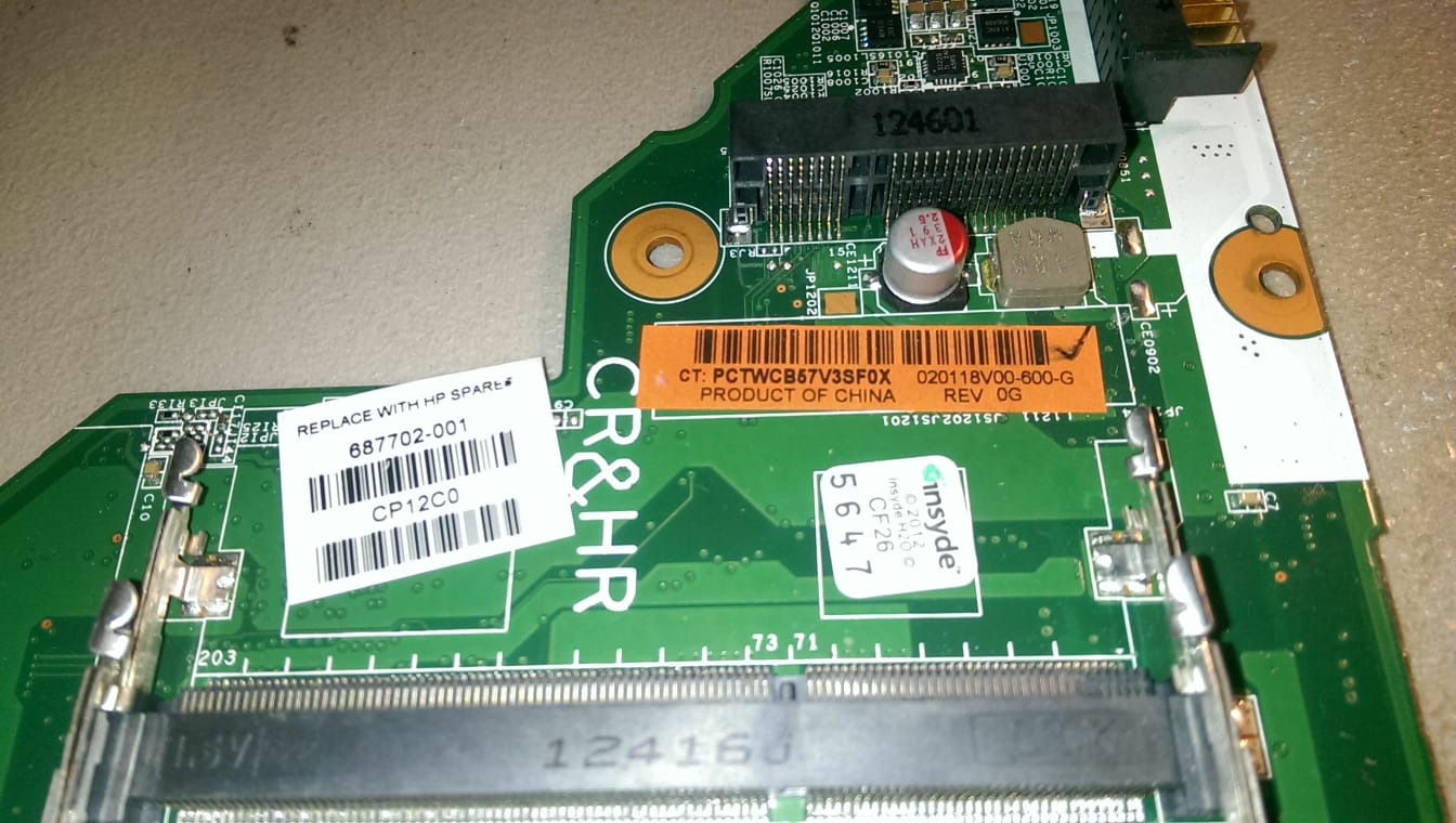

HP 650 1858-100 need info R1104 smd resistor code
  • Japanac
    • Aug 2014
    • 95
    • Serbia
    HP 650 1858-100 need info R1104 smd resistor code,the resistor is burned so no mark is visible.
  • classicandy
    • Apr 2018
    • 309
    • Nigeria
    Re: HP 650 1858-100 need info R1104 smd resistor code
    Hi, I suspect its 2R2 that is written on it. 2R2= 2.2 ohms.
    The board I have with me currently is HP 655, but at that similar area, it is 2R2 on it.
      Yes it is 2R2
