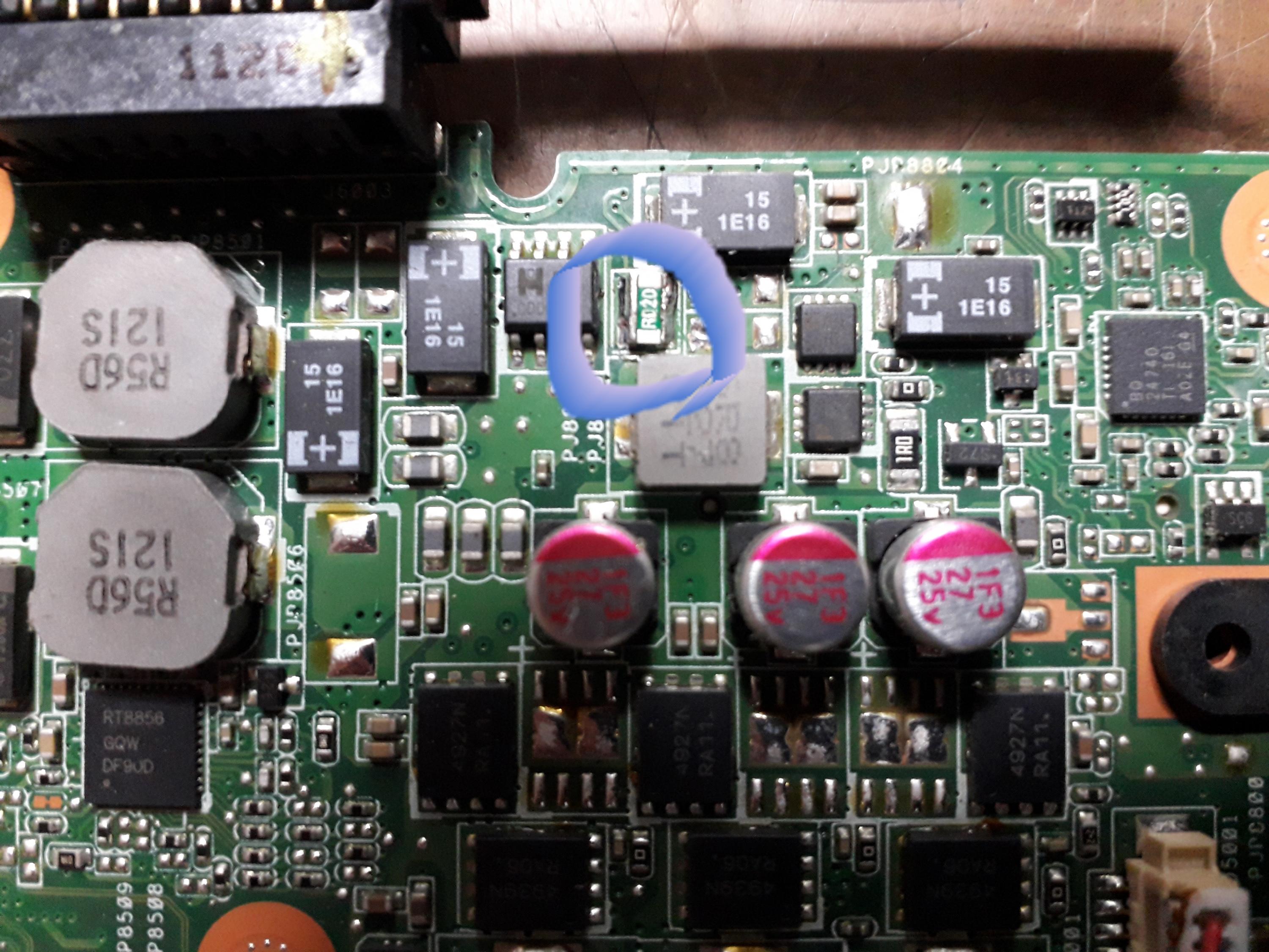

    Hi everyone, I have a question to solve on an asus k53s laptop (motherboard k53sv rev 3), in essence I have about 14.4 v on the battery connector, after about 5 minutes that it is charging (measured with battery inserted). Are 14.4v normal or exaggerated? I state that I opened the PC because it did not charge the battery, I found a burnt resistance of 0.020 ohm that connected with the battery connector and which I assume is part of the charging circuit. The IC of the circuit is the BQ24740. I can't find the PC service manual. Now I wonder how can the correct functioning of the charging circuit be verified and also without battery? It's possible? Another detail that I noticed is that the charge indicator LED is always orange and never green and then goes off after about 30 minutes, every now and then it flashes briefly and after 1 hour it switches off completely; the voltage measured on the battery is 12.19 volts. The charge indicator icon says to replace the battery. I apologize for taking a little longer. I attach the photo of the circuit where I replaced the resistance. Thank you !
    Ps: I'm afraid to put a new battery, I wouldn't want to ruin it!

    That Resistor is not burned it’s a CLR current limited Resistor that is not your problem what is the Voltage you get in Battery connector all pins with battery with out Battery
      Re: asus k53s (motherboard k53sv rev 3)
      Hi techtiger, thanks for the prompt reply, then, first of all, the limiting resistor was burnt and I replaced it; without battery pack I have no voltage, with battery pack, the voltage varies from a minimum of 12v to 14.5v and at that point also stops the charge of the pc but the battery does not fully charge. the question I ask myself is this: is it normal for the voltage to rise to that value? shouldn't it be limited to 12.6v? another detail is that the charging indicator goes impulsively, that is, it turns on and off, it does not always stay on, consequently the LED is on, there is voltage, the LED is off, there is the residual battery voltage (about 30% of the total voltage). thanks again and good day.

            If you can not find schematics - just use commonly accessible datasheet for charger
            This resistor serves for current sensing of either current cunsumption by whole laptop, either for battery charging/discharging only (there are two separate).
            Which way resistor was burnt - actually, it had infinite resistance? In this case breackage of this current sensing resistors causes loss of charger's functionality.
            Sometimes it can go further on...

              hi Kropotkin, what that resistor is for is known; I don't know how it burned. The resistance had infinite value, therefore completely open;
                Hi! If it was originally of black color, not green which is on photo now, than those black ones tempt to mecanically loose the contactof solderingto their top along one of sides. Meet such defects few times on Asus and Samsung boards.
                If you know for what this resistor serves - you can imagine that upon breakage of it all the voltage of battery/adaptor will be applied to current-measuring inputs of charger. Consequencess may be different, one photo in preview post - is Asus1215b where such black schunt due to bad contact killed newly installed charger IC in already assembled device. Later on when I met such situation I've studied it under microscope - it do was the case

                  I have few such bords, they have green resistor, probably it is not the case. Any case, "aximum difference voltage ACP–ACN, SRP–SRN, AGND–PGND –0.5 to 0.5V" - says TI datasheet. Hardly it stay alive

                      I can not clearly understand which kind of problem do you have at the moment. Use AIDA software, there you can see some numbers of power, measured with charger for accu charging rate and battary state. Give them to us.
                      My suggestion - if something is wrong with indication/charging - you will deal with partially defective bq24740 in you case, as it "eated" some voltages ~100 times higher than it shoul accept at current-measuring inputs. You have possibility to try to replace it?
