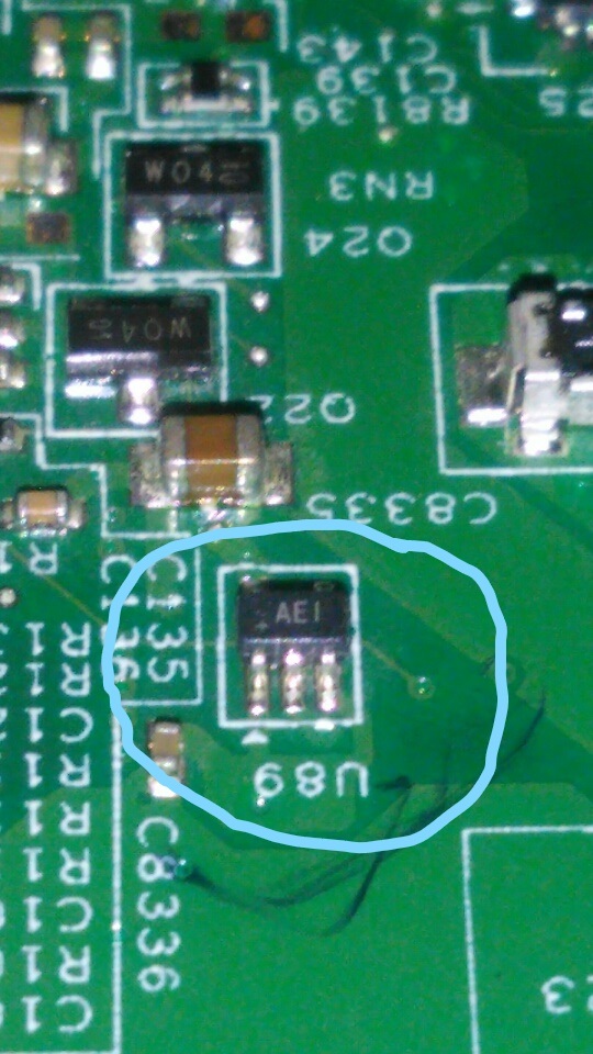

Help identify chip marking code AEI from Dell E5500

    Hi guys i need to identify this chip SOT23-5 marked AEI from a mainboard Dell LATITUDE E5500(i dont have schematics). Many thanks in advance guys!

    Re: Help identify chip marking code AEI from Dell E5500
    MAX8511EXK33
      Originally posted by SMDFlea
      Thank you!
