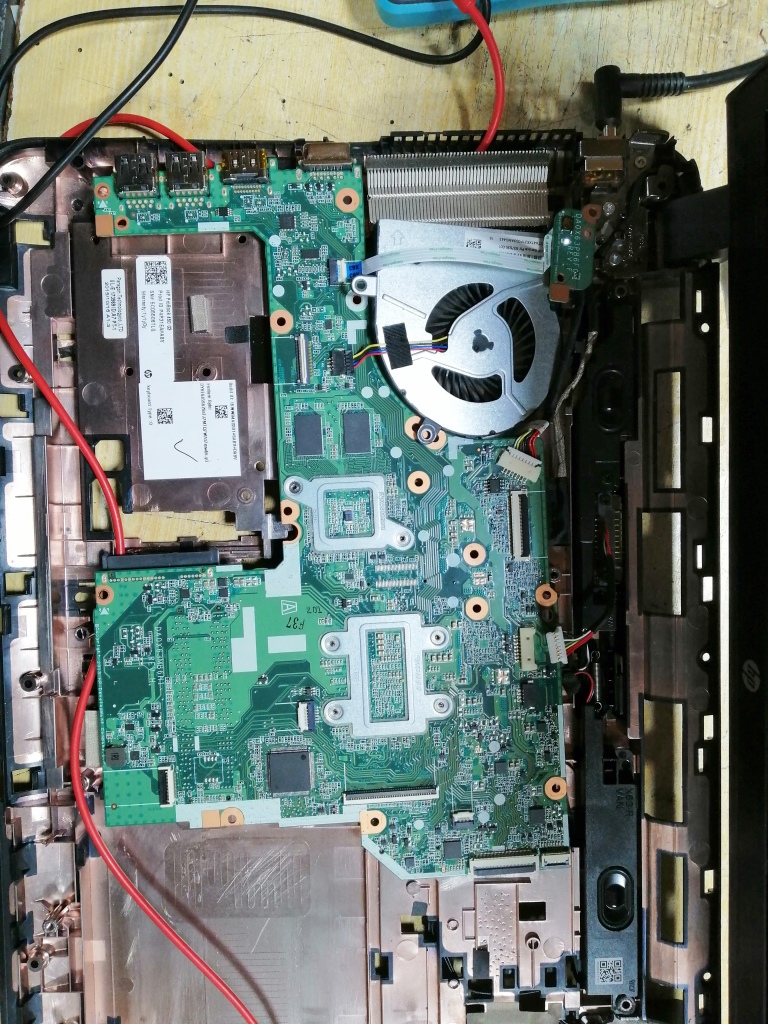

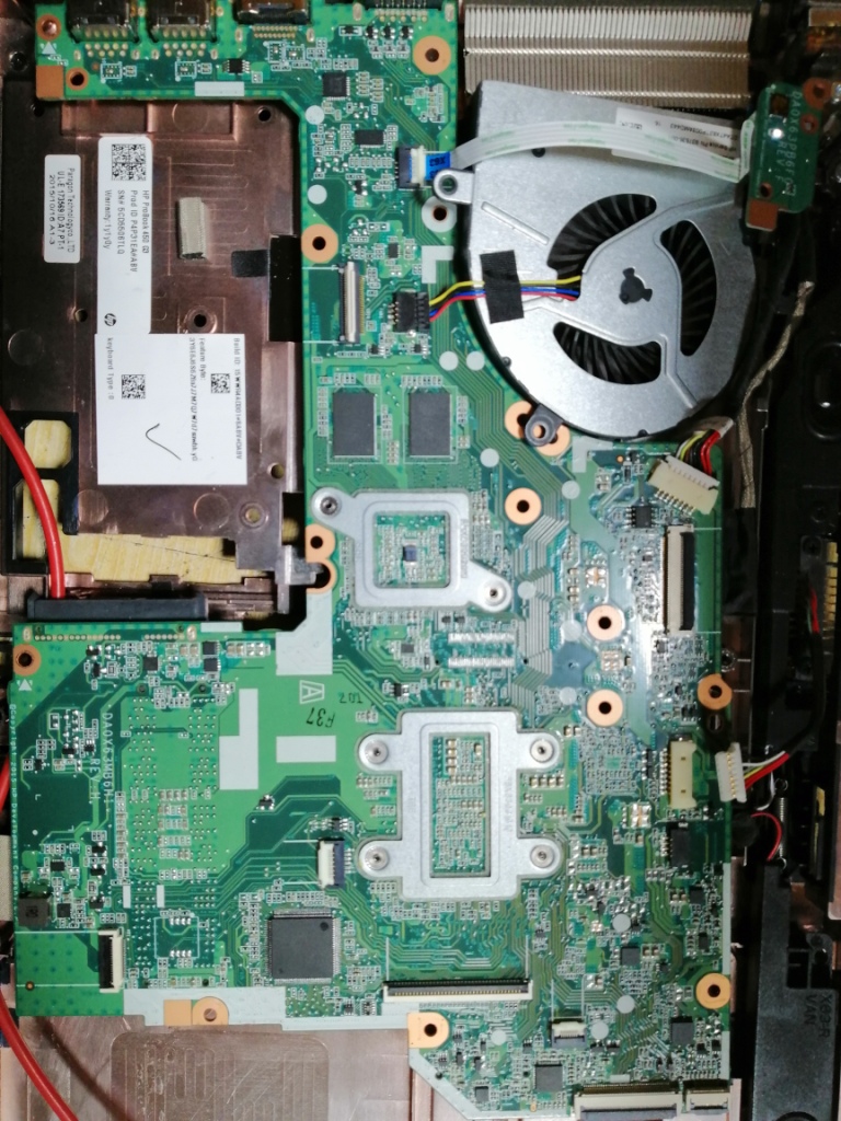

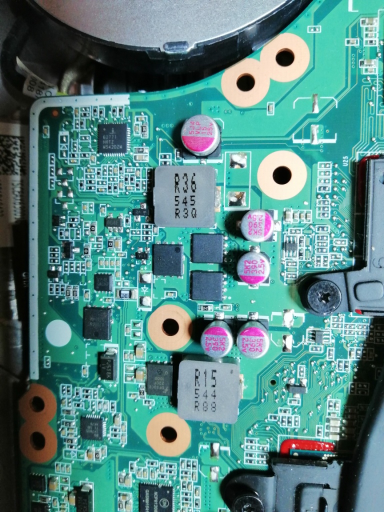

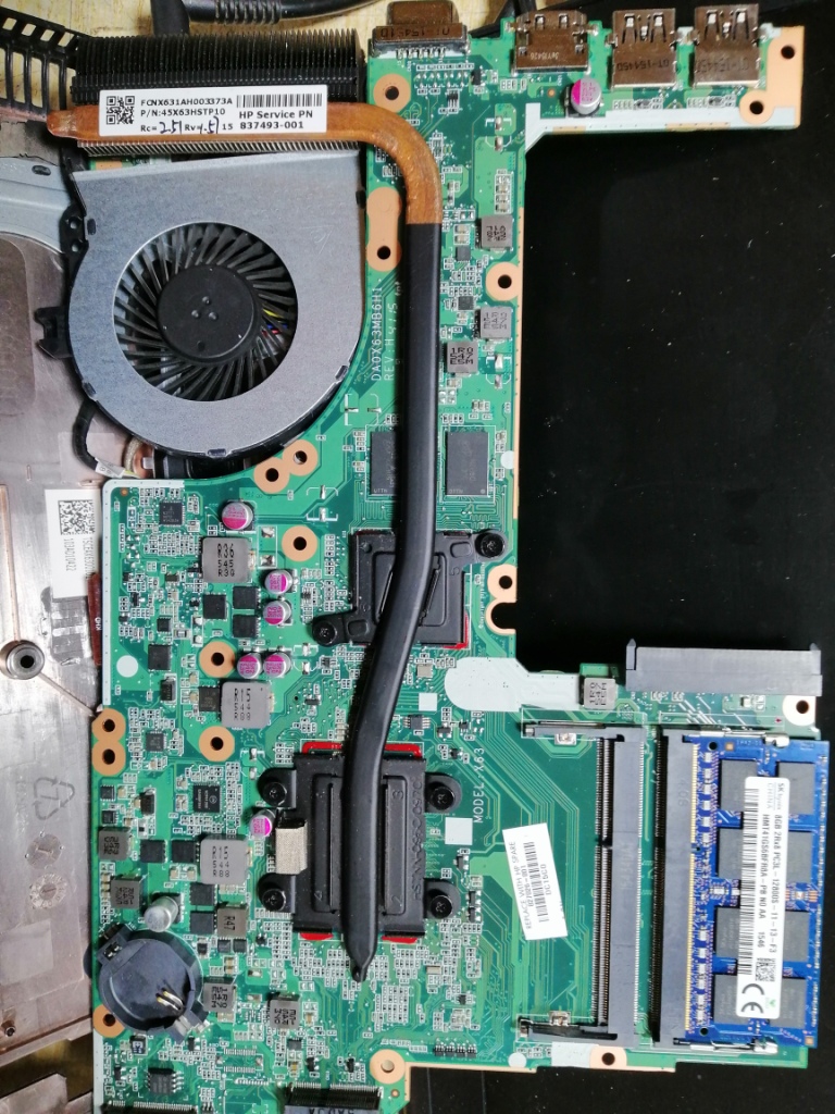

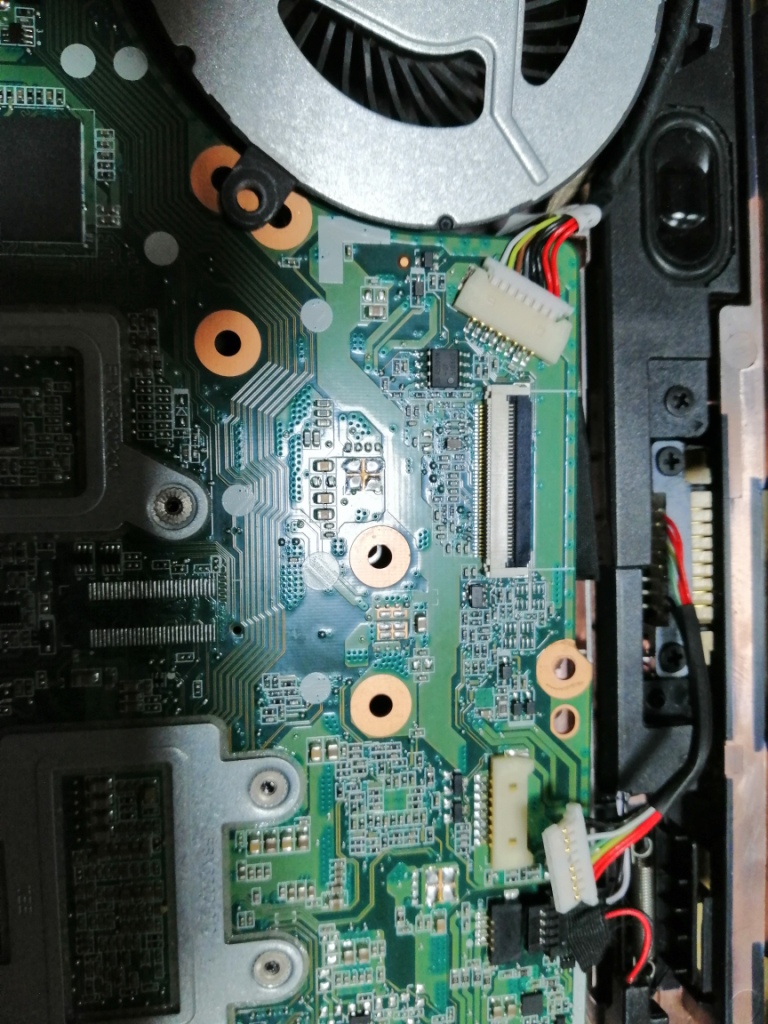

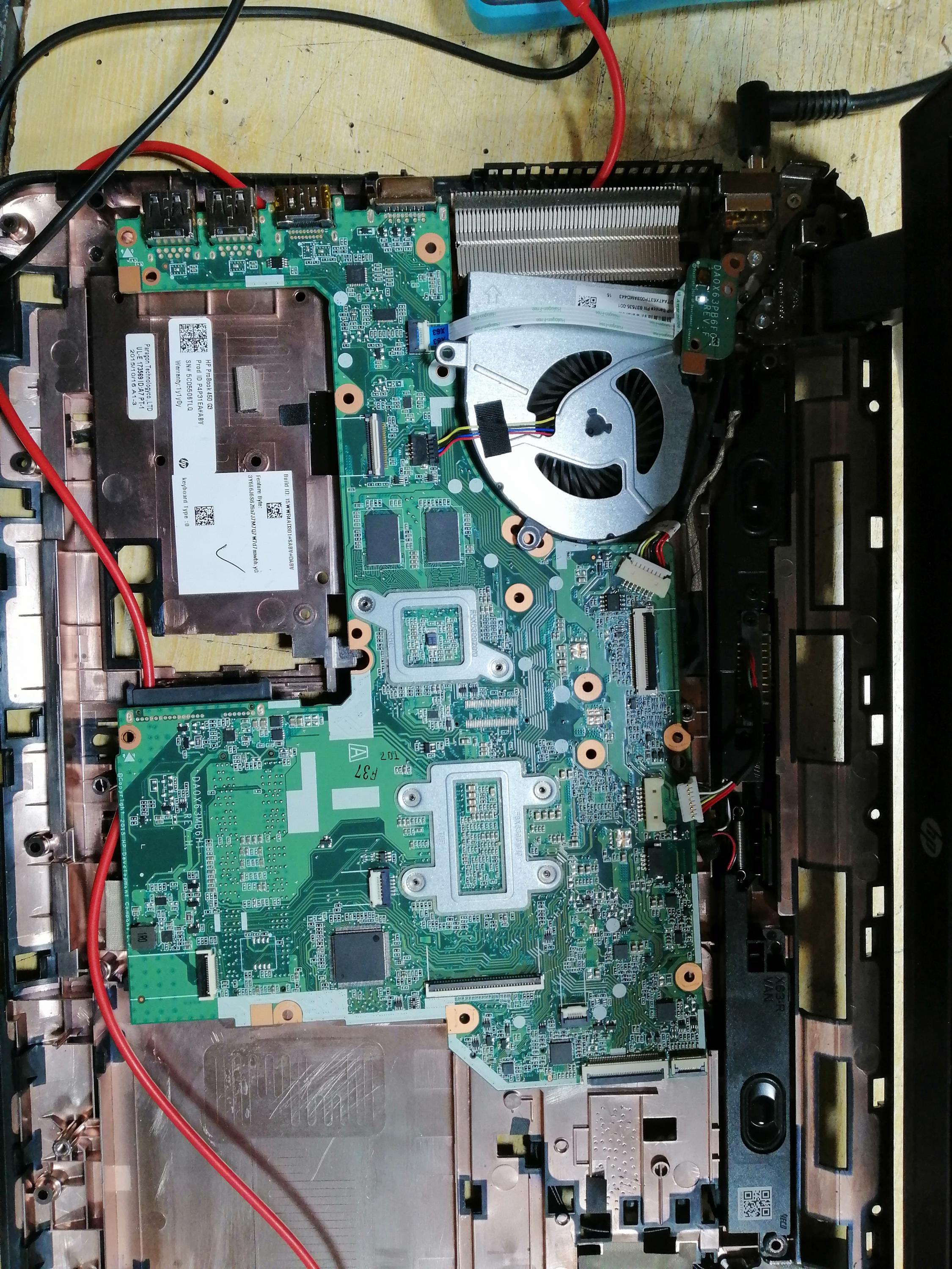

    hi
    the problem is:
    there is only 5v present in the board, and the laptop is dead with power button led is on whenever i plug the AC, there is no 3v, even it cannot charge, no volts on the battery terminals
    • 21278
    Re: DA0X63MB6H1 RevH Quanta X63
    Schematic at post 3 https://www.badcaps.net/forum/showthread.php?t=66905
    check PU25 +3V_ALW
    • mazloum
      • Sep 2012
      • 499
      • Lebanon
      check PU25 +3V_ALW
      on PU5 (as393m) on pin 2 instead of +3v i found only 1.1v
      i also cannot find pu25 which is on the schematic= RT6575ag, i also have ddr3 not ddr4
        • 21278
        i think thats the only schematic available. You need to find the IC that generates LDO 5V and 3V
        • mazloum
          • Sep 2012
          • 499
          • Lebanon
          on pin 1 of the power button, the volt is 3.3v, and led is always on
            • 21278
            Do you have the same BQ24780S controller as in the schematic on page 52
            • mazloum
              • Sep 2012
              • 499
              • Lebanon
              yes
                • 21278
                Check the voltage on pins 5,6,27 with the AC and battery atatched.
                https://cdn.badcaps-static.com/pdfs/...2a8abce3d9.pdf
                • mazloum
                  • Sep 2012
                  • 499
                  • Lebanon
                  all are zero volts
                    • 21278
                    Measure the voltage and resistance to GND on +VA_AC and +VA
                    • mazloum
                      • Sep 2012
                      • 499
                      • Lebanon
                      i cannot find +va and +va_ac in bq24780S
