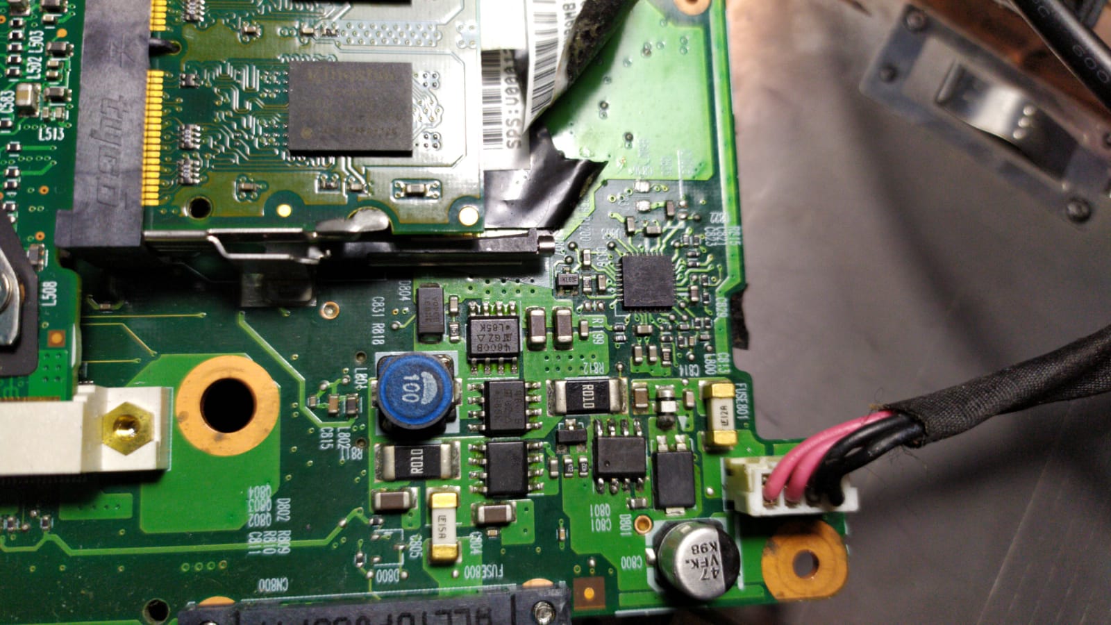

    hello companions this portable A-300 has arrived without ignition, when I open it I find that q801 that in its pins 1,2 and 3 measure me 20v and in pin 4 its gate also measures me 20v which I think it should not be and in pins 5,6,7 and 8 0v so there is no voltage over there. I changed the mosfet in case it was malfunctioning but still the same
    Looking over I see nothing burned, I doubt the IC U803; I have measured pin 12 VDC and the 20v enter, pin 3 and 4 and pin 24 00.6.
    I think it's not working well.
    I pass the scheme of the plate that is pt10g 6050a2171501 mb a03

    Resistance to ground on +VBAT?

      The 1st Fet P channel Gate should be less than 10V Check the voltage on ACDRV pin 2 U803

          el pin ACDRV 2 U803 da 20v lo mismo que en pin4 deQ801 al estar comunicado.
          en fuente allways no tengo ni 3v ni5v ya que no pasa el voltaje del principio y no tengo voltaje en el resto de la placa.

                is this +VBAT resistance?? If so your +19V rail is shorted.

                    Well I checked by removing Q801 and I connected it by measuring pin4 the gate and it still gives me 19v so U803 ic BQ24721C is wrong.

                        please dont judge anything when u cannot understand function of BQ
                        read datasheet of it
                        what is ACDET, VCC, ACDRV#, VREF5, CHGEN# voltages?

                          I pass the measures:
                          pin 5 ACDET 00,9v
                          pin12 VDC 20v
                          pin 2 ACDRV # 20v
                          pin11 VREFS 0v
                          pin 1 CHGEN # 00,1v

                            as first u see in datasheet
                            https://cdn.badcaps-static.com/pdfs/...0f5cb1cd24.pdf
                            , u dont have ACDET signal, which detects power adapter
                            next u dont have VREF5

                                measure ACDET circuit. R814 awith R815 works as voltage divider
                                u have whole schematic and datasheet. try to figure it out
