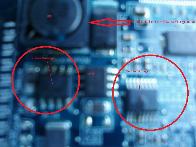

              I have an interesting one now, an Acer aspire. It powers on by itself but displays no video. Reflowed GPU - no effect. Pressed slightly on Max8760. Afterwards, board would beep one time each second. Strange beeping sound, almost like a blinker in a car - and I was unable to determine where it was coming from. Reflowing 8760 stopped beeping, but still no video. The 8760 is the dc-dc for the CPU, and the cpu is cold when power is applied. NB & GPU get warm, but not CPU. Could this mean that the 8760 is bad? I ordered some samples just in case. I checked the resistance from the inductors like you said previously, nothing below 20 ohms. No visible damage and no obvious shorts (checked caps).

                I had Aspire 1360 in service. Power on but nothing, no HDD or fan spin. Cpu voltage sits at 1.00V.
                If it is a harsh sound, like you hear hammer knocking on some metal, I would guess upper mosfet is defective. But that is only a guess. However, you do know that sound once you hear it.
                If it is tick-tick-tick, that is the overcurrent protection kicking in.
                Probably there is a bad contact somewhere near it. How's with the voltages ?

                      This one looks a little harder than I thought. I can read that one good mosfet is 4704 - the other is too damaged to read, but from what I can read, it doesn't match up to the 4704, so I think it is something else. I have no idea what the 16 pin chip is, but it appears to be damaged as well. I have measured zero resistance from the inductor visible in the picture to ground, and all of the small caps mounted on the PCB on the opposite side of the CPU are shorted.

                        Can you make out even a few letters ?
                        Otherwise, unsolder everything burned. Both mosfets, burned chip and try to 'boot'.
                        Do Mosfet traces lead to this IC ?
                        It might be a battery charger controller IC.

                          New information:
                          I was lucky enough to have another one of the same model come in, with a power jack issue. I took a close look. It looks the same, except that the 4704 isn't a 4704 but instead a 6690AS. The other 8 pin mosfet is a 4800B and the 16 leg chip is a 68CAZ (G801FG). I wonder if I can replace the two chips on the bad board with the same chips I read off of the intact board. I'm concerned that because the other Satellite P205 used a 6690AS instead of a 4704, that the other two chips may be different as well. I believe that a 4704 is a P channel and that the 6690AS is N-Channel, I'm looking for verification on that right now.

                            It is better to verify it twice.

                              I removed the first burnt 8 pin mosfet. I can't read what type it is, but the top of it says ph7sd.

                                Based on some information that I have collected, the unidentified 16 pin chip is a PWM controller manufactured by Intersil. That might explain why all the caps on the PCB opposite the CPU are showing shorted (with no power applied, of course). I wouldn't be surprised if the CPU itself is bad, but that's no big deal. The problem now is that I need to find another PWM controller, or this will never boot up again.
