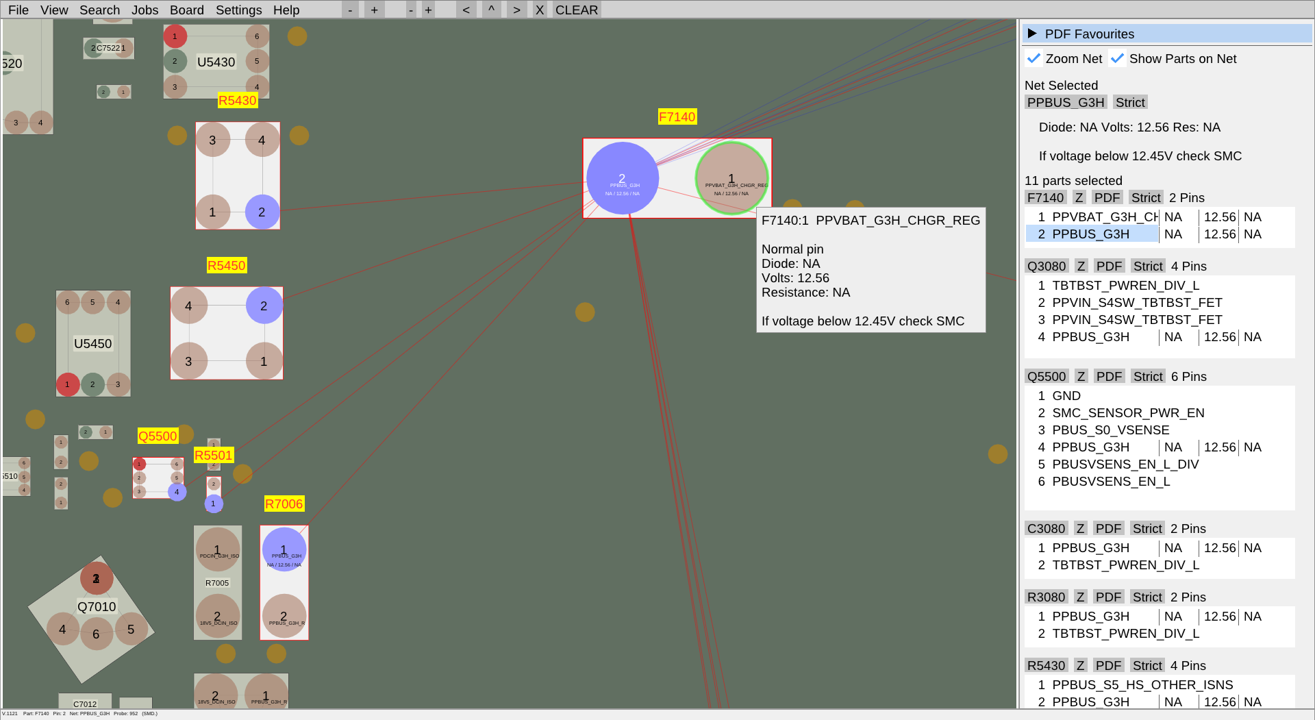

    I've started a new open project to try collate together all the data that people usually generate when repairing boards, things like pin/network diode, voltage, and resistance measurements, as well as small notes about the specific data.
    ie, on Macbooks, 820-00165, PPBUS_G3H needs to typically be 8.6V, and if it's lower, then usually you have to look around the SMC area.
    The project is available at - https://github.com/inflex/OpenBoardData
    Very early days yet but it'll hopefully grow in to a considerable resource over time.
    As yet, FlexBV is the only program that's working with the data, but soon OpenBoardView will as well.
    If we get the data in to the open like this, then we can avoid being locked in to specific programs going in to the future.
    The data is MIT licenced, so it doesn't prevent commercial suites making use of it either.

                Say you have boardview program XYZ, it loads up an ASUS FZ file for some motherboard ABC123, that's fine, you can see the pins/nets/parts, but there's no data for the readings to expect on those.
                Now, someone writes the expected values for the nets for the ASUS ABC123, and one of the nets is NET_BIGPOWER, its values are 0.5V diode, 12V running, and 40R resistance; OpenBoardData will have a file perhaps called ./desktops/asus/abc123.txt, in it will contain a line;
                NET_BIGPOWER 0.5 12.0 40 If Voltage below 11V, dead CPU
                Now, that gets compiled in to the OBData.txt file and shows up as;
                ABC123 NET_BIGPOWER 0.5 12.0 40 If Voltage below 11V, dead CPU
                Now, if a boardview program chooses to use this data (PB, Landrex, OBV, FBV, BoardView etc), they can just search the OBData.txt file for that net on that board, and overlay that data on the pin.
                Some other programs do have their own diagnostics data overlays (ZXW/PB), but that data is what ever they've created themselves and it isn't open to other people to contribute or use on other programs. At least with OpenBoardData the community will have a legally open resource that isn't tied to any specific program.
                Will it help FlexBV and OpenBoardView, of course, but then at least it's a resource that other programs can use if they want too and it's the only resource that's open source and as a bonus, under the MIT licence.

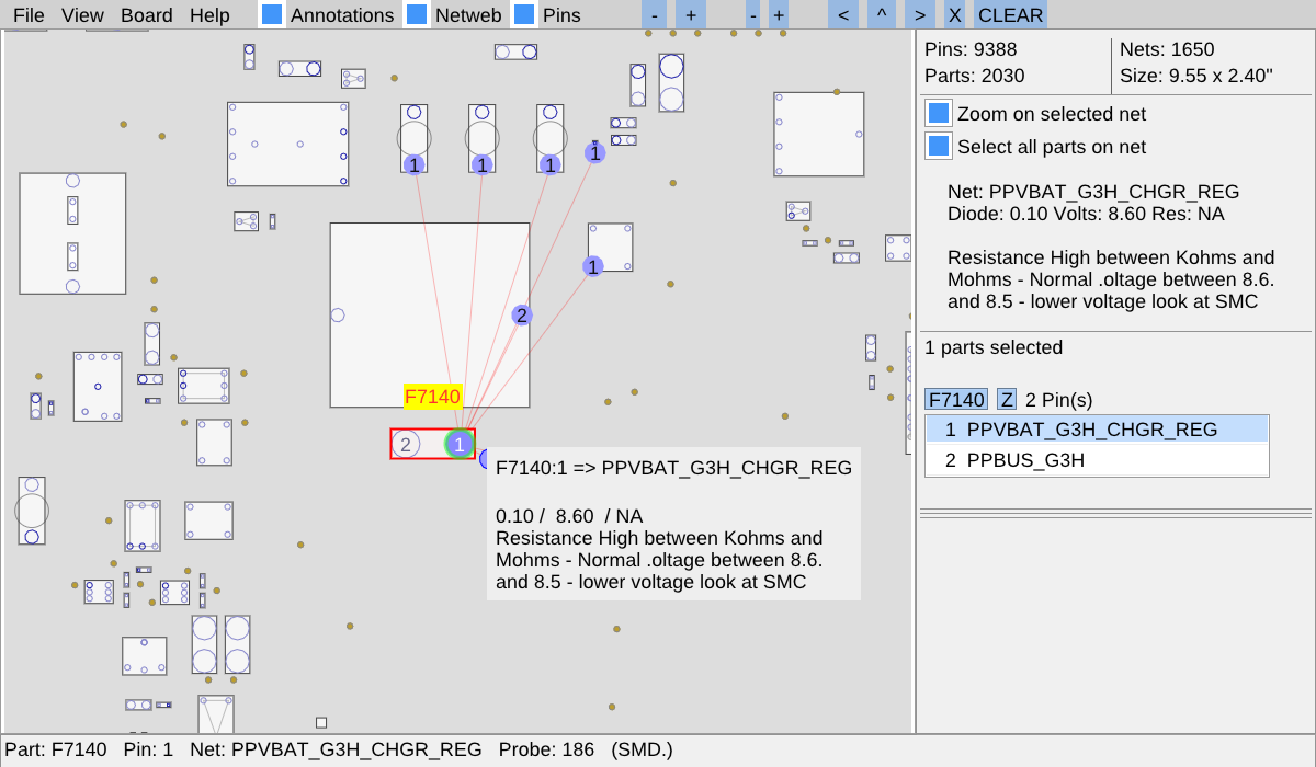

                                First public build for windows for OpenBoardView + OpenBoardData interface added;
                                https://github.com/inflex/OpenBoardV...s/tag/10.1-RC2

                                  • sadfsdaasdfasd
                                    • Mar 2020
                                    • afghanistan
                                    Re: OpenBoardData Project - Making the diagnostics measurements open for repairs
                                    How can i use OpenBoardview with openboarddata? It gives me a error when i open the exe from github. I am using Windows.
