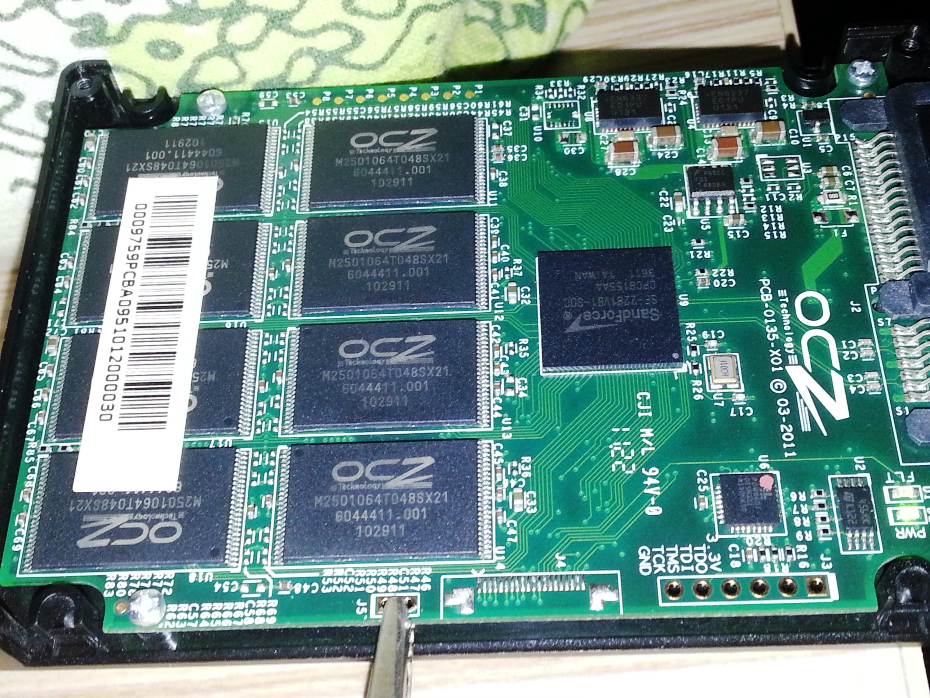

    Good day folks. Pretty pointless weekend project overall here: a workmate gave me a junk 120GB OCZ SSD he had at home which no longer works. After a bit of digging, I learned these were notorious for firmware bugs and would die often and I reckon this one is no exception. I found a few resources about how to resurrect them, just for fun, but unfortunately they're all for the Vertex 2, whereas mine is a Vertex 3 for which I cannot find a damn thing...
    THIS here is a good resource and gets pretty close to what I'm trying to achieve, but again: everything provided is for the Vertex 2...I decided to press on anyway, to the point where I made that bootable MTP USB flash drive and am able to boot into it, the SSD with its "service jumper" shorted got detected, but that's as far as I could make it because the firmware doesn't match, which should come as no surprise, since the controllers are different: the V.2 uses a SF1222, whereas the V3 has a SF2281.
    On top of that, it uses some bullshit proprietary NANDs which of course nobody's heard of, though I was able to find a russian article here who got even closer, since he also got the controller right and I was ready to go for it again, but then found my NANDs are different ! It involves a MASSIVE amount of work, getting Fedora going, installing sh!t and working with command prompts and going through all sorts of lists and IDs and stuff....DAMN! I didn't push on with this second guy only to find my NANDs don't match, so I stopped for now...
    I doubt there's anything we can do with this thing in its current state: no firmware and no resources = unless someone comes up with a brainy idea....again, it's just for fun, there's no data on it, it's an old nasty thing....no hard feelings in the long run

    Not a lot of progress here...
    I still pushed on with the second article, with the ultimate goal of attempting to force the reflash by choosing the closest specifications to my NANDs as possible, despite the chips not being anywhere on that list. I had to throw in the towel though because the firmware file I managed to obtain simply wouldn't open in that SF Manager utility - it had the wrong extension for some reason and I could not find a .dfp package the software expects...all chinese sites required me to log in, which is not something I'm willing to do for this thing, since it's overstayed its welcome for sure, plus I'm not sure it's possible to force a controller to use a different type of flash NANDs than the ones it's got on board, despite their count and size being the same.....there's just too many variables and unknowns here.....
