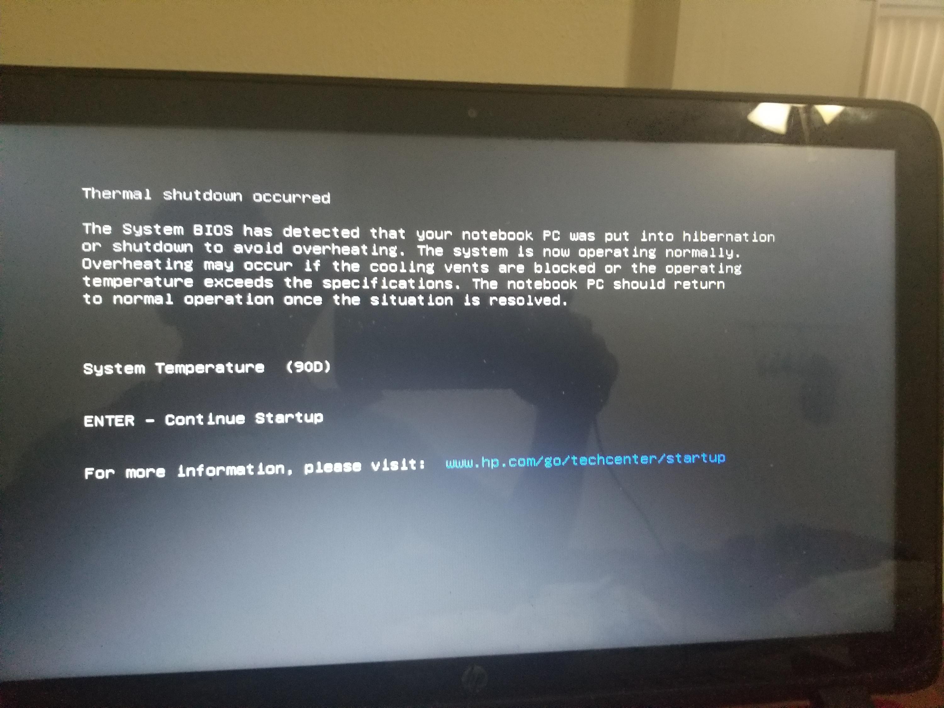

    The Laptop shutdown randomly. Sometimes in few seconds as soon as you start and at then there are occasion when it works fine for an hour and then shuts down.So there is no fixed time ..it can few seconds, few mintutes of few hours. Most the of the time it shutsdown within a minute ..even in BIOS menu.
    Model Name : HP Pavilion Notebook - 15-ab029tx
    What does these symptoms point to ??

                      hp probook 450 g0 thermal shutdown occurred problem solution help
                      Change fan but not solved

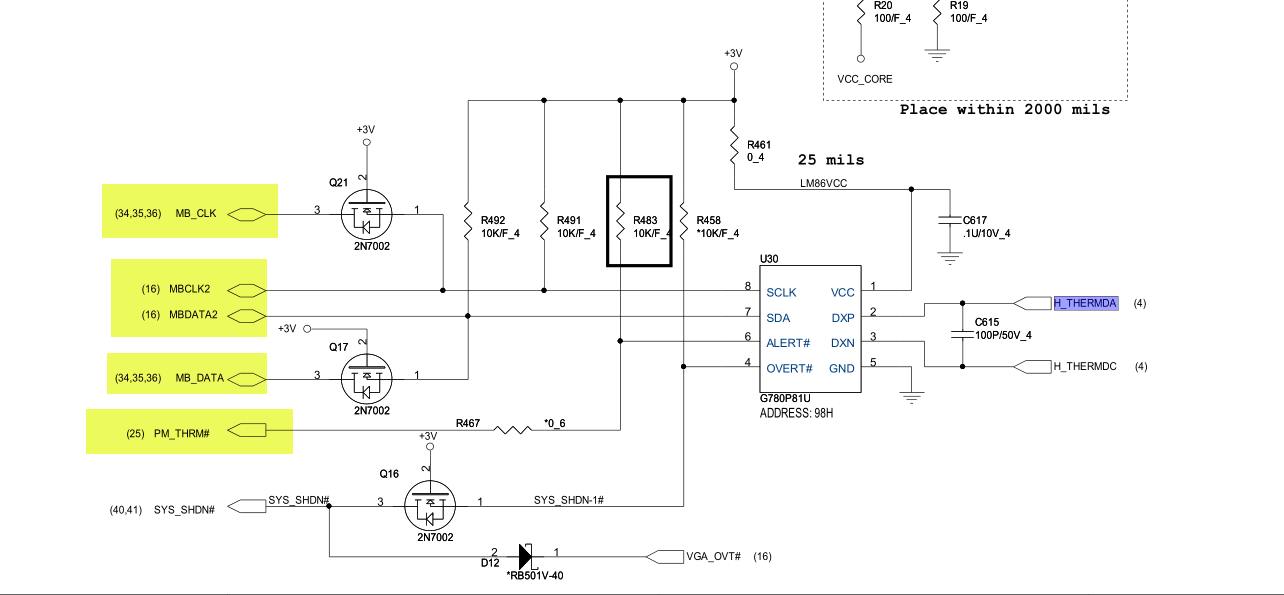

                        Mb marking?? It has to do with thermal protection of SIO.
                        • mon2
                          • Dec 2019
                          • 14086
                          Re: Random Shutdown - HP laptop
                          Review the voltage readings to ground from the thermal sensor.
                          What is the voltage to ground for PM_THRM# pin ? If this voltage is LOW, then this sensor is alerting the logic board that the temp is too high so shut it down.
                          Meter in DC volts mode -> red probe to PM_THRM#. Black probe to ground.
