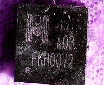

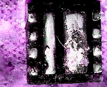

    help identifying chip off LA-E801P
    Hello, this chip is overheating when the power button is pressed. I do not have the schematic. It has a stylized H with letters A03 then FKH0072 underneath.
  • mcplslg123
    • Jun 2015
    • 7262
    • india
    Re: help identifying chip off LA-E801P
    seems like a mosfet
    • on/off
      • Oct 2016
      • 333
      • Indonesia
      You must clean the surface of the chip so you can read the sculpture clearly.
      Rub the surface of the chip with the help of thermal grease or cigarette ash, it will help read the mark.
      It is very important to determine whether the mark shows the type of P-Channel / N-Channel or Dual-Channels mosfet.
      the picture looks like a product of Excelliance MOS
      example: EMB20N03V
      • Mazorca
        • Jan 2017
        • 463
        Thank you for your answers. On the board, it is marked as PQ302. I'm doing the thermal paste rub now, no smokers here, good tips.

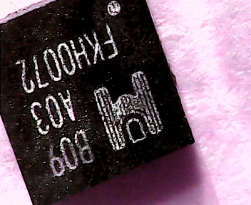

          Added new pic, rubbed white thermal paste, then a drop of alcohol. Website of excellencemos keeps timing out, can't get in.
          • R_J
            • Jun 2012
            • 9600
            Seems to be a: emb09a03hp
            • Mazorca
              • Jan 2017
              • 463
              My usual suppliers, digikey and mouser electronics, do not carry that manufacturer. Compatible replacement? in same package, EDFN5*6
              Thank you RJ for the datasheet.
