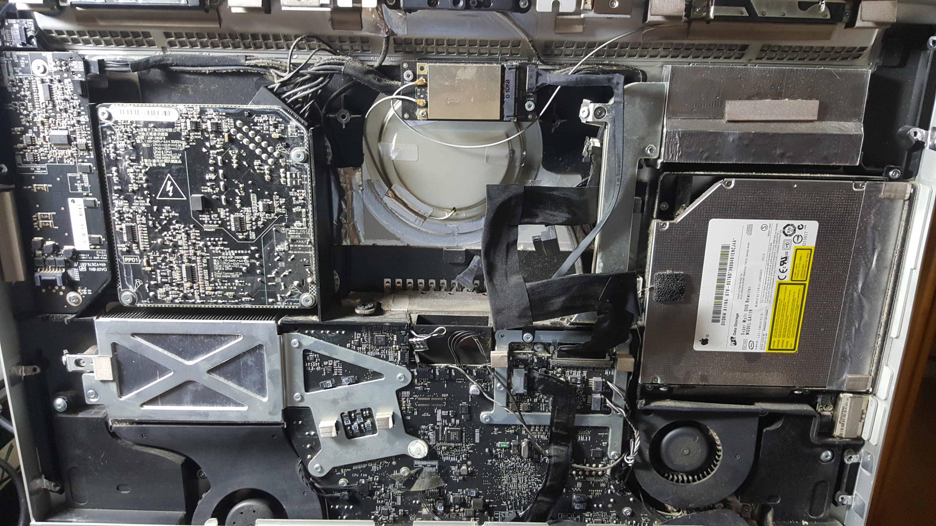

    When I push the power button I hear the sound but the screen remain black,
    only after a few attempts , the screen turns on.
    (The HD seems to work even when the screen remains black, and when the lcd is on the pc work well for many hours)

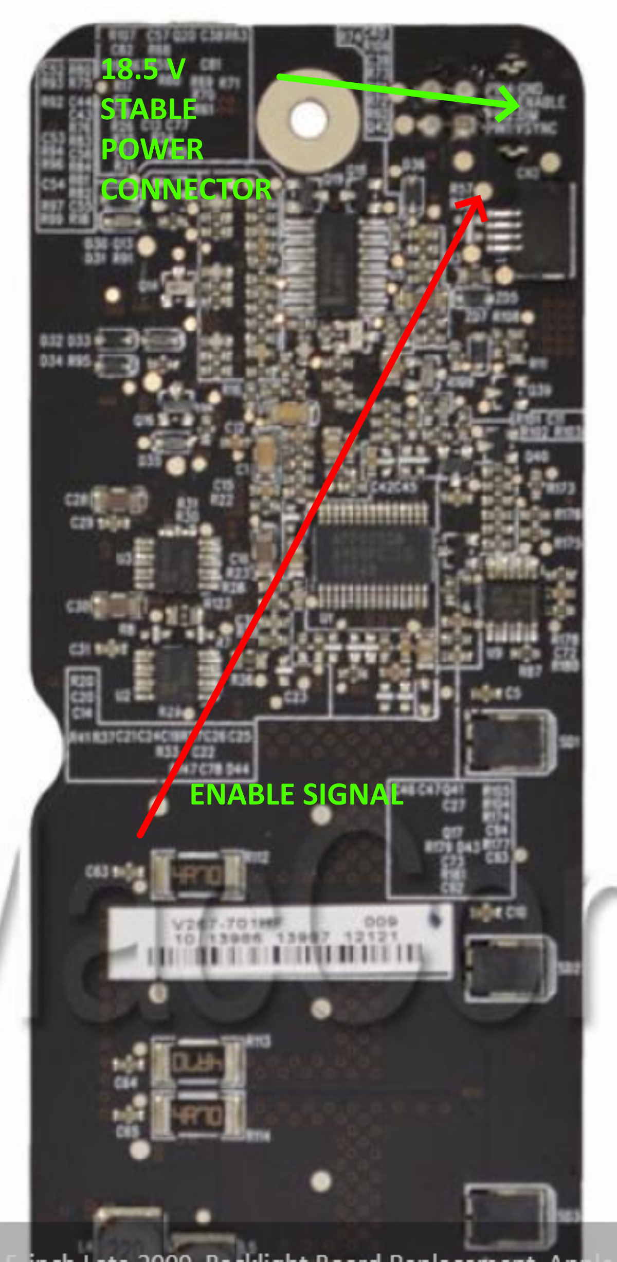

    I noticed that on the card that manages the voltage for the lamps (darfon 4h + v2676.081) there is a connector with this signal:
    pin 4 GND
    pin 3 ENABLE
    pin 2 DIM
    pin 1 VSYNC
    Enable signal is missing when the screen is Black and have 1.6V
    when the screen is on.
    I have no schematic and I don't understand well this type of hardware and I want to know if the enable is an OUT or IN signal ?

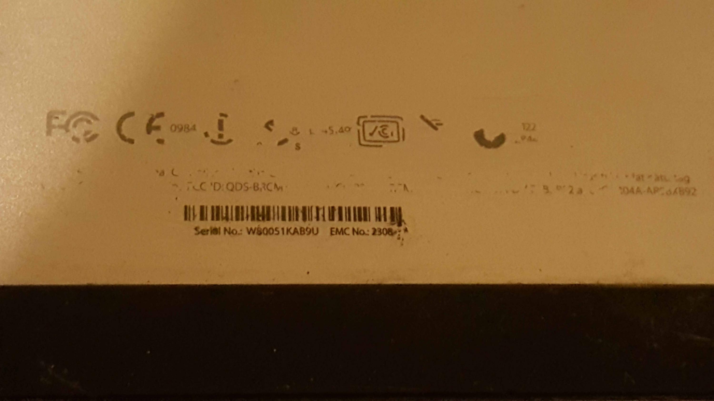

        Originally posted by piernov
        Would be nice to know what machine it is…
        Label is missing but I think the model is Apple iMac 21.5 A1311
        The pic is a similar inverter board
        I post original pic as soon as possible
