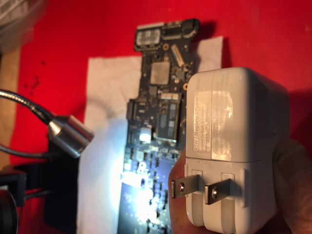

        Re: Macbook Air 820-00165 Not turning on
        Check all your power rails again.
        And make sure you use a *genuine* Magsafe 2 (no 1→2 adapter).
        • Merc
          • Jan 2015
          • 18
          Yes I believe it is genuine Magsafe 2. No adapter.
            Here is charger.

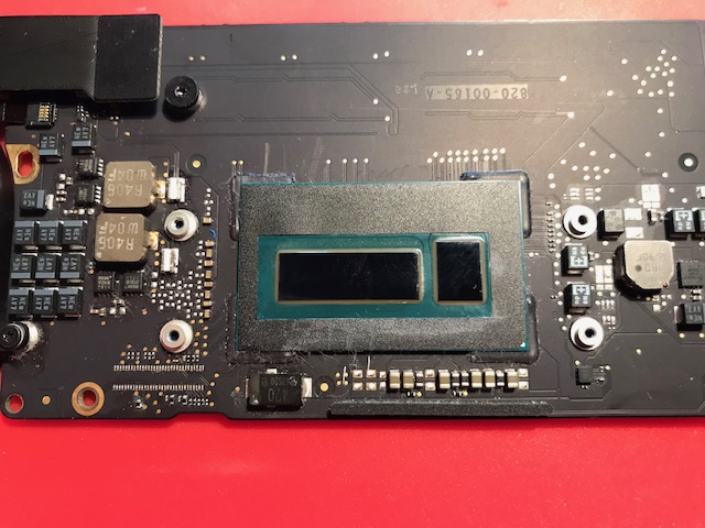

                  • Merc
                    • Jan 2015
                    • 18
                    CPU area. Paste was silver and looked fresh.
                    • rediii
                      h???, spurrrn
                      • Mar 2018
                      • 487
                      • somewhere in europe
                      Originally posted by Merc
                      PM_SLP_SUS_L = 3.32V
                      PM_SLP_S5_L = 0.75V
                      PM_SLP_S4_L = 0.93V
                      Taking heatsink off of CPU...
                      sounds like a rabbit hole, inspect the board again (hope u didn't clean it), maybe u can find something really suspicious
                      • KvnTM
                        • May 2018
                        • 434
                        Resistor below the jtag connector on the bottom left looks a bit dodgy.
                        Also it looks like there are some missing parts on the two fets below the inductors. The whole area on the buck converters look like someone had a go on those. Looks like flux residue if you ask me.
                        You should verify with boardview and schematic.
                        • piernov
                          • Jan 2016
                          • 4435
                          • France
                          Yes, inspect closely for liquid damage.
                          Voltages on PM_SLP_S5_L and PM_SLP_S4_L are weird. I'd expect something closer to 0V if they were really missing.
                          Check voltage on all the _SUS rails.
