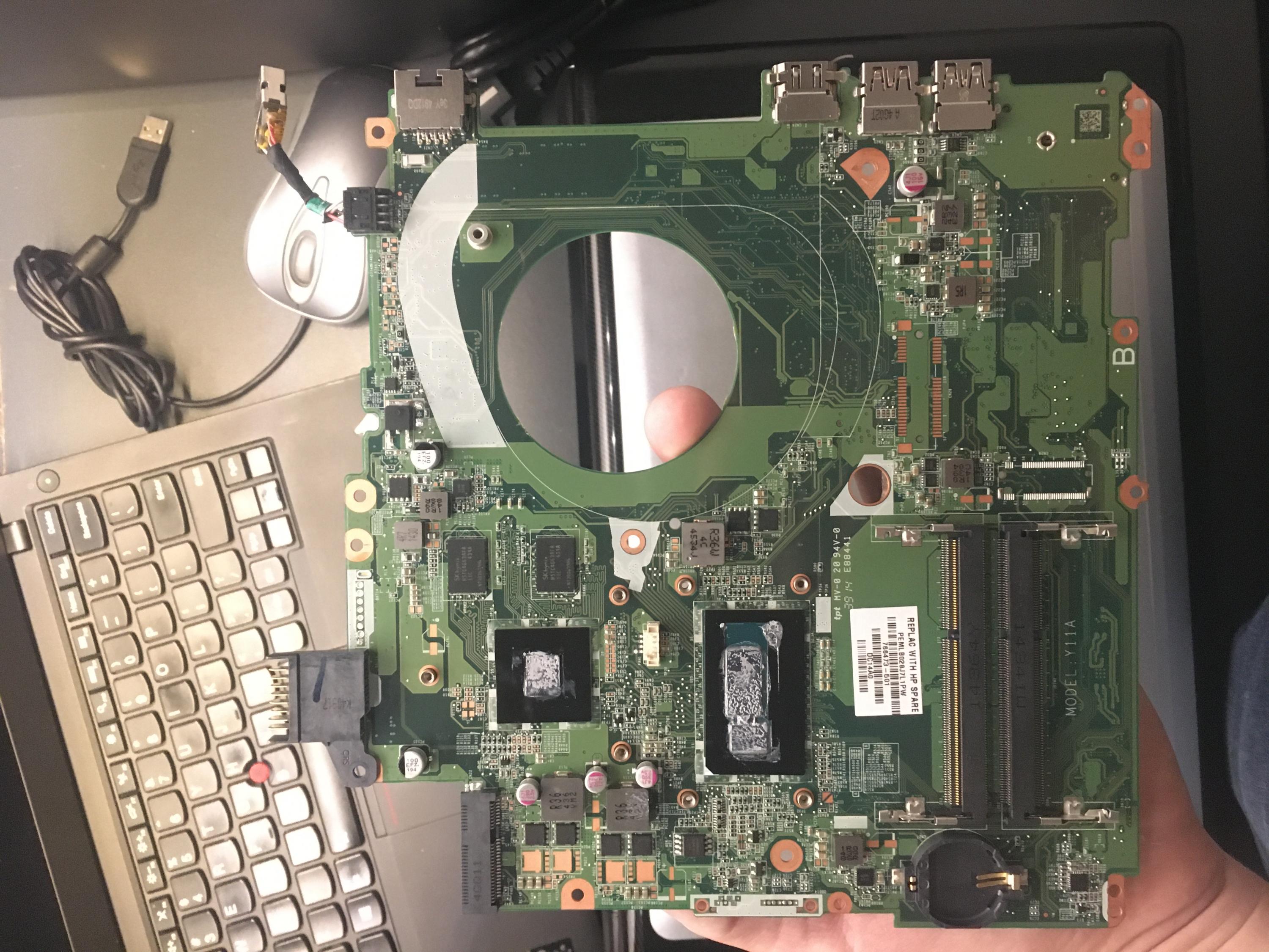

    Hello guys.

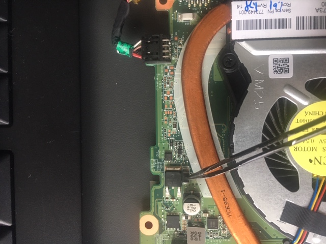

    I am trying to repair a HP Pavillion 15-p035nd, which has no power. I have a 19v rail, but no 3.3, or 5 volt.
    In the picture you see me point at a component, where 19 volts goes in left, and 0.0v on the right. Also, on the mosfet above, input is 19v but no output. Output is also shorted to ground.
    Does anyone have an idea to fix this?
    Greetings,
    Gerben.

    That’s a capacitor one side is ground other side you get power check your power button if it’s having 3.3V

      Post the motherboard part number,it might be next to the memory slots and will be something similar to DAY23AMB6C0

        Around the memory slots was this:
        tpt MV-0 20 94V-0
        PEMLB028J7LPW
        766473-501
        DC14A0
        Model: Y11A

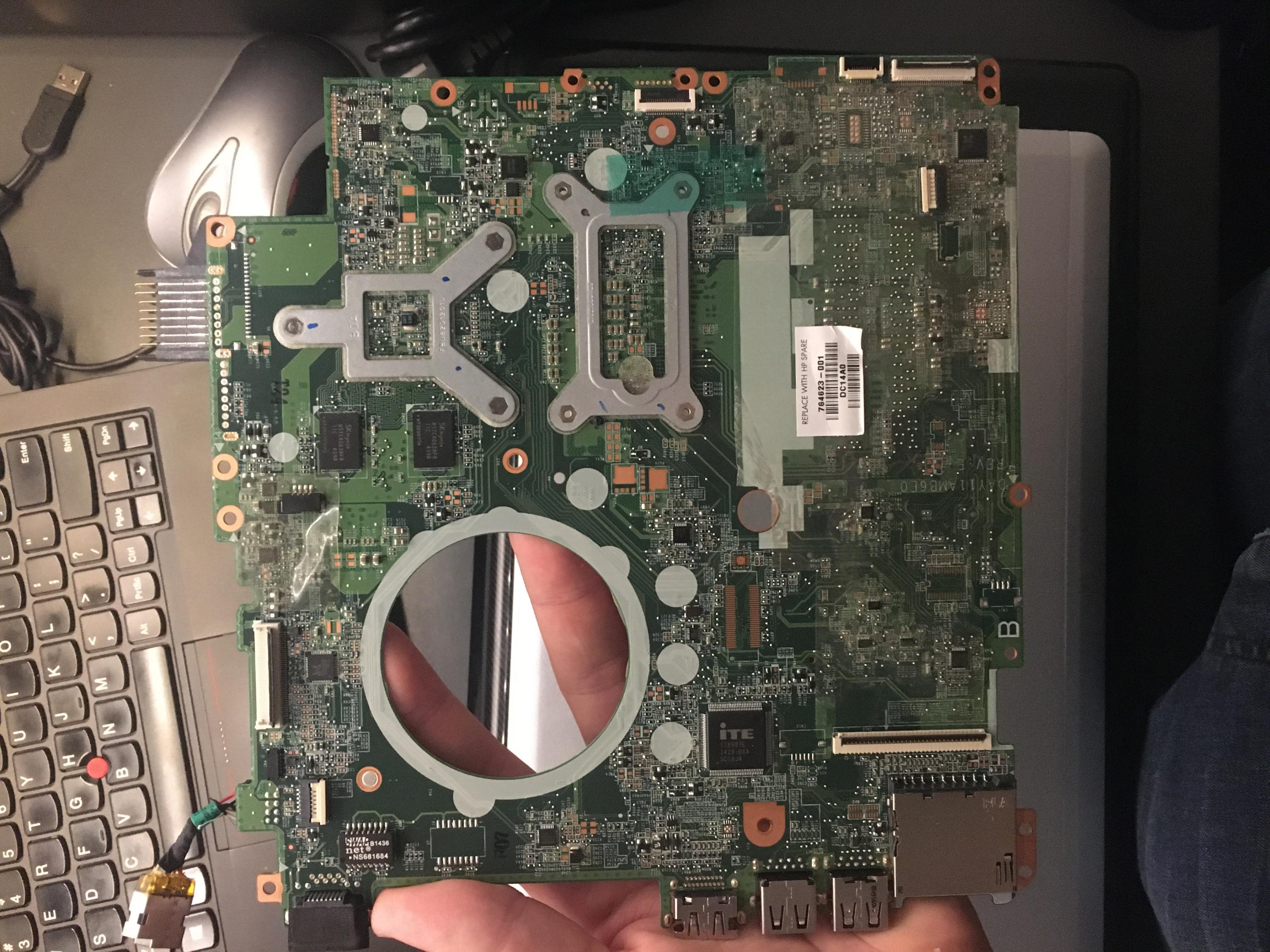

            Take a pic of the MB both sides upload

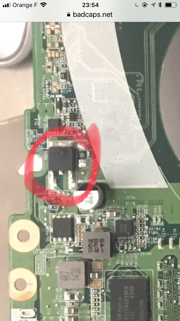

                There is a burnt mark on this MOSFET it's 30V N or P Channel Fet

                  Oh my lord thank you so much! What kind of mosfet can I order? Should I get a N or P channel fet
                  • Techtiger
                    • Oct 2014
                    • 1602
                    • france
                    Re: HP Pavillion 15-p035nd no power
                    Just next to the Fet if it is mark as PQ20 as for the Schematic it’s N-channel 30V

                        So i replaced the mosfet. I do have 19v again now, but still have the same problem. Left pin 0 volt. Right pin should be ground right?
                        Do you have any other idea about what it can be?

                              you replace a N-Channel fet SOURCE DRAIN GATE no Ground pins go through Youtube/Googel ect how the Fets work without basic knowledge you will do more damage to the MB , upload a pic of MB how you replace fet Q20 , put the multimeter in DIODE mode and test GATE & SOURCE
