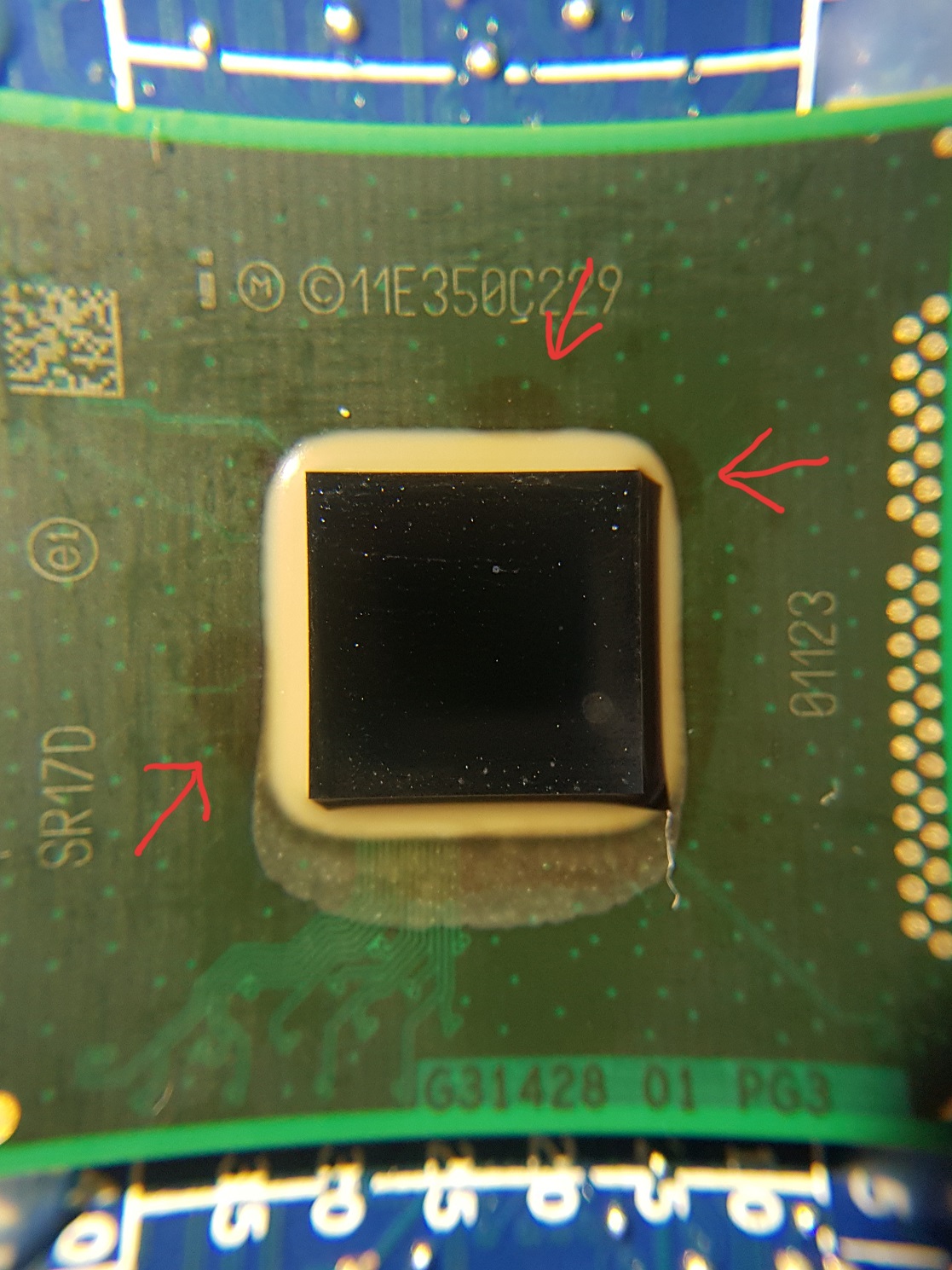

    Hi, I have an Alienware 17 R1, the customer shorted out a USB port shorting the board also.
    PU100 gets hot when the AC adapter is connected.
    QZ6 is shorted on pins 1,2,3, QZ3 pins 1,2,3 are shorted also so +3V_PCH and +3VS are shorted.
    If I got the identification correct LH100 is shorted on both sides.
    UE1 is shorted to ground on pin 32 (PCH_PWROK).
    PL301 was shorted also but short goes away when PJP301 is uncrossed/dissconnected.
    UI2 is burntout on daughter/IO board.
    CPU and GPU are tested in another system and are good.
    Does the PCH_PWROK short indicate a dead PCH?
    Schematics attached. LINK to schematic --> https://www.badcaps.net/forum/troubl...331p-schematic

    UH8 is shorted on pins 1,4,5.

      Re: Alienware 17 R1/Ranger la-9331p short
      I guess when you say "shorted" you mean "shorted to ground"?
      PCH is most likely dead.
      Inspect PCH die visually, if there is a defect or a burnt spot.
      You can inject power on the 3.3V PCH rail, if the PCH heats up it is dead.

        Yes, sorry, by "shorted" I mean "shorted to ground".
        There are dark brown areas around the PCH die. Picture attached.
        I injected 3.3V to the 3.3V PCH power rail and the PCH immediately heated up. :-(
        Looks like it'll be a new board for them. Thank you very much for your help pienov. :-)
