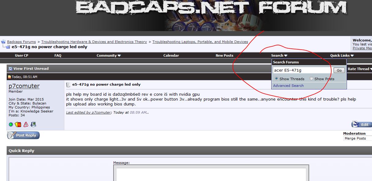

    pls help my board id is da0zq0mb6e0 rev e core i5 with nvidia gpu
    it shows only charge light..3v and 5v ok..power button 3v..already program bios still the same..anyone encounter this kind of trouble? pls help

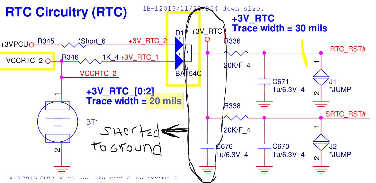

      check pin 112(RSMRST#) , pin 86(LID#) , PIN 3/11/26/74(for kbc power input), pin 120(DNBSWON#) , pin 125(NBSWON#) of kbc IT8587.

        C676 and d17 is ok tried to pull out,,still that part with mark is shorted to ground..why? help pls

          i think i found the problem,,the sio pin # 3 is shorted.
          i think its time to replaced sio chip..is there anychance or way..
          can i disabled pin no 3? is there any chance to run without replacing sio chip?
          C263 CAPS IS GOOD
