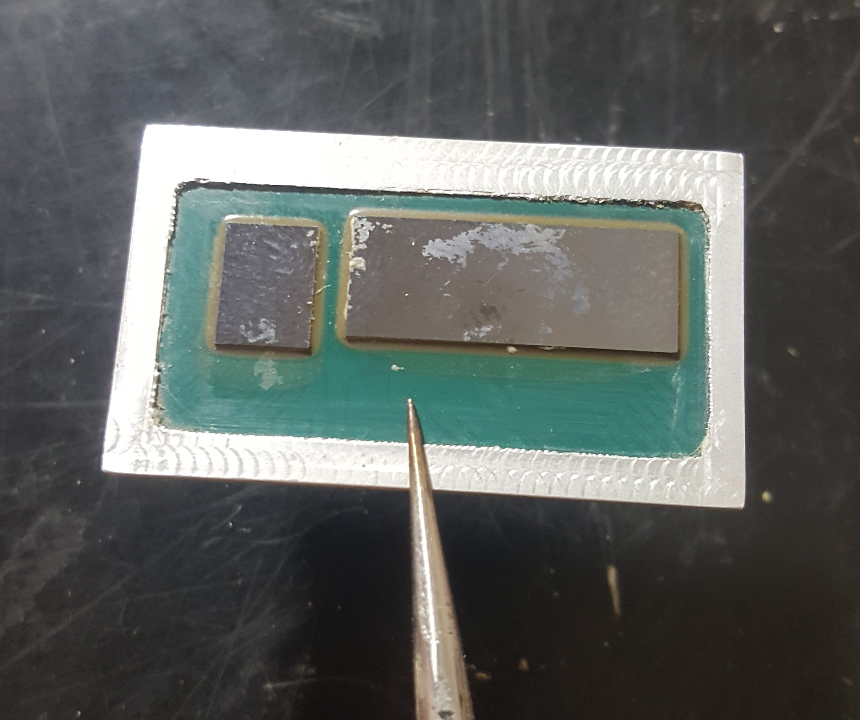

      this is an example of how I modify a cpu to avoid micro bendings. I have used a manual cnc and a piece of aeronautical aluminium.
      I remove the alluminium after solder process is made

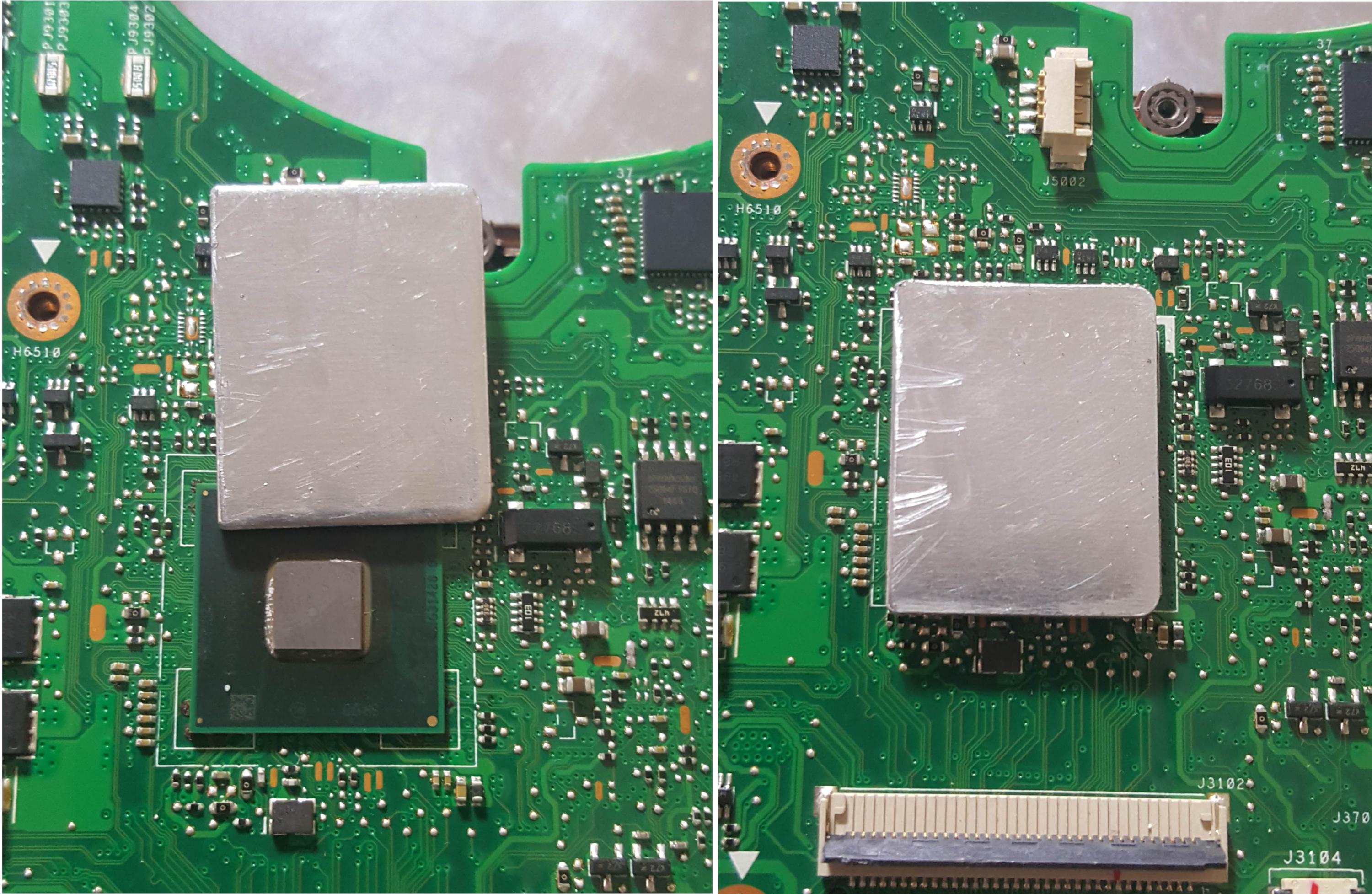

        Re: CPU Vcore Repair in Laptops
        An example to decrease the temperature of a pch even if it remains in the range of intel specifications
          Since Aluminum conducts heat, does it make the chip get hotter than expected in the photo of Post 22, when the BGA machine applies heat from above to the chip?
          Can the Aluminum keep the chip hot for a longer period than expected in the photo of Post 22?
                Some brands require this system on motherboards that used, the difference is that the frame is made of steel instead of alluminium but at the temperature reached, after some tests, there are no interfernces with the solder process. The amount of heat that a chip can absorb depends on the system used in the top heater. The use of air, in some respects, is preferable to the use of infrared, because it allows a better heat distribution. Infrared emitters that are used in low-cost commercial stations produce a range of infrared at a frequency that is not the best for the type of materials used. A Bga is made up of a series of materials that have their absorption peak at different frequencies. In the best case, an appropriate frequency (a range of frequencies) must be used to allows good absorption by the alloy balls while it should pass through the resin parts with minimal absorption. These principles are very important when choosing a welding profile becasue some materials will heat up before others and therefore a balance between time and power used is necessary. The subject is very complex and I have problems explaining my point of view in English.
