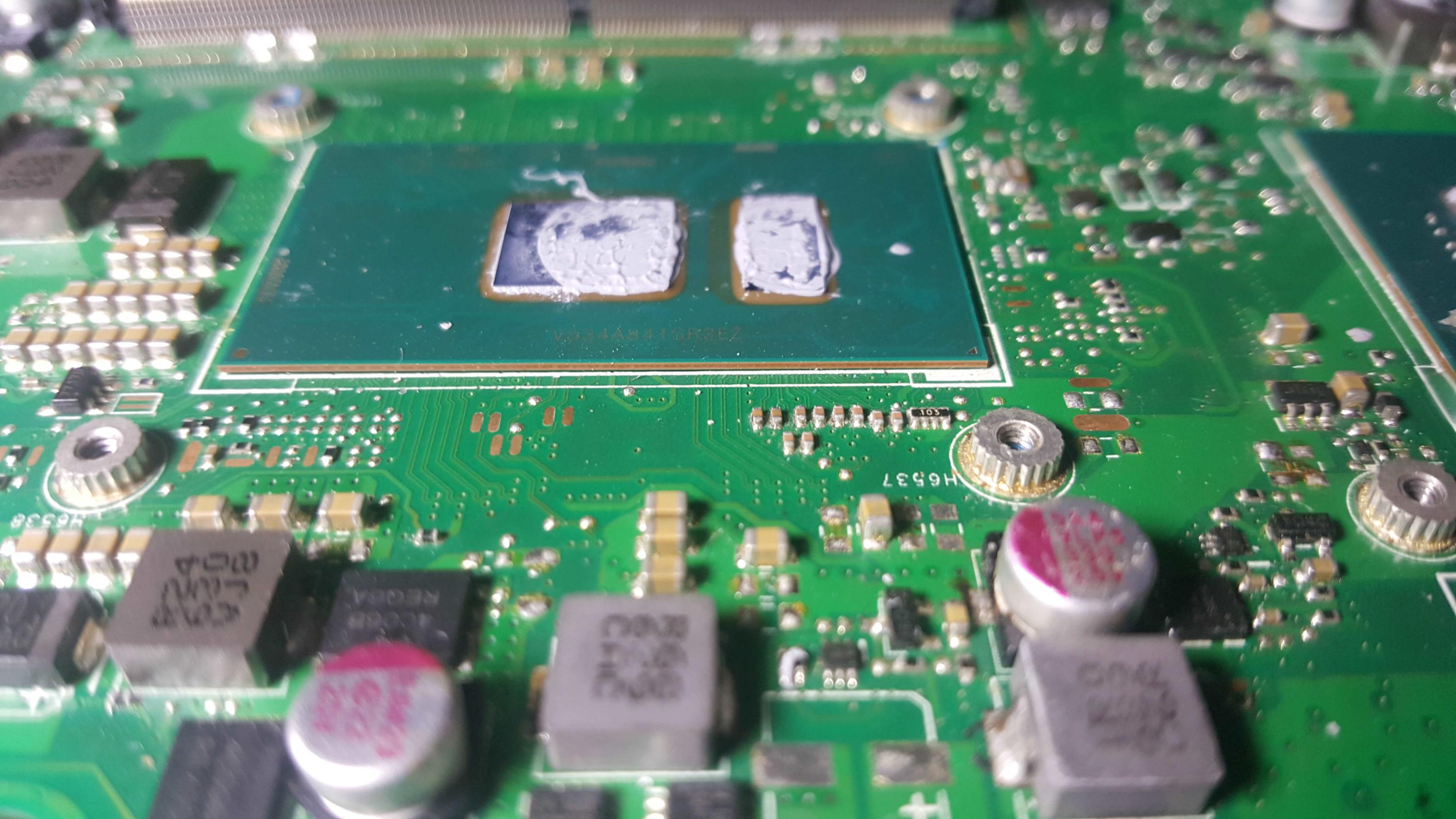

                              • jasko_jacker
                                • Oct 2014
                                • 1137
                                • italy
                                Re: CPU Vcore Repair in Laptops
                                The first problem is how to find a good cpu with reasonable price.
                                I solder these cpu with a dedicated temperature profile to prevent the chip from bending.
                                If I have to re-solder a non-perfect chip, I use a special glue for high temperatures and an aluminum structure that prevents the chip from bending.
                                After welding, I remove the structure.
                                As you can see from the pic the result is acceptable
