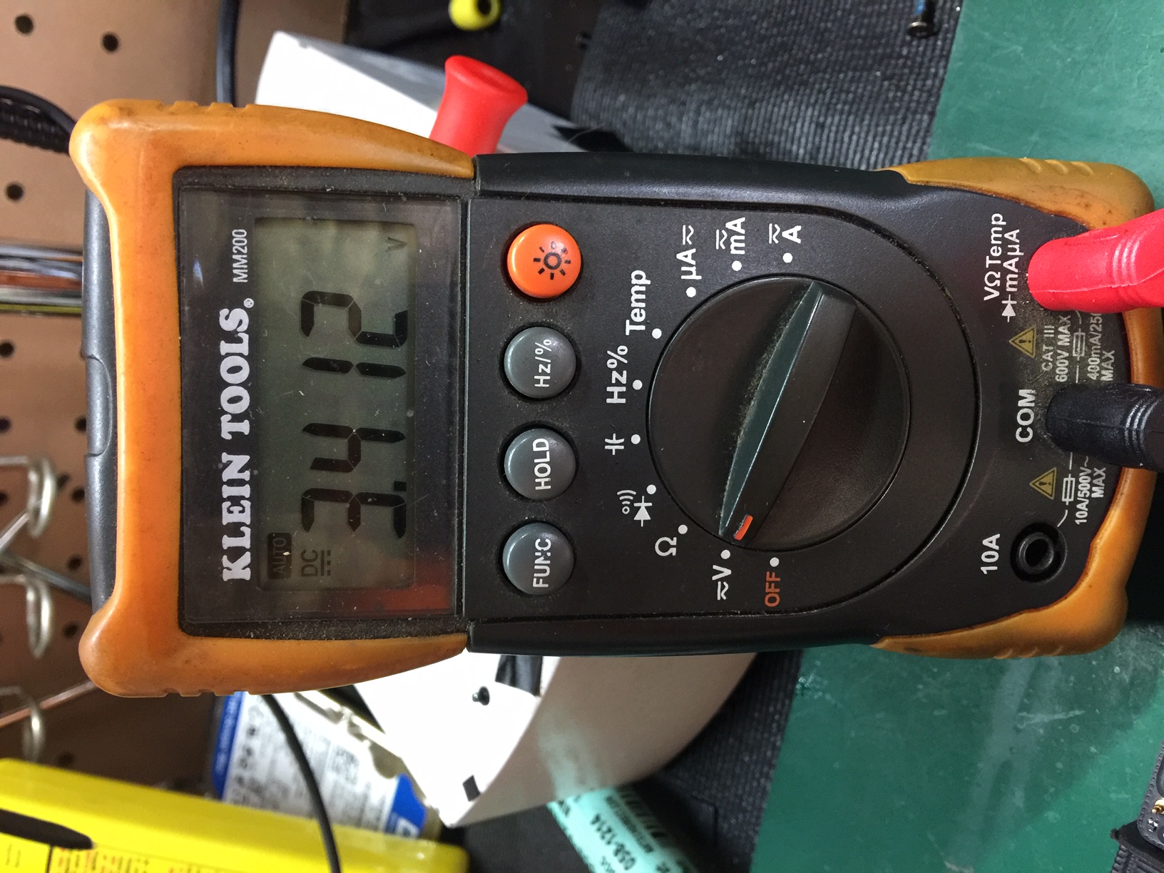

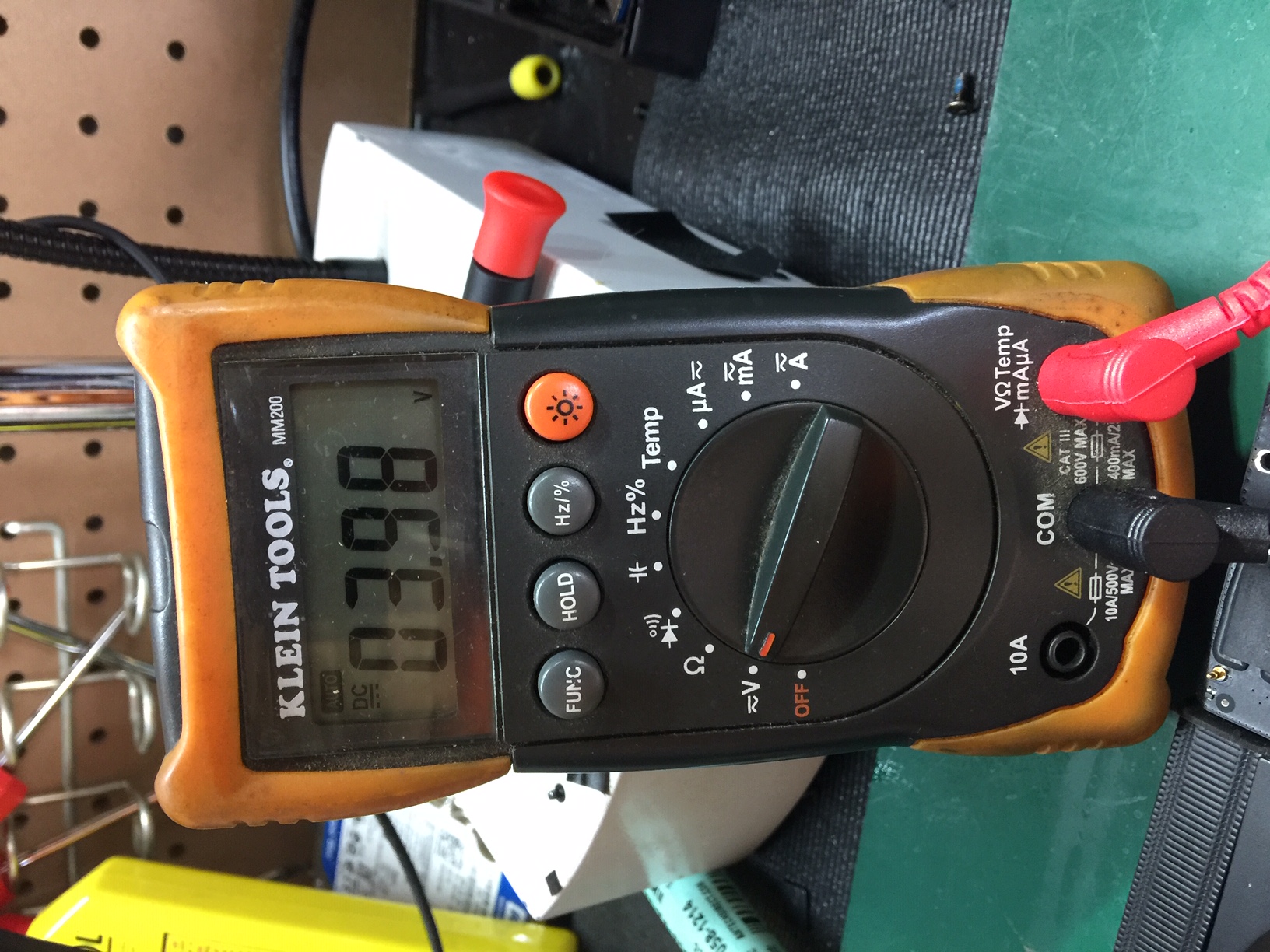

                        • piernov
                          • Jan 2016
                          • 4439
                          • France
                          Re: 820-2850A wont turn on
                          I read 3.98V and 3.412V on the multimeter. If the first measurement at 3.98V is on CHGR_ACIN then everything is fine there.
                          Measure exact voltage again on PPBUS_G3H. If it is still low (less than 12V) measure its resistance to ground. Check if the fuse is burnt too.
                          • TimT
                            • Nov 2012
                            • 268
                            • us
                            The 03.98v was for the CHGR_ACIN 3.412V is for sys_onewire. right now I have 0v on ppbus_g3h.

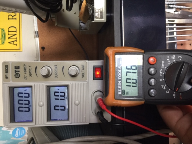

                            • piernov
                              • Jan 2016
                              • 4439
                              • France
                              OK so 0.4 ohm on PPBUS_G3H means there is a full short to ground. First thing you can do is remove the fuse F7040 and measure resistance to ground on both pads, to see if the short is toward U7000 or toward system.
                              Then using a lab PSU you can inject 1V on the shorted side, and check if anything gets hot. If nothing gets hot (incl. CPU/GPU/PCH) then you can increase the voltage a little and check again.

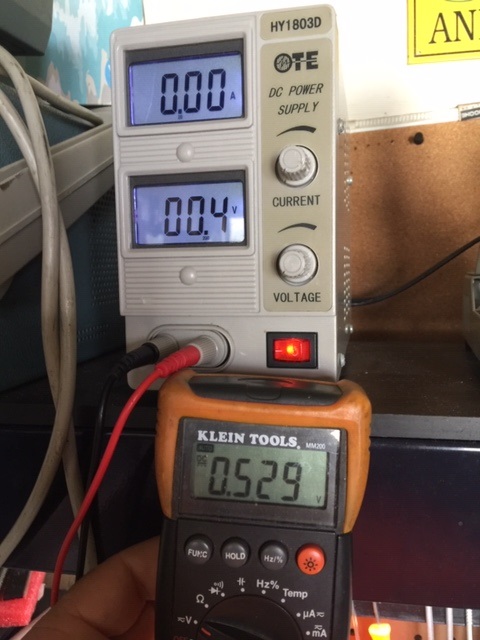

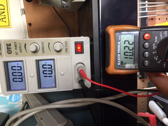

                              • TimT
                                • Nov 2012
                                • 268
                                • us
                                Q7035 was shorting, after replacing that PPB_G3H came up but only to 1.7v and I noticed a slow drain in voltage in about 20 seconds or so it's 0.9v. re-plug the charger back in 1.7 then drains. I think may have only 0.4v at R7010 I did some testing with the multimeter the results are in the images.
                                • TimT
                                  • Nov 2012
                                  • 268
                                  • us
                                  possible second short. meter sometime is at 0ohms then not.. used my bench power supply but now wont take any power at F7040. installed a battery and PPbus_G3H is 11.25v No lights/fanspin
                                  • piernov
                                    • Jan 2016
                                    • 4439
                                    • France
                                    If PPBUS_G3H is 11.25 with a battery, it most likely means PPBUS_G3H itself is not shorted.
                                    However the fuse could have blown and the short be isolated before it, on the controller side.
                                    So make sure fuse is not blown and measure resistance to ground on both sides.
                                    Also, for higher chances of fixing the issue, it's always better to replace the MOSFET Q7035 and the controller U7000 at the same time. (maybe even the other MOSFET Q7030).
