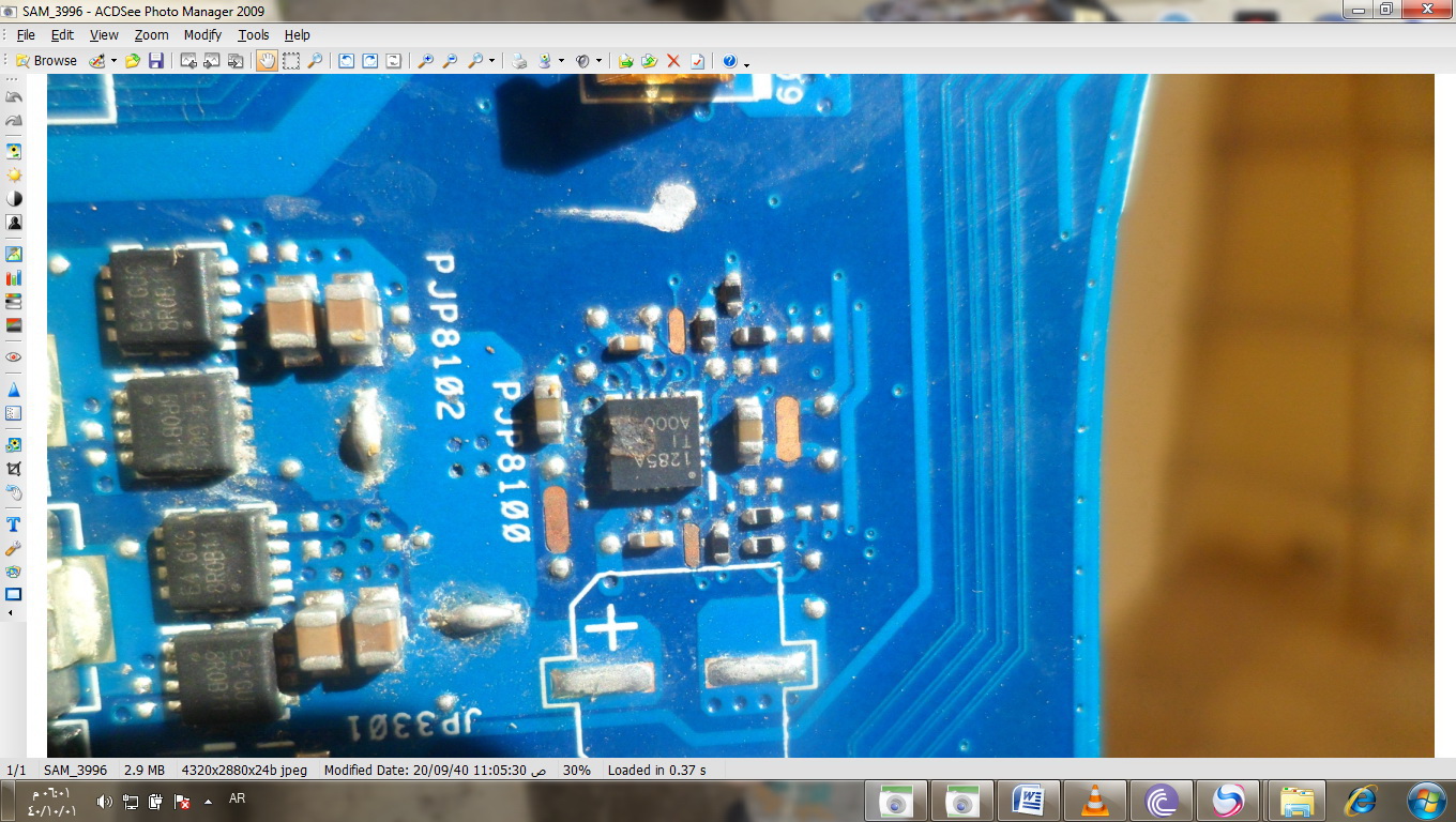

    hi
    i need a compatible -replacement of ic power IC 1285A in asus laptop
    thanks

    Re: Ic 1285a replacement
    https://cdn.badcaps-static.com/pdfs/...bc7e0fa746.pdf
    Replacement might be 51225b/c
    https://cdn.badcaps-static.com/pdfs/...2c6e6f33b6.pdf
    but not sure, if possible use original.
      tps51285 can be replaced with tps 51225. i have done it succesfully on asus mb TP550
        thanks i will try
              rt6585b = tps51285B
              Replacement
              equivalent ic
                  This idea didn't work well on a ASUS UX550GD - High Side Mosfet for 3.3V rail kept burning.
                    It works. you may have problem in load side. Remove the IC and check resistance on LDO lines. Do check all the fets for short.
                      replacement of ic power tps51285A by tps51225 work for me in toshiba c50 m/b :pt10f
