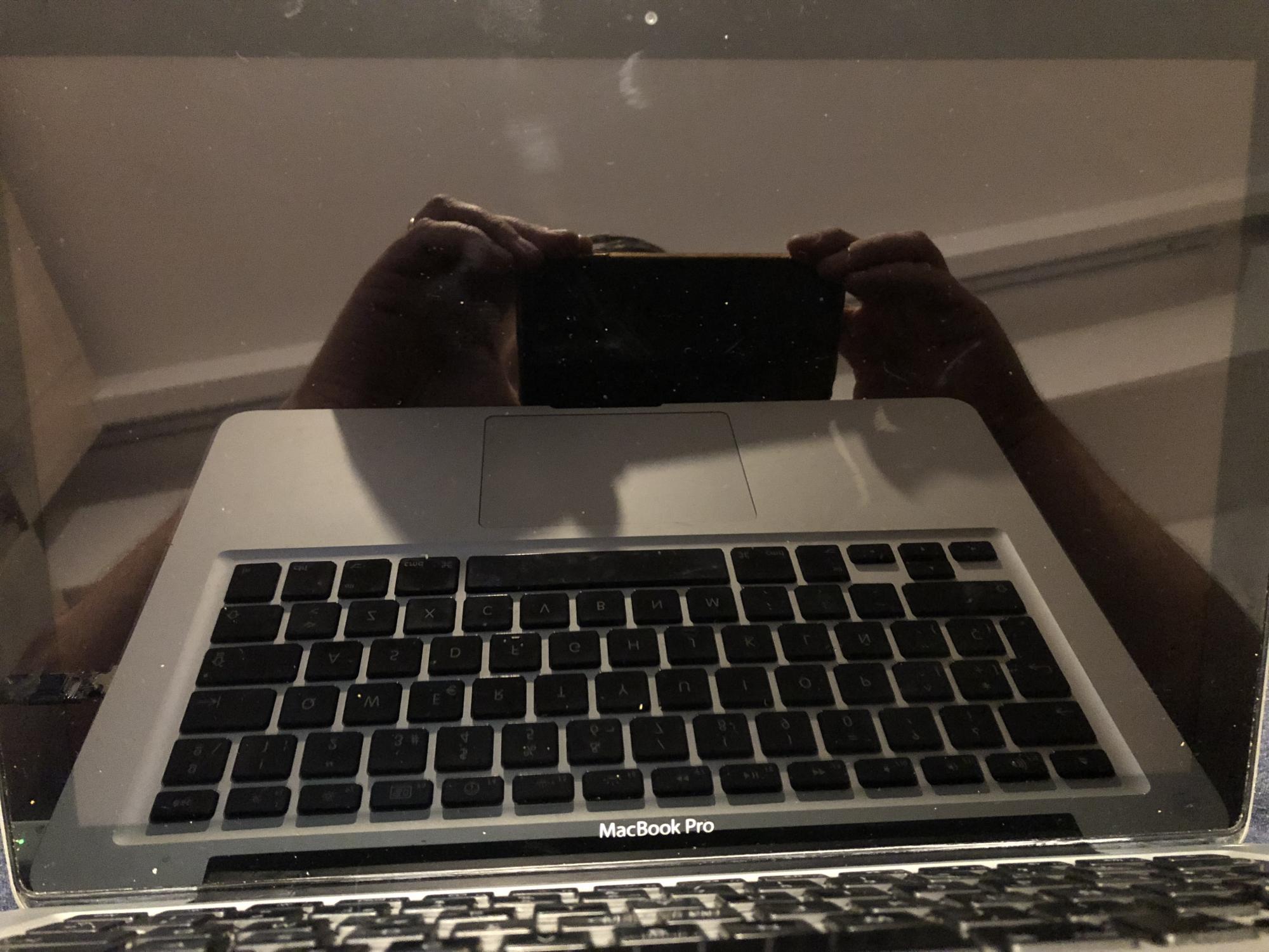

    820 2936 chimes, backlight present but lcd is black
    It came in with dimm green light, liquid damage...
    Fixed green light, bios chip was knocked off the board.
    Replaced lvds connector and lcd backlight fuse.
    I took out bios chip from a donor 2879 board without reprogramming it...
    Now it chimes and fans spins.
    Lcd blcklight voltage is 27.2v on d9701
    I can see the backlight comming on the screen but screens remains “black-ish”
    Can’t see any logo or question mark folder lighting with flashlight from the back of lcd...
    I tried 3 screens all known working, same result...
    Any ideea where to look?
    Thanks!!

    You waited for like a minute or so?
    Try a USB drive with macOS on it and check if its activity LED blinks.

      Re: 820 2936 chimes, backlight present but lcd is black
      Yes, i tried, it has activity, but the screen is still black

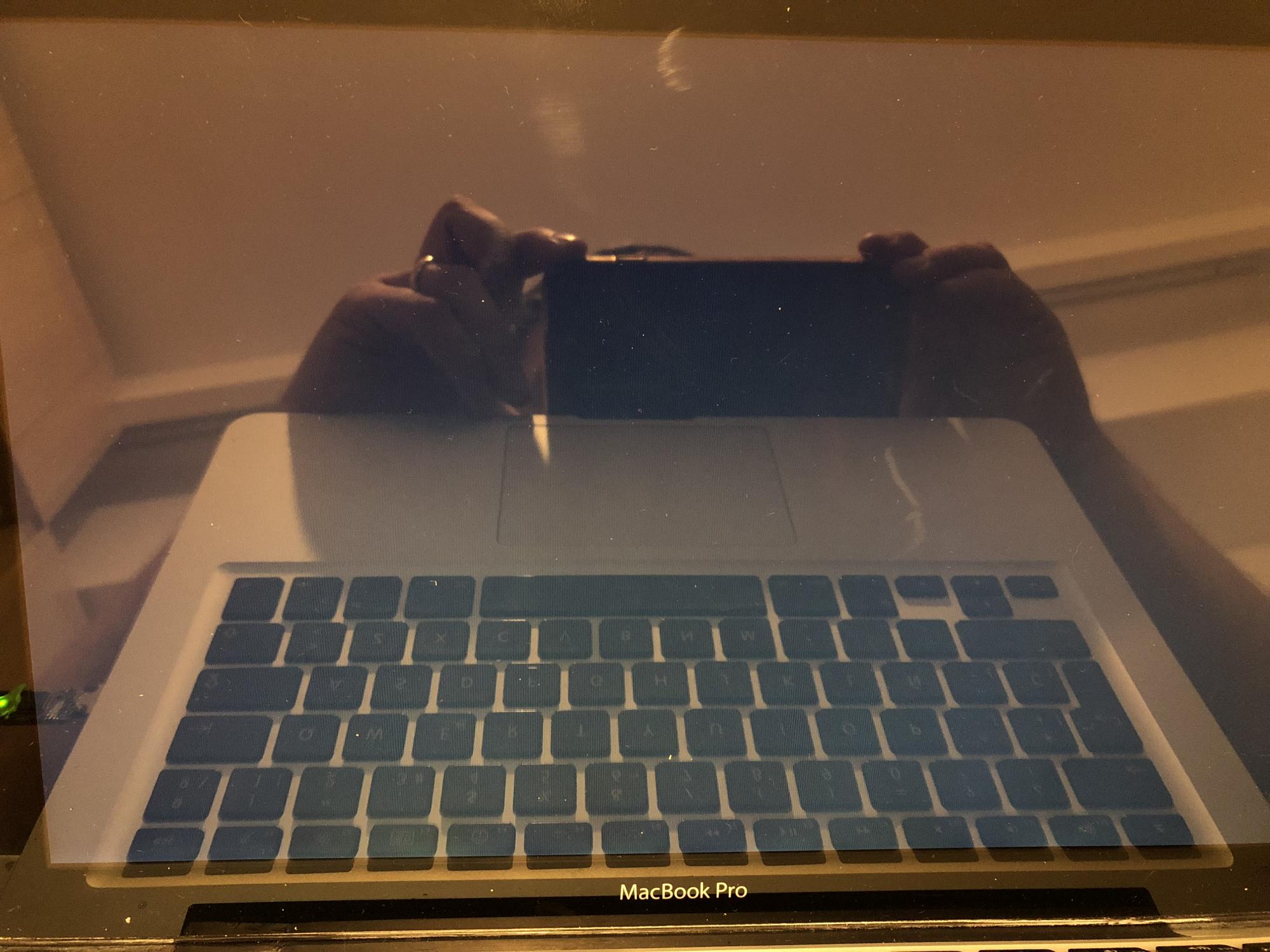

        See attachment, laptop off very dark screen
        Laptop on screen dark/blue
          Try PRAM reset and try with external display.
            I think it has some issues with keyboard also, i tried pram reset but it won’t do it...
            I will flash new bios in minutes and see if it helps...
              New bios 820-2879b didn’t work (although my board is 2879a)
              Pram reset didn’t work...
              I think it’s some bad trace from or to lvds connector?!?
