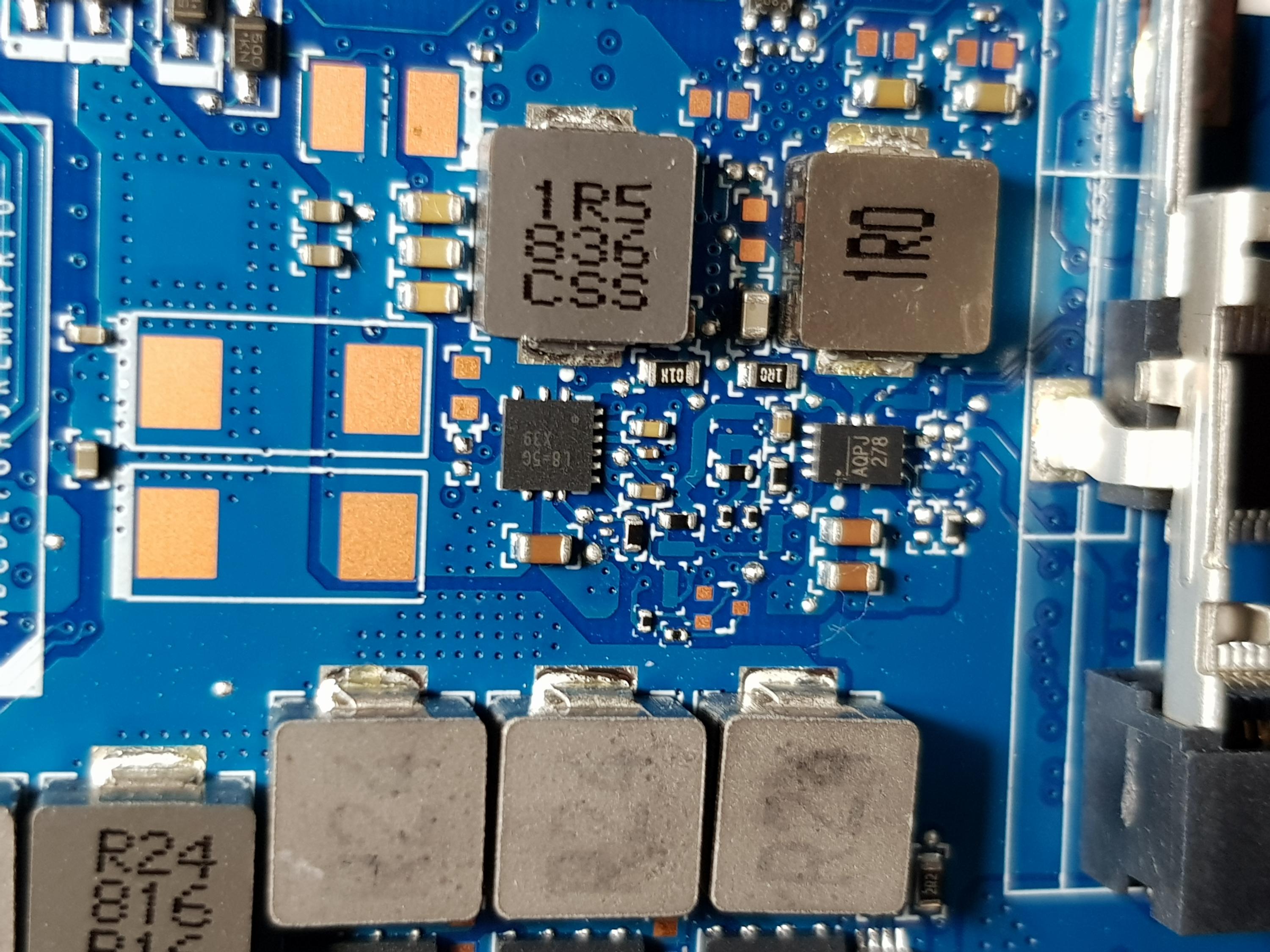

Help to identify this IC with the marking code "L8=5G"?
  • Weelcup
    TopTech
    • Oct 2017
    • 302
    Can you please help me to identify this chip. I think it is responsible for the 3.3v ALWS but I am not sure. It belongs to hp omen laptop motherboard with i5-8300H CPU.
    The marking code for this chip is "L8=5G".
    I have attached a pic for the ic.
    Thanks in advance.

    Re: Help to identify this IC with the marking code "L8=5G"?
    I believe it is a Richtek RT6256BGQUF
      OMG!
      THANKS 1000000000000000000000 TIMES.
      YOU SAVED ME MATE.
      I spent 3 days looking for it... never had a clue.
      So you are my star. Thanks a loooooooooooot. A loooooot. It is it for sure.
        hello,
        I need information on the chip right next to it called AQPJ 278 in the Wellcup photo!
        I can't find any information ?
          Just found this amazing item on AliExpress. Check it out! US $1.24 6%OFF | Original NB681AGD-Z NB681AGD QFN Printing AQPF AQP Have Stock New Product
          https://a.aliexpress.com/_mLCyKZ8
            Datasheet from MPS for this part is attached.
              thank you very much sir
