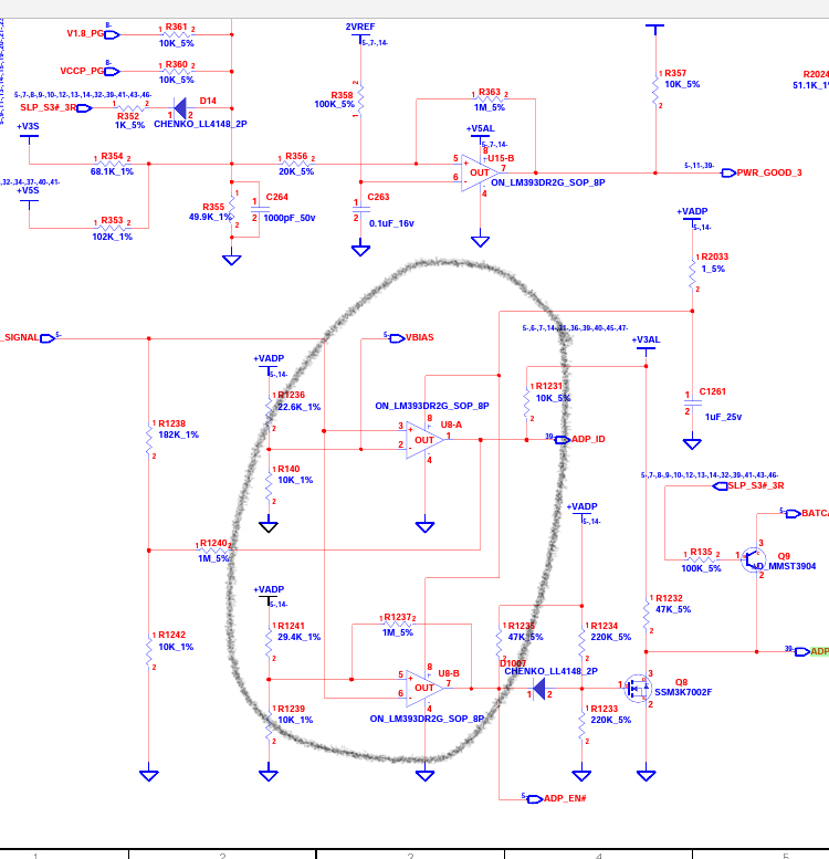

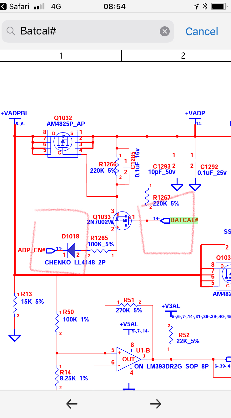

    Hp 6730s (605A2161001-MB-A02) no power no charge, its working ok with battery only, i have 19.70V on Q1032 pin 1,2,3,4 & 0V on pin 5,6,7,8.
    I have make a trick i break connection of pin 4 (Gate, Q1032) and now its working.
    On pin 3 of the dc port (Limit_Signal) i get 0V
    The problem is with the Limit_Signal, how can repair this?

    Are you using the original 90W adapter, Voltage on U1021 all pin except GND, voltage in R 53 both sides

      With the Q1032 soldered correcly (no break on pin4, no battery connected) i have 0V on U1021 & R53.
      With pin 4 of Q1032 not connected (system off,no battery connected) i have the follow voltage
      R53 = 0V (both sides)
      U1021:
      pin 1 = 2.25V
      pin 3 = 0V
      pin 4 & 5 = 4.97V

        Very complicated mob there are a lot of +3VAL & +5VAL , Test your charger middle pin outside of the mob, may be LM393 is faulty May be test R1338
