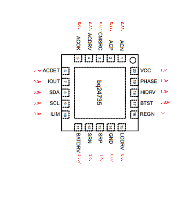

    hello.
    Have this ASUS X555LD, that have no voltage/0.88V/ after first mosfet. on gate of it is same little voltage
    my measurements give nothing for me and jumping fist two mosfets bring it to life, so there must be problem in this charging side
    replaced that BQ24735 with known working one, but readings are the same

    Re: ASUS X555LD - no voltage after first mosfet
    sorry for bothering u guys.
    the second mosfet was faulty. after replacement everything works
      Yep common fault on Asus boards. Still not sure what causes that.
