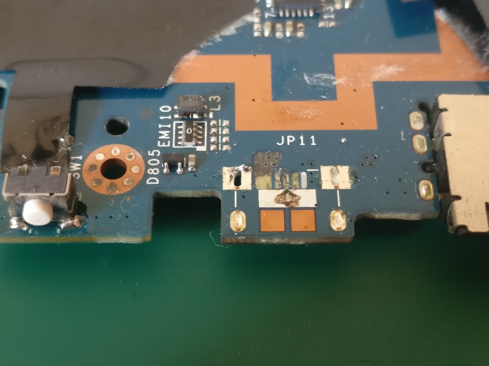

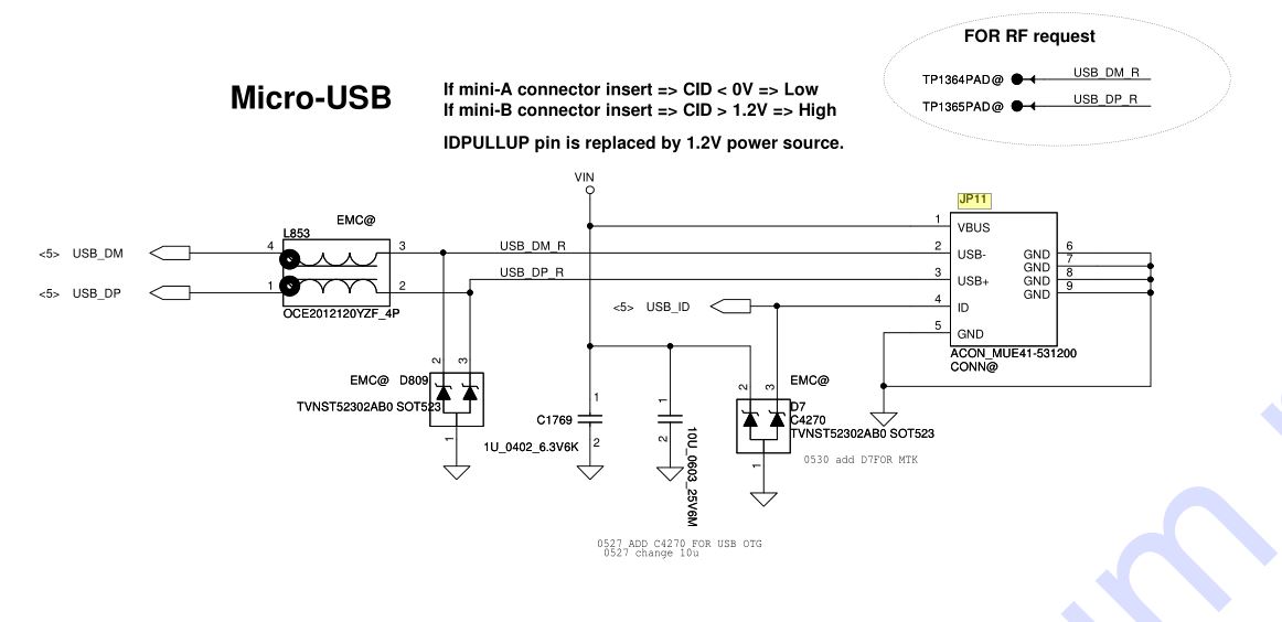

    I am facing a big problem, I want to fix the power of a tablet, but the usb port was pulled out and some circuits are gone.
    Here's a picture.
    Any idea about how to fix this? For instante to connect an external cable to the other point of where the plug was connected.
    Any help would be appreciated.
    Thank you.
    Pedro Santos
    • 21922
    Re: Little help needed with power of ACER a3 tablet
    Solder a new USB socket on and jumper wires .
