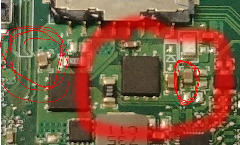

    Please identify for me what type (model) of mosfet is used at the place which is signed on photo.
    Motherboard model: DABKLAMB8D0 REV D
    dc/dc converter battery charger is BQ 24780s
    best regards

    the marking code on the mosfet is not readable in this photo. you should read it under a microscope and mention the code here.

      Re: Asus GL503V mosfet identification
      that mosfet is easy findable. just put 4digit number on him to google with word MOSFET after numbers.
      u can replace it with any same packet mosfet with same channel and nearly or more amperage
        thanks for reply, but im not into about reading model from soldered one but to find the exact model which is provided with motherboard
        i have got battery charging problem while I had replaced the mosfet with new one N channel 30V prewious was shorten and problem still exists, i thrown away old one so I need to find the mosfet model
        its not about reading from soldered
        orginal one and replaced could have little difrences so it could not solve the battery charing problem
          no little differecies matter. only what matters is channel and amperage. if have still problem u must search elsewhere.
              Dont worry, they will be done ok cause I've take them out to find shortage.
              Doeas any 1 know what mosfet is there ?
                did u try to use that switch behind battery connector? as i see it is not lid switch but intrusion detection switch
                  its not about switch, because voltage state is flowing around this mosfet and sth is not ok so im looking for mosfet exact model, im sure i solder in correct one according to n type and voltage but maybe other characteristics are little bit different
                    so u think if it is 19V on input of that mosfet than mosfet must be bad?
                    mosfet is just fast switch. the main things is going inside of driver of that mosfet
                      codigo mosfet AON6435...
