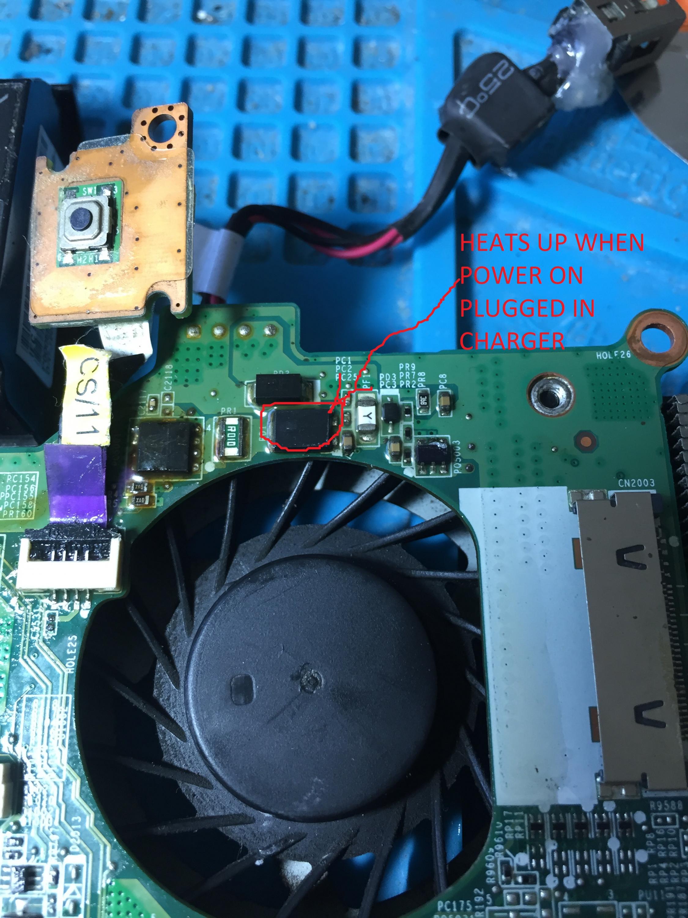

    I need help on this please. i have here a Toshiba Satellite C840 laptop with BOARD IDABY3CMB8E0 REV:E.Everything works fine when charger only plugged in and with battery plugged in only, but the problem is you can charged the battery only with no issue with the laptop is off, but when it is power on and you plugged the charger it cannot charge the battery as one component is heat up. i have upload a image on the component on the board.please help

    Re: Toshiba c840 not charging battery when power on
    check PQ5001 and PQ5002 may be short ?
      I check pq5001 and pq5002 mosfet there is no short and not beeping on the multimeter.
            Try to mesure The battery Coil for Ohms and the +- pins of battery connector Ohms to GND try to upload the Schematic
              Replace pd1 and the caps with corrosion .
                It's normal for the diode to heat up a bit under high load, 0.5V voltage drop across the diode with 4A is 2W, so yes it'll make it heat up a bit. I see flux around there so make sure the diode is the proper one. Also if the battery is not charging while the computer is being used, maybe the battery is bad or the AC adapter is not the proper rating.
                  • 21936
                  PQ5003 looks like it needs rework as well .
                    @techtiger battery coil in ohms mode red probe to ground and black to both sides of greycoil mesured 0.255 both coils
                      @smdflea should i replaced PD1?this is heats up if i plugged the charger with the laptop is on but when laptop is shuts off it charge good
                                Problem solved on this it was PC22 is the culprit replaced it and now its working fine
