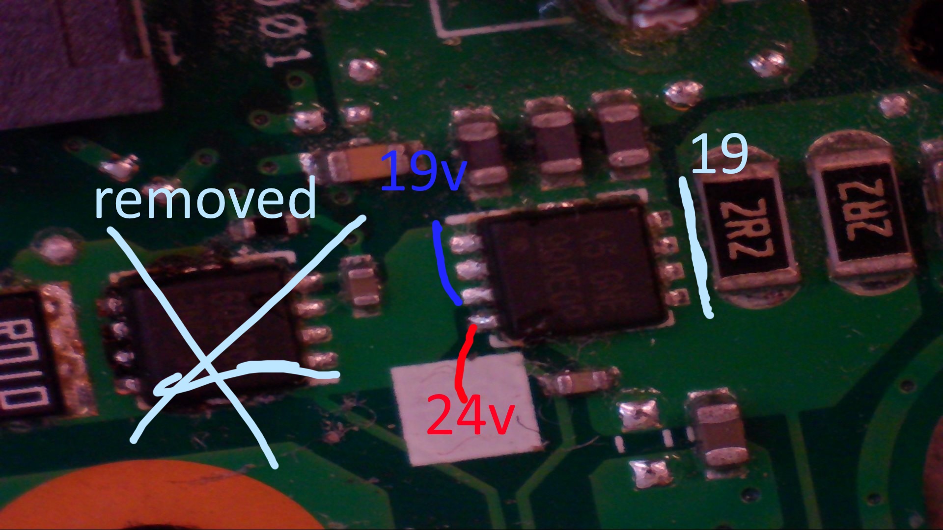

    Laptop not charging , not powering up .
    this two mosfet in the schematics are pea28ba, but i have another mosfet ,, i maked pics with voltage on it

    The 1st Fet is not passing the 19V output check for short the 2 Fets with the help of the Multimeter. Try to find the Boardview file or make a Request in Bios Section
    Check the pea28ba fet not correct number

      Re: Asus P302L x302la
      i will check i need to find the right name of this mosfet
        i removed the 2 fet
          from other post found on forum
          A5 GNA = A5 GND
          marking significant "A5" P0903BEA. Everything else - the date, lot, ...
          N-MOSFET P0903BEA - AON7408 & FDMC8884
          but my one is a5 gne

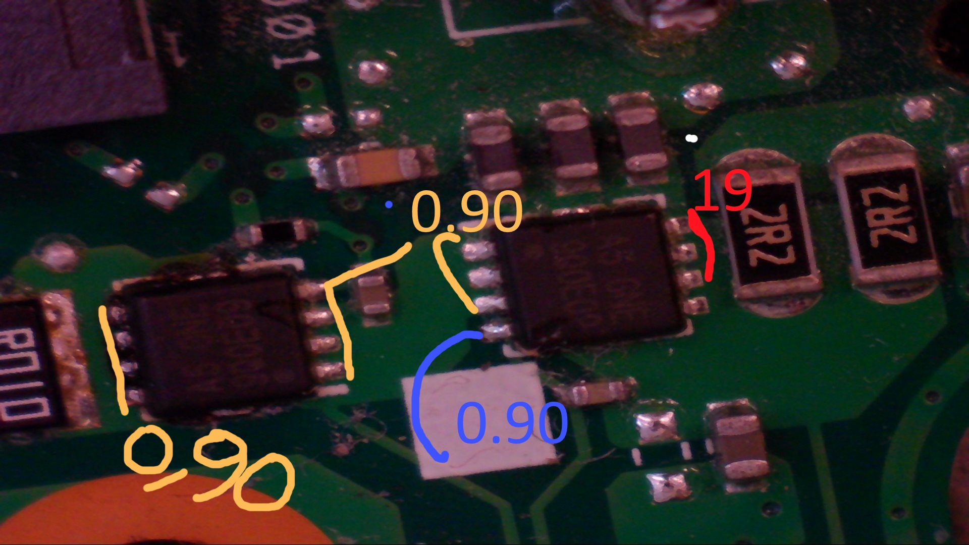

            replaced with aon7408 i have again 0.90
              Originally posted by lordgeny
              i removed the 2 fet
              those 2 Fets are N-Channel thats why gate need 24V to by pass the voltage to the 2nd fet you can replace with any N-Channel 30V one
                Fixed with 7408 from donor board. At first try was not solder corrected. Thanks
