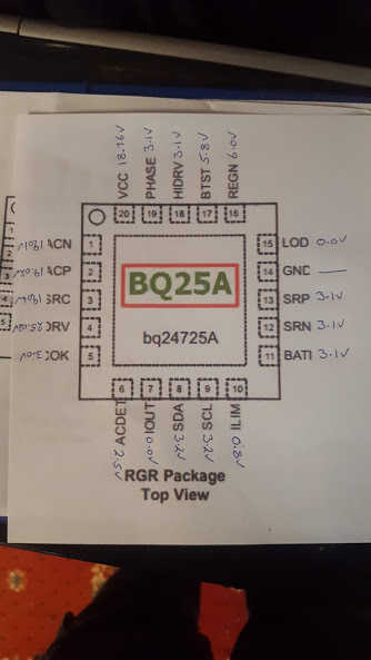

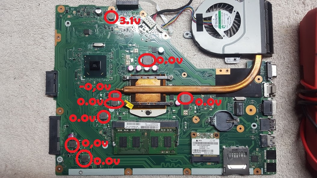

Hi guys got this laptop in for repair wont boot or nothing i got the schematic for it and did some voltage checks and i have only 3.1 v on the first coil after the main power supply i have attached a picture with all the power supplies.. Can anybody point me on what steps to take next to trace the problem or what process to check next ..Thanks
					Asus x55a no power or bootup

I'm just an hobbyist starting out in this stuff, but the voltages on the BQ24725a look fine to me. VCC,REGN, ACDET, ACOK all there. I'm assuming that the ACOK is being pulled to a 3V rail, and not suppose to be some other rail?Comment
Re: Asus x55a no power or bootup
B+ rail is present so nothing to troubleshoot around charger IC, it's working fine.
Time to check the LDO outputs of the 3V/5V regulator.OpenBoardView — https://github.com/OpenBoardView/OpenBoardViewComment

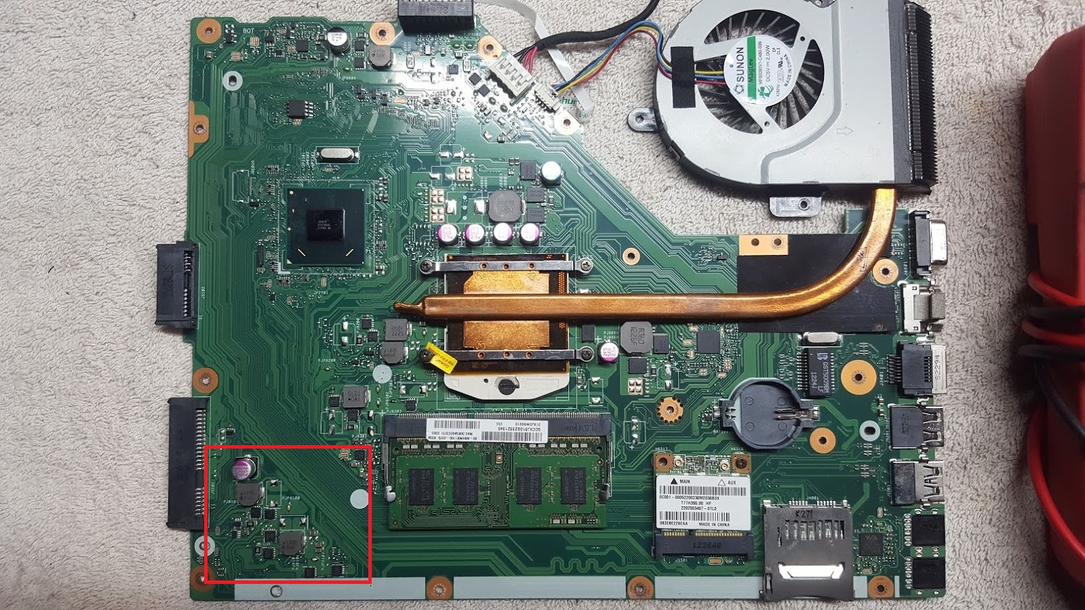

Thanks guys for the help much appreciated with the laptop got the boardview working piernov where exactly can i find the outputs of the 3V/5V regulator ThanksYour never to old to learnComment

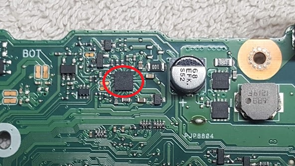

I can't open a boardview file while I'm at work, but usually its a 20 pin or so chip. On my Asus X541UA machine the 3V/5V is a RichTek RT8249C, although I don't believe it was labelled that on the chip (looking back at prior docs I downloading for fixing it!).
Can you indicate the markings on some of the 20 pin chips that you think might be, and we can go from there? Should be a couple of coils and FETS near itComment
It's PU8100 on the other side of the PCB in the corner. It's an RT8206 chip, 32 pins
https://www.richtek.com/assets/produ...S8206LM-07.pdf
The previous chip you were looking at (BQ25a) was the charger IC.
Look at the linked datasheet and measure outputs (use the boardview and search for PU8100)Last edited by brew99; 03-07-2019, 11:02 PM.Comment

Right here are the measurements for the power management chip
1 ref - 2v
2 ton- 0.0v
3 vcc - 5v
4 enldo- 06.39
5 nc - 0.0v
6 vin -19.25
7 ldo - 5v
8 nc - 0.0v
9 byp - 0.0v
10 vout1 - 0.0v
11 fb1 - 0.0v
12 ilim1 - 1.816v
13 pgood1 0.0v
14 en1 - 03.1v
15 ugate - 0.0v
16 phase1 - 0.0v
17- boot1 - 4.2v
18 - lgate1 0.0v
19 - pvcc - 5v
20 - secfb - 0.0v
21 - gnd
22 - gnd
23 - lgate2 - 0.0v
24 - boot2 - 4.5v
25 - phase2 - 0.0v
26 - ugate2 - 0.0v
27 - en2 - 0.0v
28 - pgood2 - 0.0v
29 - skip - 0.0v
30 - vout2 - 0.0v
31 - ilim2 - 1.3v
32 - fb2 - 0.0v
