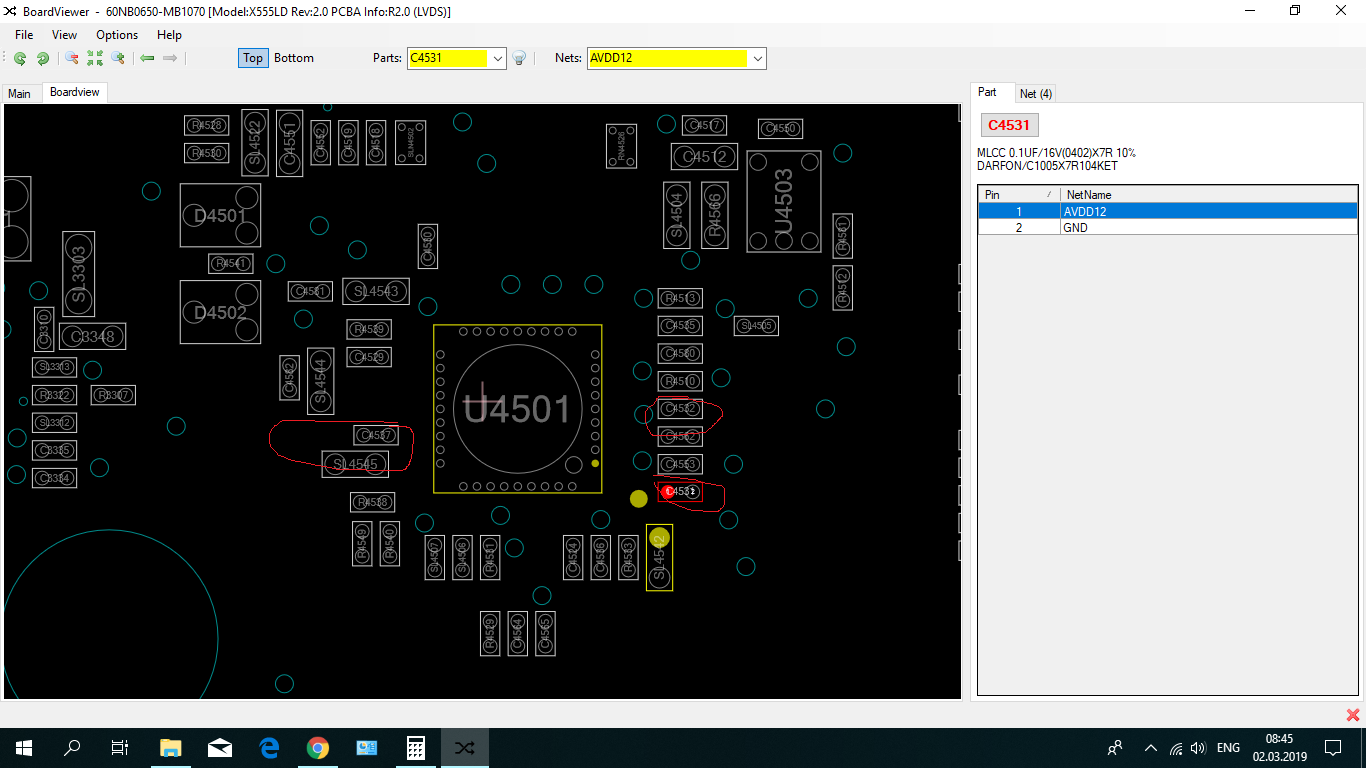

                  Have exactly the same problem on X553MA. did u have some measurement that prove that ANX1121 is bad, or u just replace it? Mine LCD look like bad too

                    Re: Asus X555LD no video on onboad display
                    When I tested with multimeter on diod, showed 0.040 on + 3V circuit and 0.004 circuit on + 1.2V circuit, and on the other board that I had as a reference shows about 0.387 on the same electrical circuits.

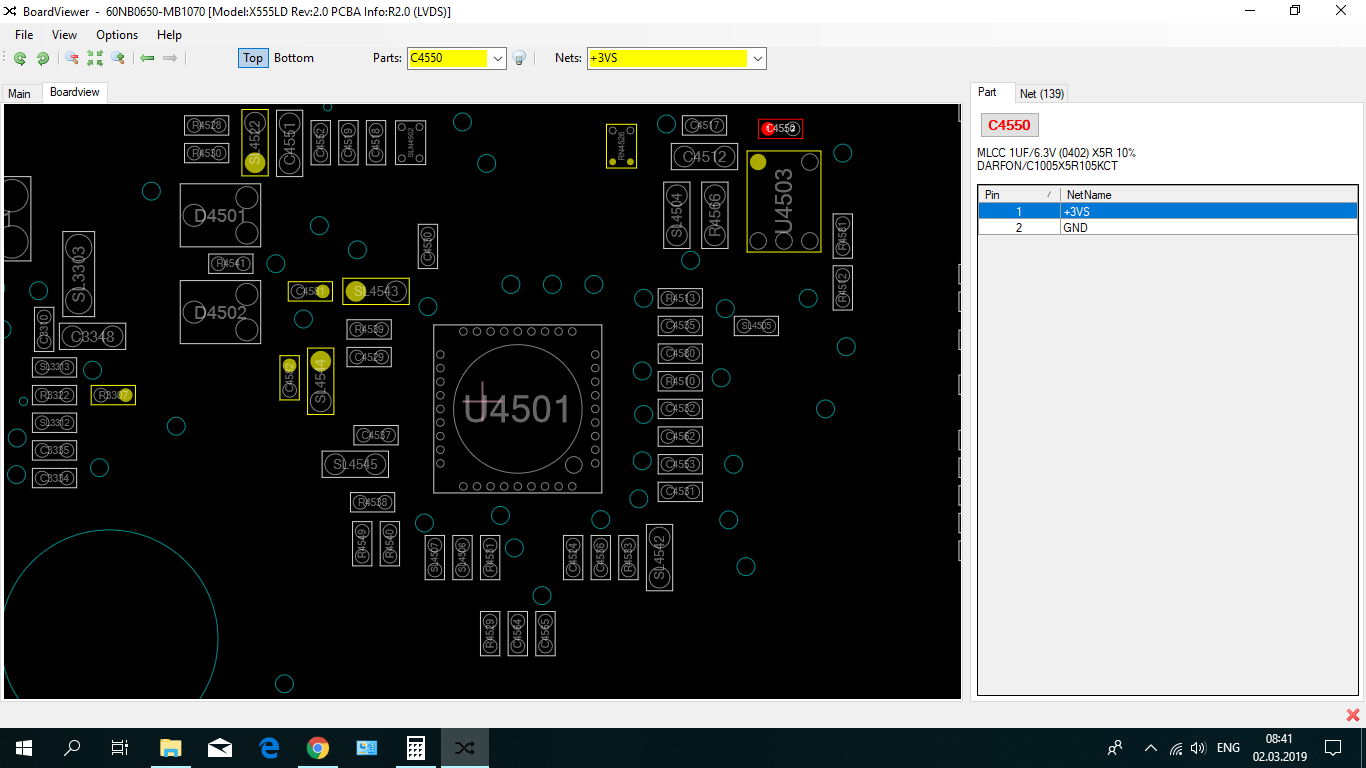

                      test J4502 voltage
                      pin 2 3 4 36 38 39
                      your +3VS line is bad find the starting point of +3VS you have to trace it from there
                        Originally posted by techtiger
                        test J4502 voltage
                        pin 2 3 4 36 38 39
                        allready checked - all ok. even all signals have its voltages
                        display not react, but when i connect known good lcd, its backlicht blink abou half a seconds period
