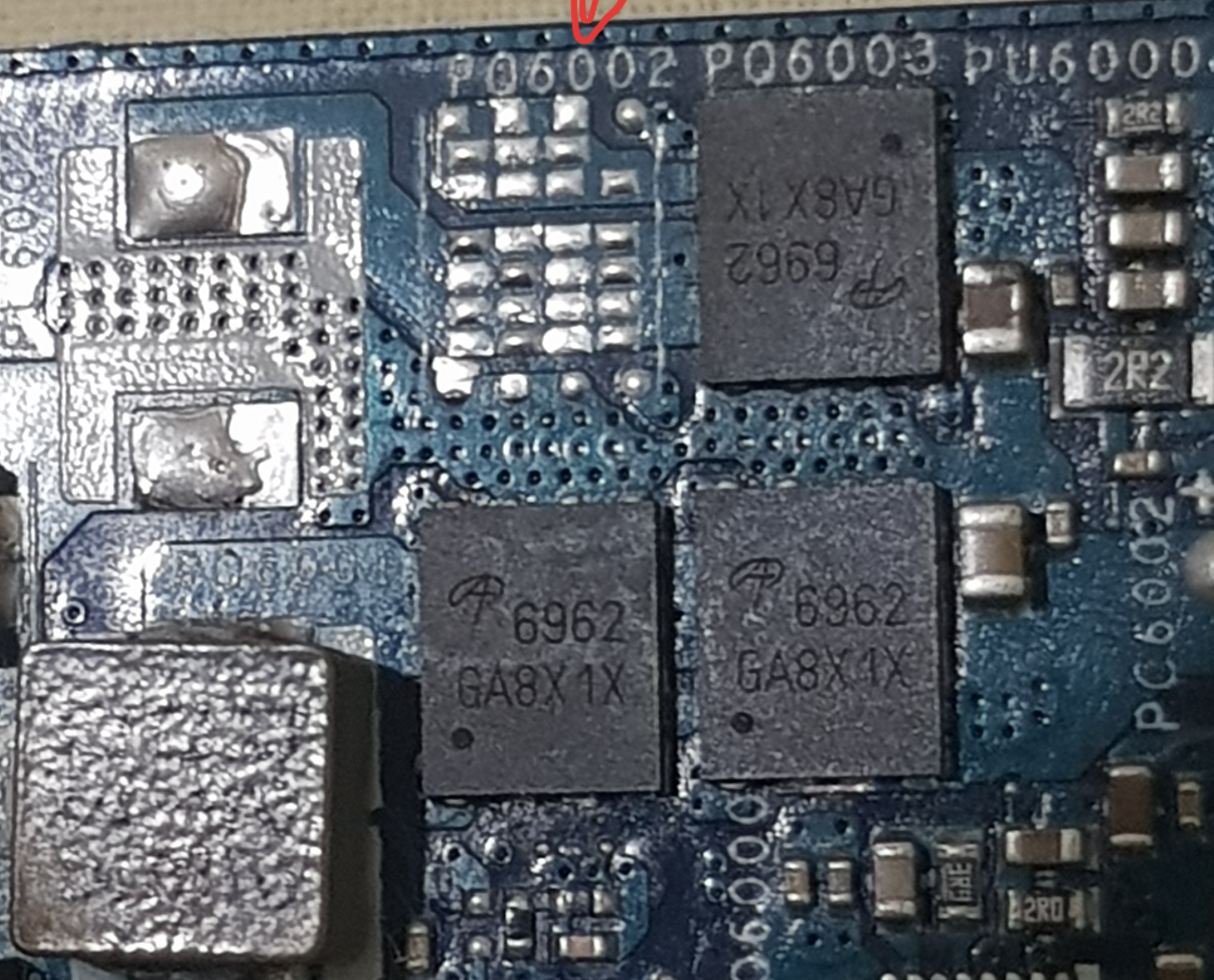

    HI friends
    I am struggling to find a compatible mosfet to the one i have ...
    mine is AON6962
    Is AON6992 compatible?
    thanks in advance

    Re: help finding a compatible mosfet to AON6962 ?
    found only 6992 datasheet
    https://cdn.badcaps-static.com/pdfs/...6d15cfea78.pdf
    but u read that 6962 is n-channel so it is compatible
    find if u have q1 or q2 6992, because q2 is more than 2times stronger
        look at schematic. i think q1 or q2 is marking of ic
        for what circuit u want it?
        100A pulsed is enough for everything except hi power CPU or GPU

          But unfortunately there is no schematics. It is for dell G5.
          It is for the GPU circuit. However, there are two mosfets feeding the same line. So yes I suppose it is over 100A feeding line but it is divided between the two mosfets.
          By the way the GPU is nvidia GTX 1050 4GB....
            thats bad. that kind of gpu requires good mosfet. what is complete marking on that 6992 u have?
            check if it is a lowside or high side mosfet. lowside mosfet can be weaker so u can use that

              the AON6992 mosfet is also feeding the 1050 GTX GPUs but in earlier versions of dell laptops. specifically in dell inspiron 7567 ... that is why I was thinking if it might match. but if there was a little difference in the amount of ampers between 6962 and 6992 then would it make a problem to use 6962&6992 to feed the same line without conflict between them....
              of course i prefer 6962 but i cant find it online to buy .. only they are available in lots not singles...
              thanks
                put it there as a lowside and u r good
                    it worked ... thanks for your help....
                          There is no lowside since it`s double transistor.It`s high and low side in one chip.
