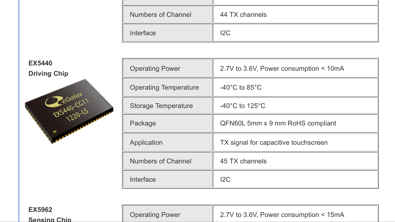

    Hello ,
    Somebody know where i can order this IC ? EX5440-CG11 (See pic)
    It is a TouchController for a device...
    I found the manufactor but i couldnt find 1 seller.....
    I only could found some informations of manufactor:
    http://www.eeti.com/EXC3000_1000.html
    Thanks for reply..

    Re: Touch -IC request EX5440-CG11 egalaxy buy ?
    They have a distributor in germany,contact them, or get a donor board . https://www.hy-line.de/linecard/hersteller/hcc/11-eeti/
      thanks for your tip, today i had contact with them but the minimum order quantitie is 5000pcs
      so i need round about 50 - 100pcs....
      maybee the is another option ?
        If you can`t find a seler ,and the distributor won`t sell you a single ic then only option is a donor board, if you can find one .
          Hello, many thnx i found a seller wich can offer me from china
          thanks for your support.
