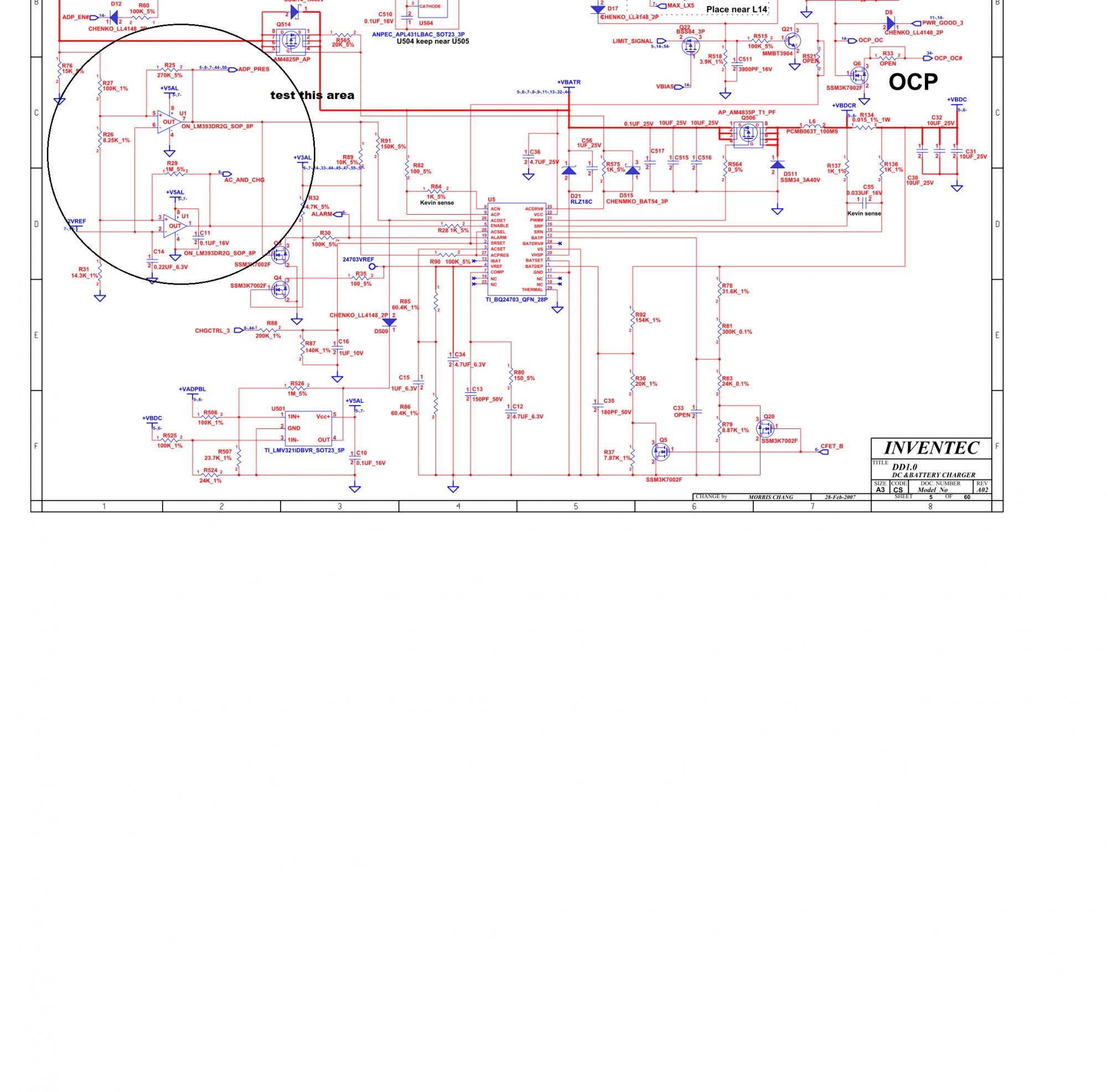

    i have compaq 6510b that will not power on with charger but can work fine with a charged batt, little check done q507- s=19v, d=17.5, d=0v pls kindly guide me to fix the fault

        DC jack pin 3 LIMIT_SIGNAL ? Q507 pin4 Gate Voltage is to high 18V to bypass it should be less than 10V , test Q507 for any short G/D/S

              LIMIT_SIGNAL trace to q22 S=5.6V, D=0V, G=0V

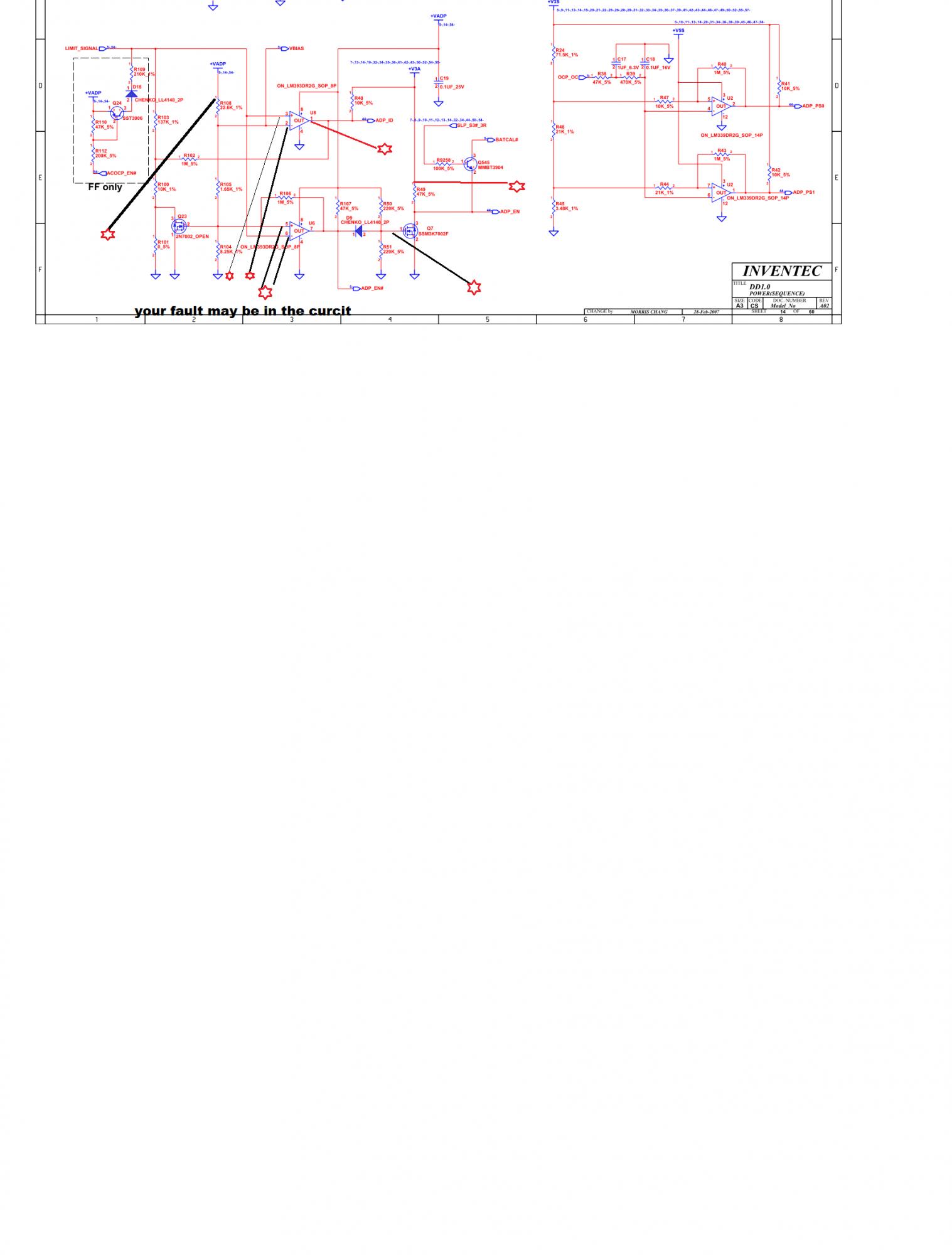

                remove Q507 put the multimeter Diode mode value S.D.G
                test all pins of Q545

                  q507 removed S=18.2V, G17.6V D=0V
                  Q545 B=16v C&E=0V
