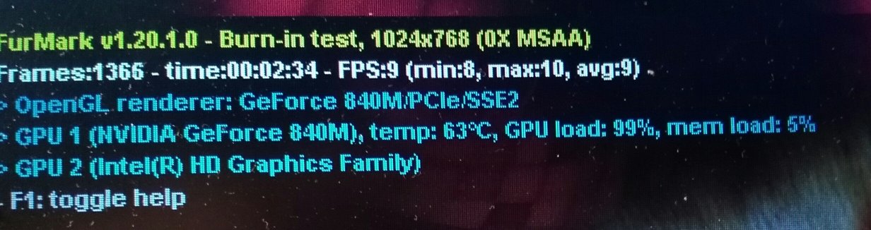

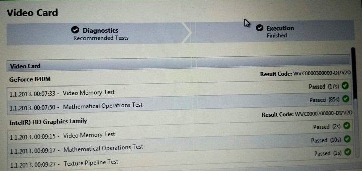

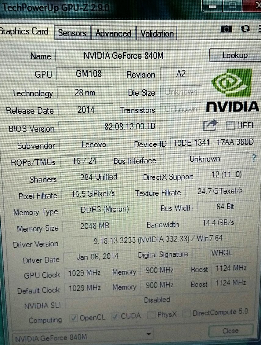

        Re: Lenovo Z50-70 crashes when charger connected, erratic working on battery

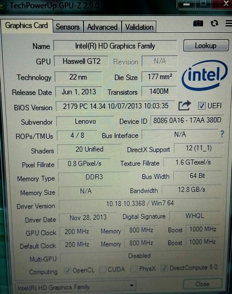

        It passed all graphic tests, works steady 30+ minutes on Furmark. Official drivers for Intel and Nvidia gpu are installed without any problems. Passed dxdiag. Passed Lenovo diagnostic on all components. Maybe the most important fact is that laptop crashes instantly when charger is plugged in? Every time. Even without hard disk. Can that be related to graphics?

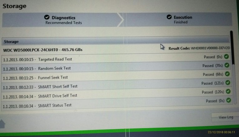

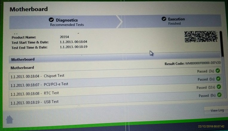

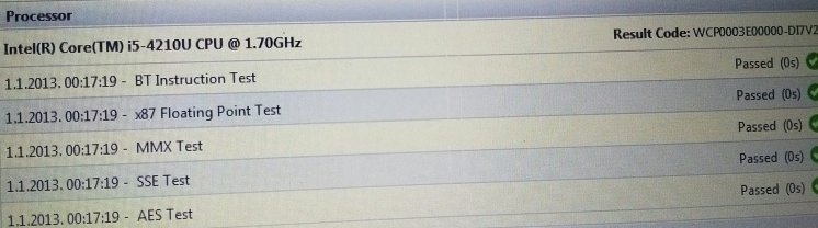

                  Some tests. I removed RTC battery so don't pay attention to the time.
