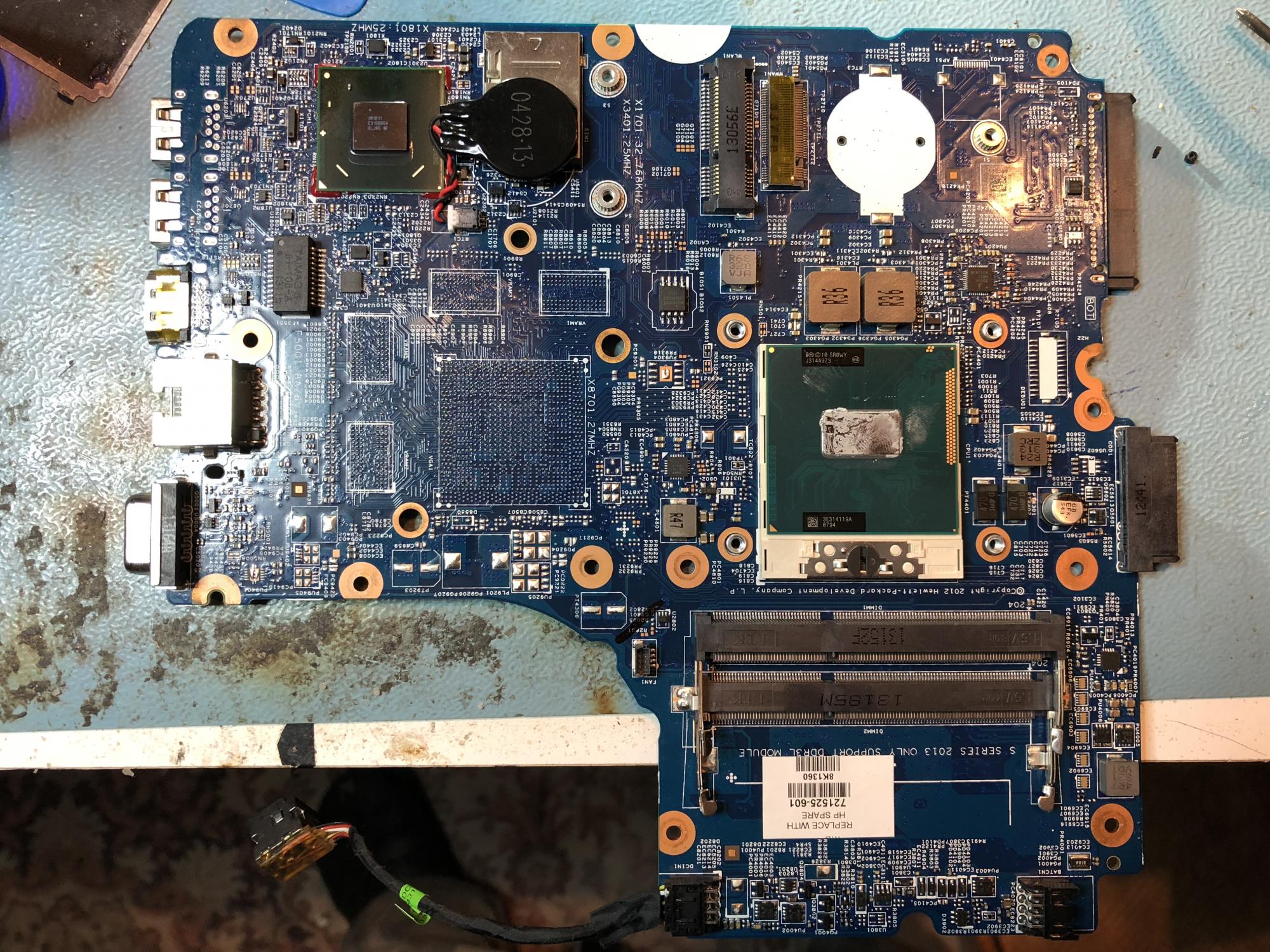

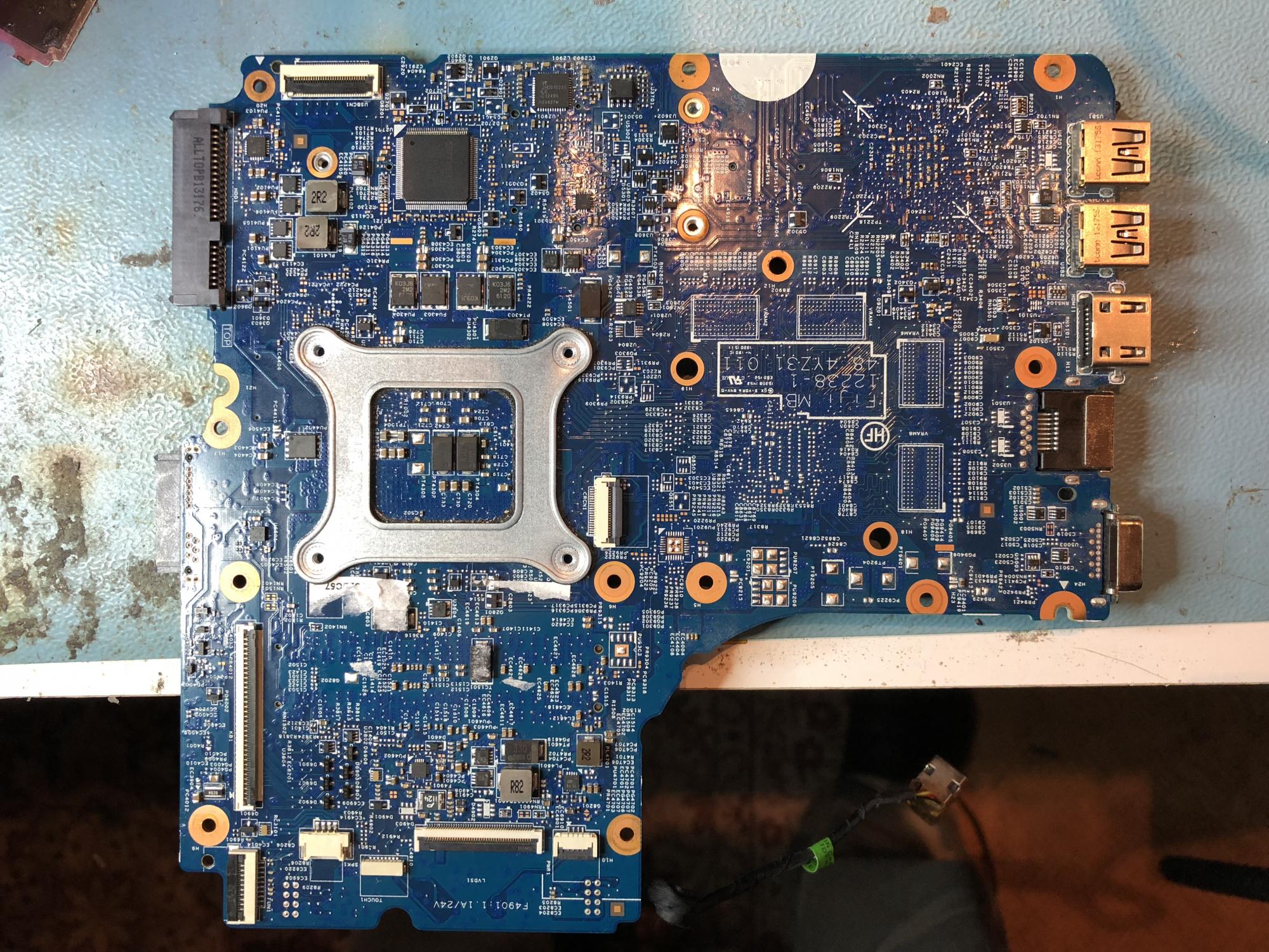

    HP 450 G0 Charging port blinking
    I have problem with this laptop. Only LED on charging port blinking. There is no 3.3V voltage on bios chip. Please help me identify chip from the picture and upload schematic if someone have. Thanks.

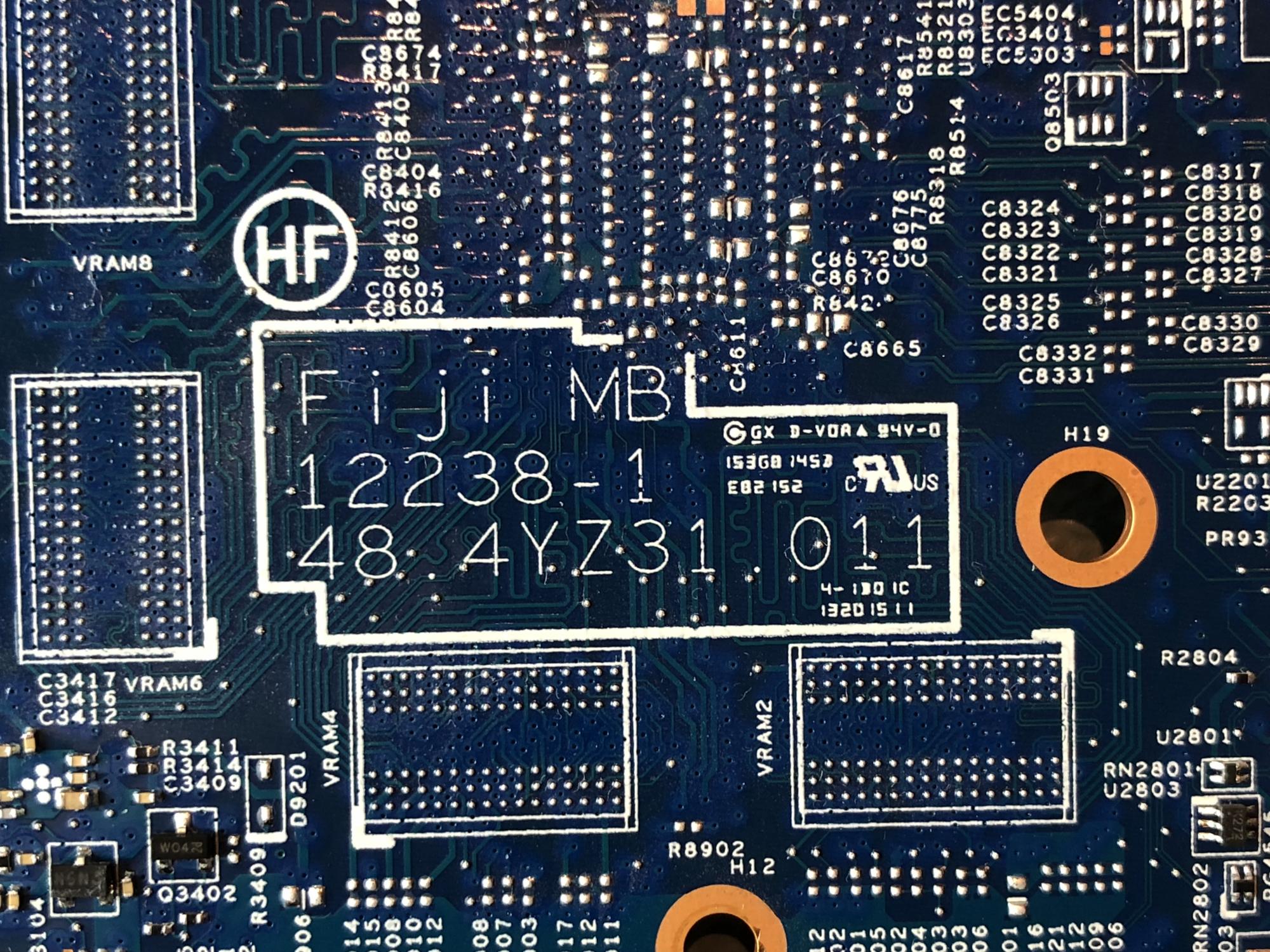

    MB:
    Fi Ji MB
    12238-1
    48 .4yz31.011

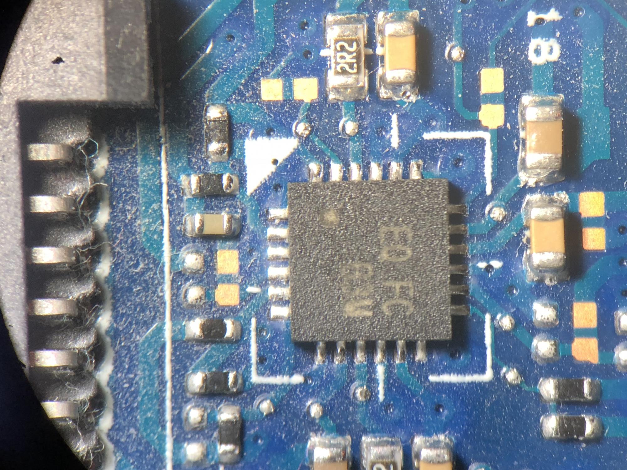

    CHIP: E0 FC
    edit: It is EQ FC - RT8223M
    1. 0V
    2. 0V
    3. 2V
    4. 2V
    5. 0V
    6. 0V
    7. 0V
    8. 3.3V
    9. 4.5V
    10.0V
    11. 0V
    12. 0V
    13. 5.2V
    14. 3.3V
    15. 0V
    16. 18.5V
    17. 5V
    18.0.4V
    19. 0V
    20. 0V
    21. 0V
    22. 4.5V
    23. 0V
    24. 0V

    Re: HP 450 G0 Charging port blinking
    I have 3.3V always power here, on power button also. I don't have voltage on the bios chip, I don't know why. Have someone schematic please? I found only similliar schematic, I attached it.
    When I inject 3.3V to bios chip, LED on charging port blink and stay off, but after press power button nothing happen.
      R2509 Out side you should get 3D3V_AUX_S5 from Pin 8 RT8223MZQW 5/3 Volt regulater LDO3 inside of R2509 connected to Bios chip 1 pin 8/3 Bios2 pin8/3 3.3v
                    Originally posted by DeniS182
                    I have new original HP 4.7A charger. And Id PIn on charging port is ok.
                    When I inject 3.3v to bios chip current consumptiion is 130mA and when I also connect charger 370mA.
                    I would prefer check continuity between pin 8 bios chips to know where is source of power, where that pin is connect?
                    According schematic S-Series Intel Shark Bay as reference, the source connect via resistor R2508/switching or R2509/LDO (both value are 0 ohm or just jumper pad/shorted)
                    DY/light green= not installed.
                    3D3V_S5 =output RT8223M switching
                    3D3V_AUX_S5= LDO of RT8223M.
                    -ADP_DET shoud be high
                    -LID_SW# should be high.
                    Also pin 18 for Enable switching didn't go high. That's why there aren't outputs of IC RT8223 on grey coils.
                    The amperage have approx 130-370mA mean have resistance 9-24ohm, seem to low. Correct me if I wrong to calculate it. Look like this rail have little shorted.
                            Problem was in missing ENC signal on RT8223M after inject 3.3V here notebook works normally.
                            • Techtiger
                              • Oct 2014
                              • 1602
                              • france
                              So ENC enable 2 SMPS plus connected internally to VREG3 , then your RT8223M is faulty in that stage is your 3/5V ALWS output after pressing Power Button? or after inject 3.3v to ENC ? And for the PGOOD signel comes after pressing power button or after 3/5V ALWS ?
                              • DeniS182
                                • Jun 2014
                                • 328
                                • Slovakia
                                I tried replace IC first, but nothing changed. Then I inject vreg3 to ENC pin and notebook works normally. After power button is pressed notebook start and works fine. I put all back together.
