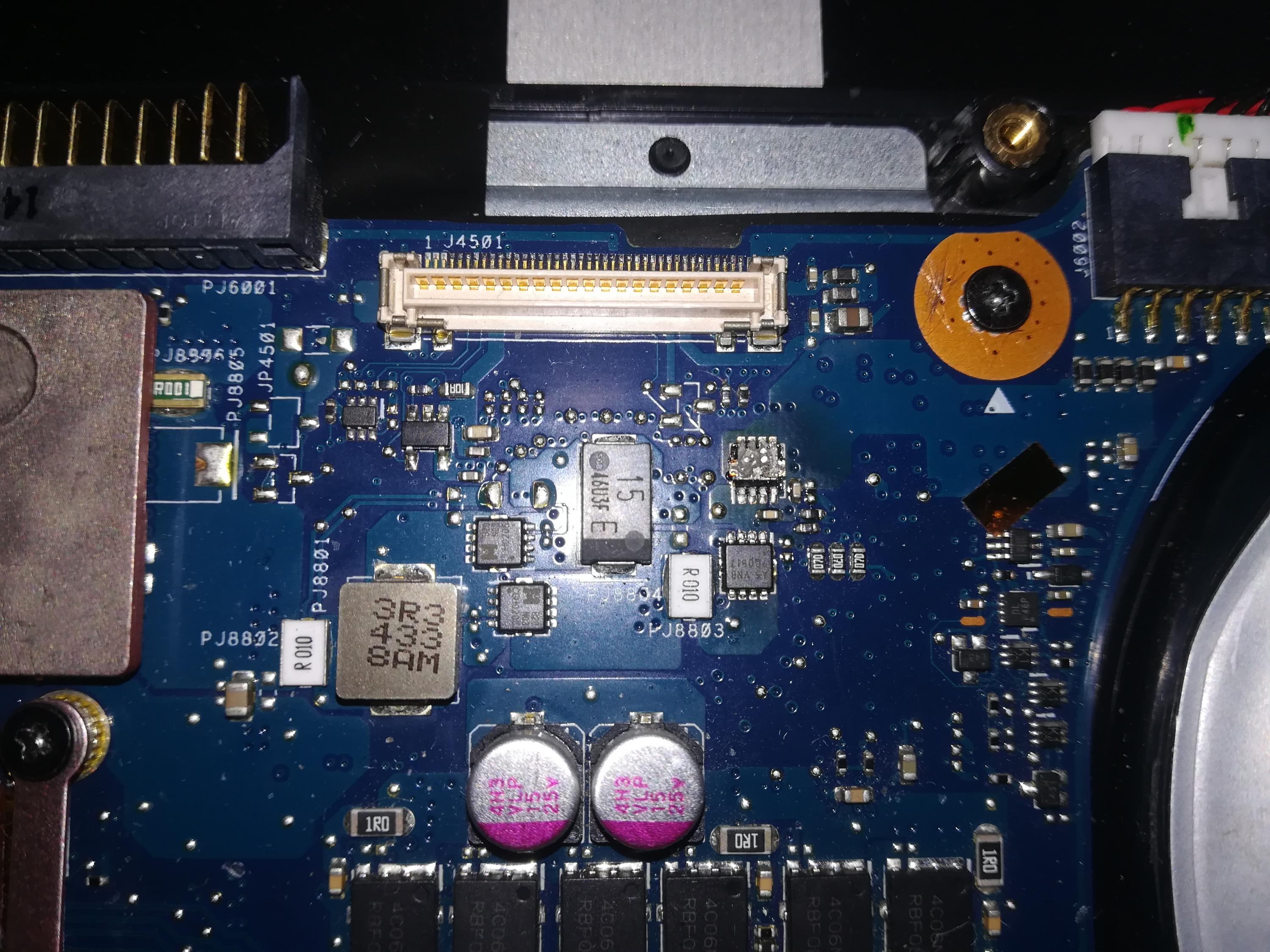

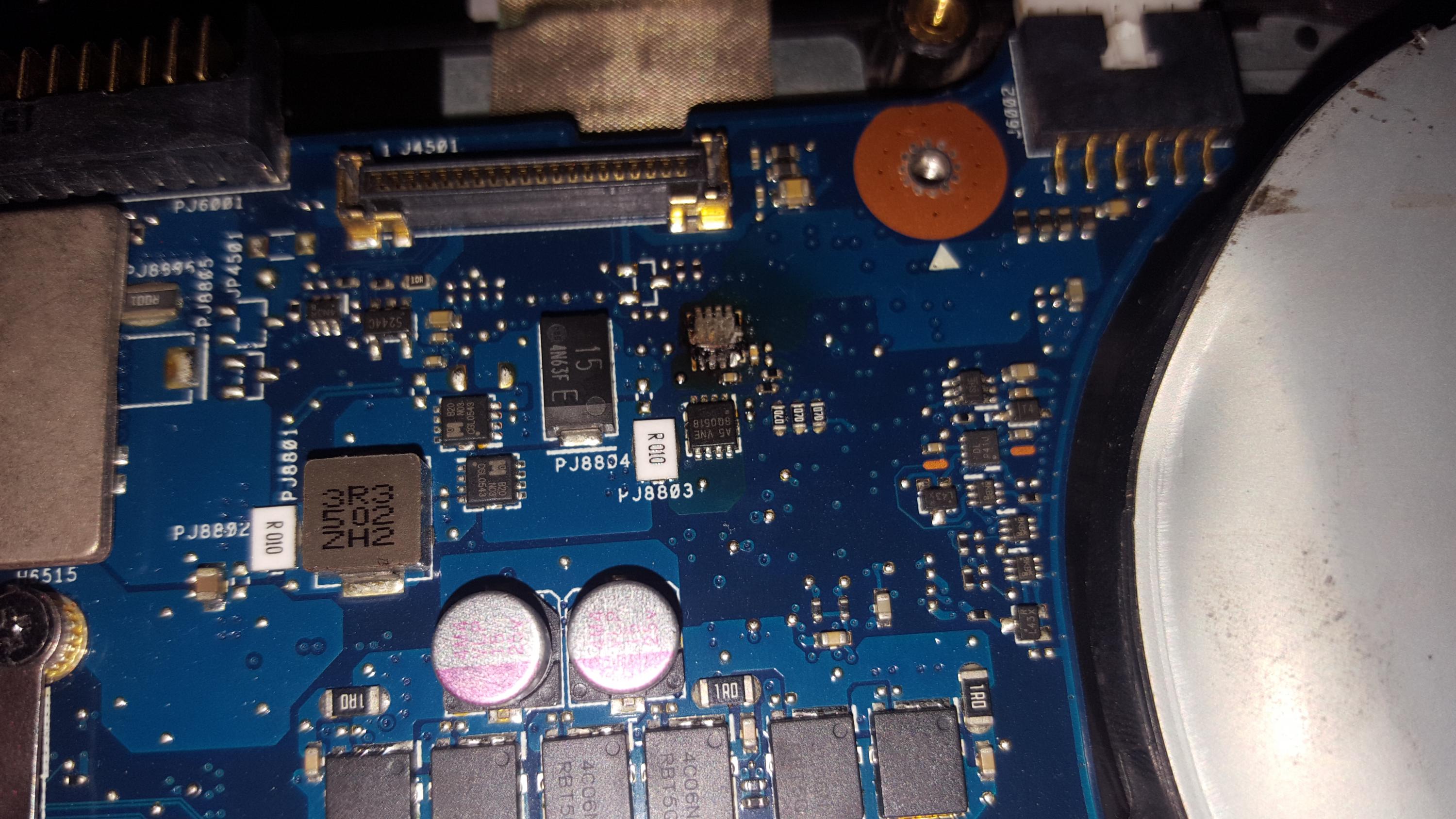

    Hello
    So i had a bad motherboard with a bad A5 VNE dosen't power UP without a battery so i change it but made a mistake and remove one of two good wich was good i know ...
    So i changed it with a A5 GND but the battery dosen't charge so i thought may be it was the ic charger but coudnl't understand if it was the case or not i noticed there was big large track from the ic charger to the battery wich seems odd so i guess may be it really needs a A5 VNE .
    I noticed on a good mobo for the Asus N551JM that on the A5 VNE on the gate i got 23,4 volts but not on the A5 GND just 19 volts .
    So it was strange the two A5 VNE are the first step of the power supply .
    I checked also and A5 VNE and A5 GND should be compatible and intercheangable .
    Finally i took 2 mosfet from a Asus X555LD and it works fine now laptop are charging the battery .
    But why the A5 VNE and the A5 GND are different ?
    Any idea ?

      Both are N channel 30V,48A mosfets-so are same and replaceable. Earler fets or one of them might be defective.

        Re: Asus Rog G551JM not charging and A5 VNE / A5 GND
        Yes it should but no , i tried with 4 of them i ended taking a A5 VNE from a working mobo and changed the first one i mean the top one by that A5 VNE and now everything is working fine and all the tensions are there battery charging , mobo working fine ...
        And i don't understand why i got 23,4 volts on the gate of that mosfet , where is coming from , from the mosfet or the mobo ?
          Getting 23v at pin4(Gate) is normal as its a N channel mosfet. For any N channel mosfet , gate voltage is 19V+6v approx. For P channel , The gate voltage is lower then 19v(Usually 6-12V). So its fine. The gate is controlled by your charging IC.
            gate is driven by buck circuit that boost base to 24V
