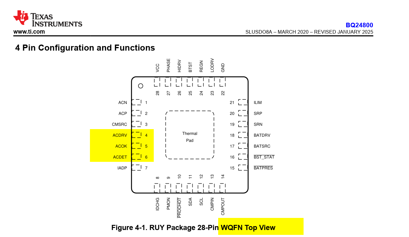

    Attach the power adapter. Measure the voltage to ground of:
    ACDET
    REGN
    ACDRV

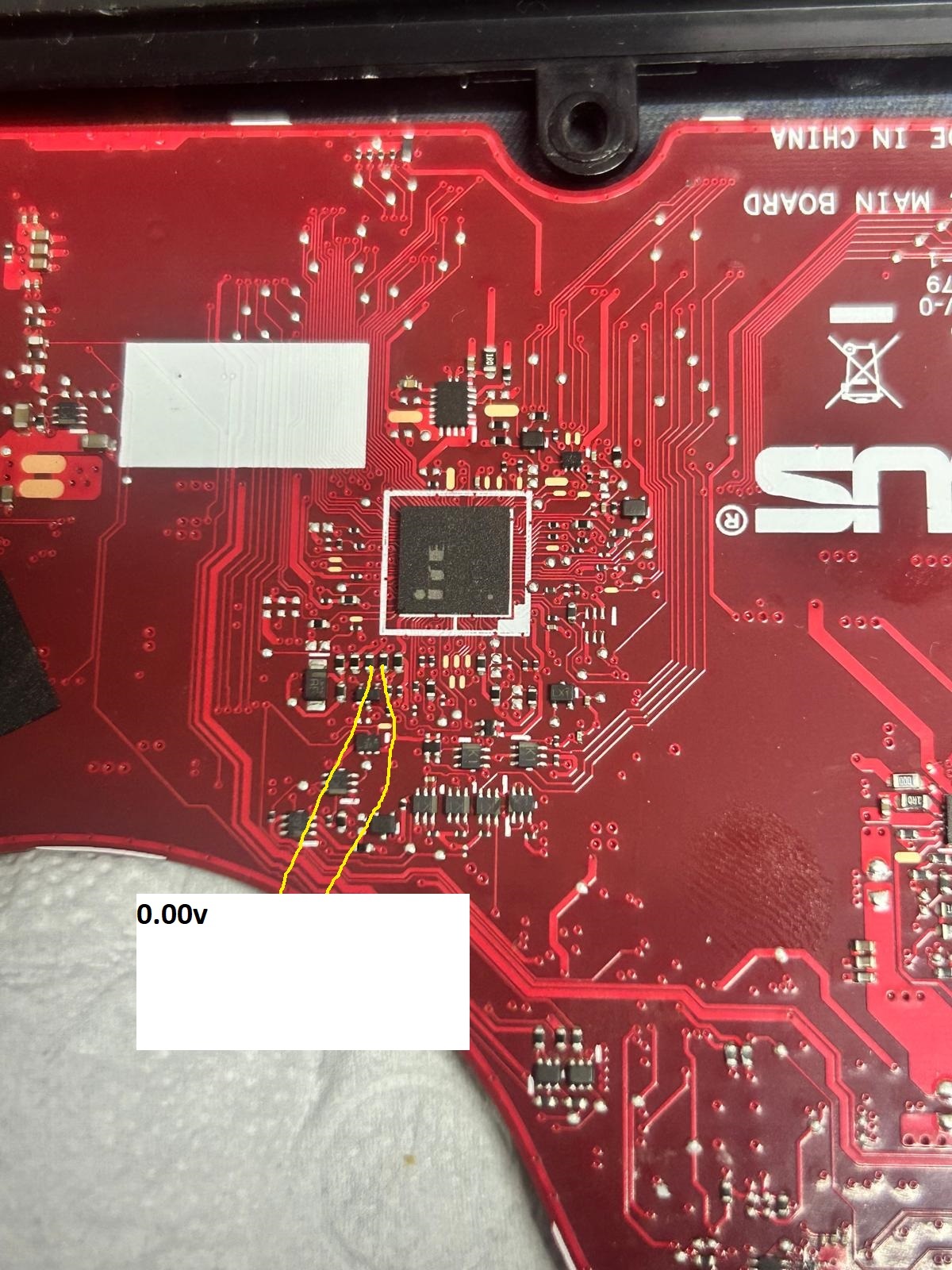

        See attached. Proceed only if your meter leads are fine tipped. Otherwise, the short circuit of the pins can be lethal to the board.
        Black meter lead to ground. Red (fine tipped) lead to pin to test. Meter in 30V dc scale or higher.
        If all is well, ACDRV should be ~25v. REGN should be ~6v. ACDET must be 2v4 or higher else the DCin mosfets will remain disabled.

          Click image for larger version  Name:	top_view.png Views:	20 Size:	77.6 KB ID:	3728113
          I checked the voltages as you suggested. ACDRV is around 25V, REGN is about 6V, and ACDET is above 2.4V, so the readings look fine. However, the battery still does not charge with the DC adapter. Do you have any idea what else I should check?

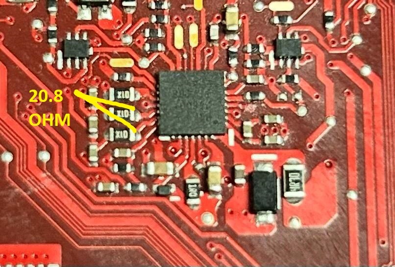

            Remove all power. Meter in resistance mode. Measure the resistance directly on pins 19 & 20 on the charger ic. One meter probe on pin # 19. Other meter probe on pin # 20. What is the resistance in ohms?

              I removed all power and measured directly on pins 19 and 20 of the charger IC with my UNI-T UT33D+ multimeter set to the 200Ω range. The reading was about 20.8 ohms.
              • mon2
                • Dec 2019
                • 14681

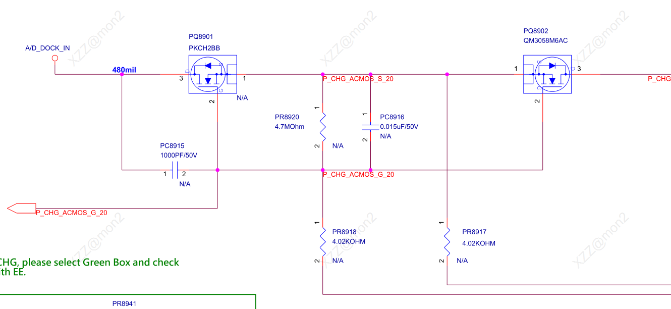

                This leg of the circuit is OK (comparing against the schematics of v4.0) = ~20 ohms.

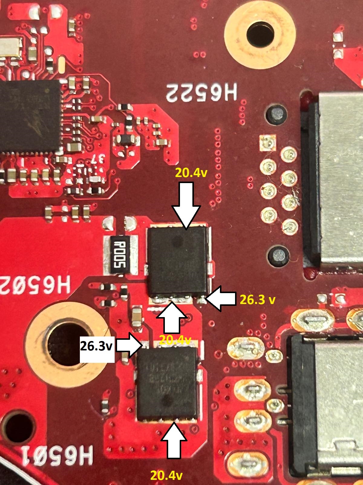

                Remove the pre-charged battery. Attach only the power adapter. Does the logic board power up normally? If not, measure the voltage to ground of the DCin mosfets.
                PQ8901 (1st mosfet)
                source (1-2-3)
                gate (4) ; should be ~25v
                drain (5-6-7-8)
                PQ8902 (2nd mosfet)
                source (1-2-3)
                drain (5-6-7-8)

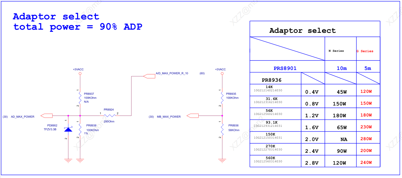

                  Measure the voltage to ground of the following with the power adapter and battery:
                  MB_MAX_POWER ; this voltage is critical and defines what the logic board is detecting as the power rating of your external power adapter
                  If this voltage is not correct, the battery will not charge.
                    PQ8901 (1st mosfet)
                    source (1-2-3)
                    drain (5-6-7-8)
                    PQ8902 (2nd mosfet)
                    source (1-2-3)
                    drain (5-6-7-8)
                    Click image for larger version  Name:	dcin_mosfets.png Views:	0 Size:	71.0 KB ID:	3729129

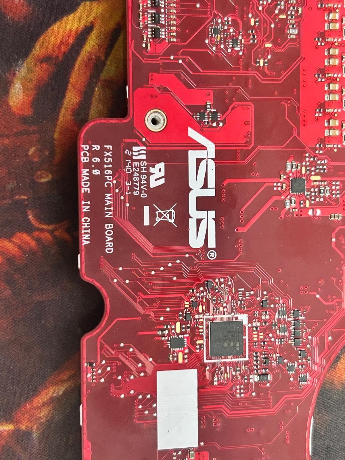

                    I have taken the voltage measurements you requested on PQ8901 and PQ8902. I marked all the readings directly on the schematic/image and attached it here for your review
Name:	WhatsApp Image 2025-09-20 at 16.15.04.jpg

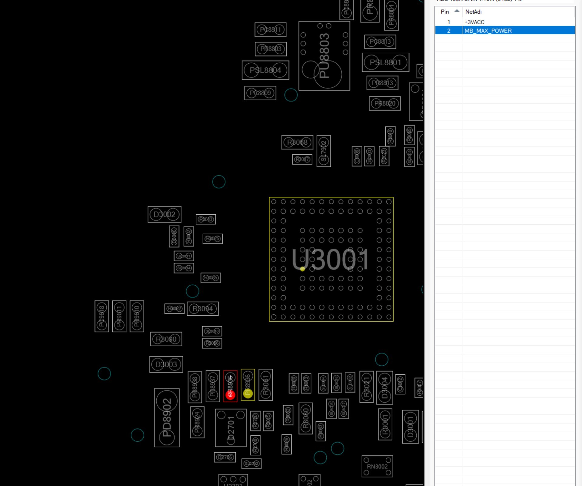

                      [QUOTE=mon2;n3729133]Measure the voltage to ground of the following with the power adapter and battery:

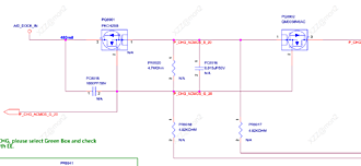

                      I couldn't read the value at MB_MAX_POWER. In my schematic, under the IO integrated circuit, this point.
Name:	WhatsApp Image 2025-09-20 at 16.37.07.jpg
ID:	3729157 Click image for larger version
Name:	Ekran görüntüsü 2025-09-20 163505.jpg

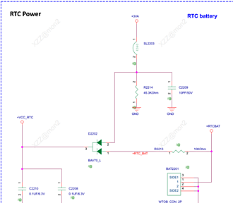

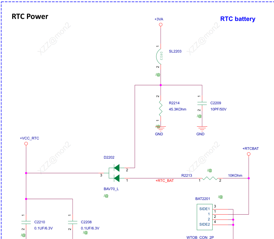

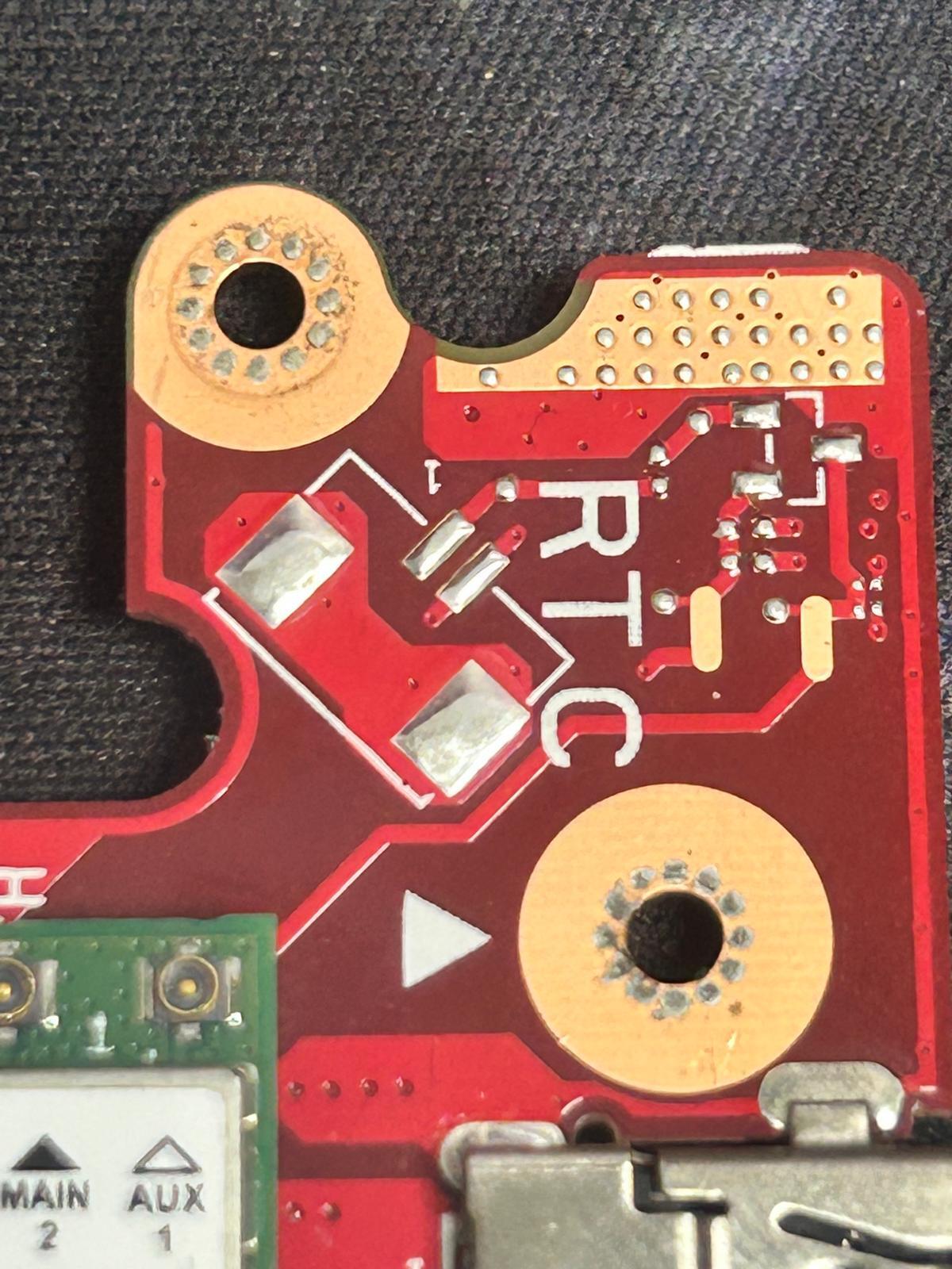

                        Confirm the presence of a RTC battery. Measure the voltage to ground of this battery which should be ~3v.
                        (from another board schematic but should be similar to yours)

Name:	WhatsApp Image 2025-09-20 at 16.59.00.jpg
                          In my board, the battery is integrated (not removable) and the related +3V circuit components shown in the schematic are missing. The battery circuit area is also empty, so it seems incomplete compared to the diagram.
                          • mon2
                            • Dec 2019
                            • 14681
                            Ok. Confirm if you have ~3v on the other side of resistor R8935. This voltage is required to have a non-zero voltage @ MB_MAX_POWER.
                            • lazenes
                              • Jun 2016
                              • 41
                              • Türkiye
                              I checked resistor R8935, but there is no 3V on either side of it.

                                    Can you share the boardview diagram for your board? It is not in my database. Or link in the schematic sub-forum. Is the boardview diagram matching your board exactly?
                                    • lazenes
                                      • Jun 2016
                                      • 41
                                      • Türkiye
                                      The schematic I have is for rev 4.0, while my actual board is rev 6.0. The diagram matches about 85% of the board, but there are some differences.
