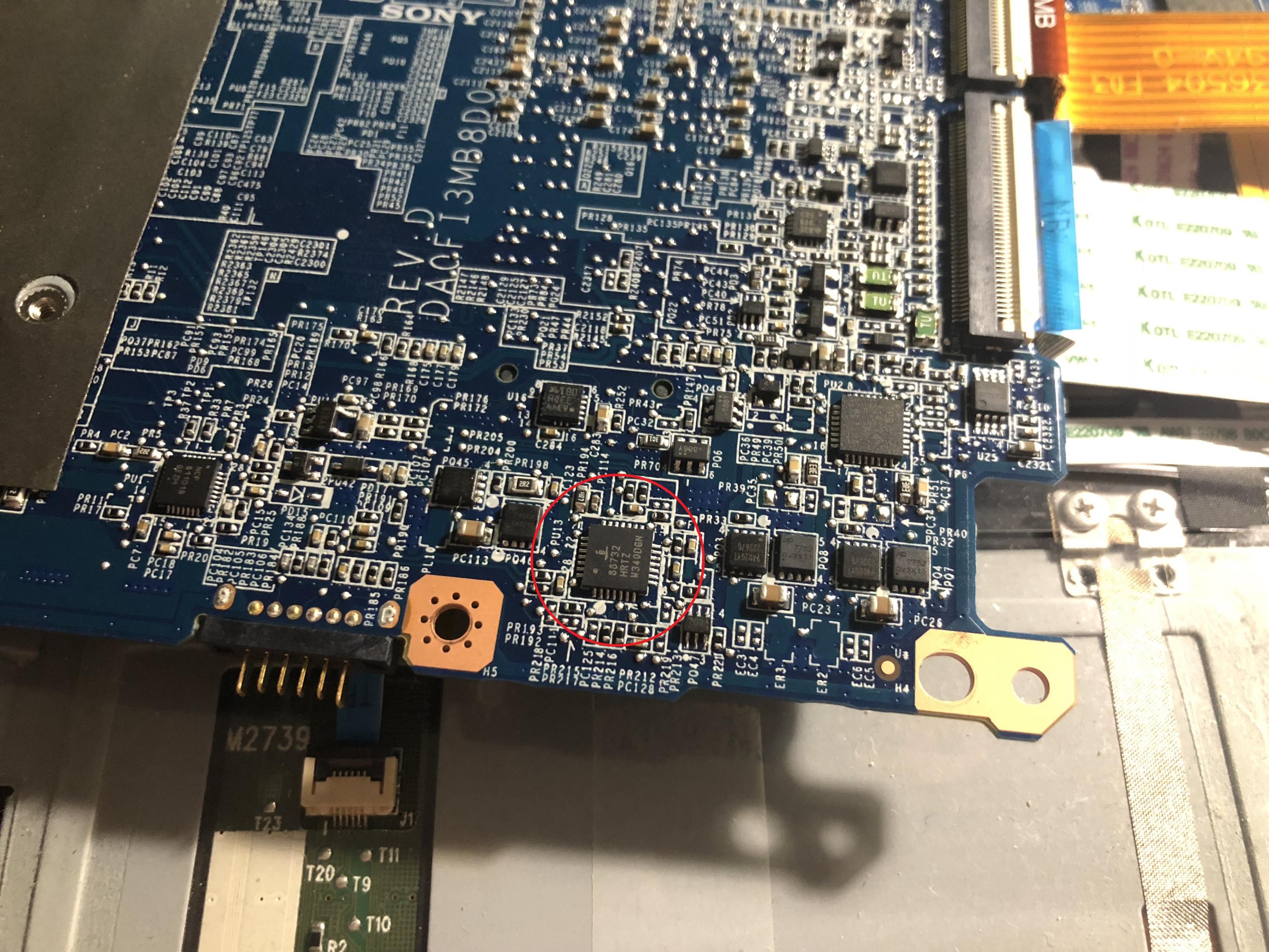

    i have this laptop ,all things working with DC adapter
    but dont can charging battery, when installed battery , battery led fast blinked and dont can charged.
    i tested with another battery, ist same. also another DC adapter.also measured all pin for ISL88732 (chip charging) . i thinks ist ok
    any person have good experiment about this problem ?
    thx

      how much voltage are on pins of the battery connector when the battery is connected to the laptop?

        0 volt
          Re: Sony VAIO multi-flip svf15n1 charging problem
          how much voltage is on battery connector pins without battery?
            again , i tested with battery
            in 1 second, 4~5 Volt and aftera second, down until 0 volt
            without battery, ist 20mv
              these voltage values are not fine. now you should check all the charging circuit without battery to find a shorted point or corrosion or etc.
