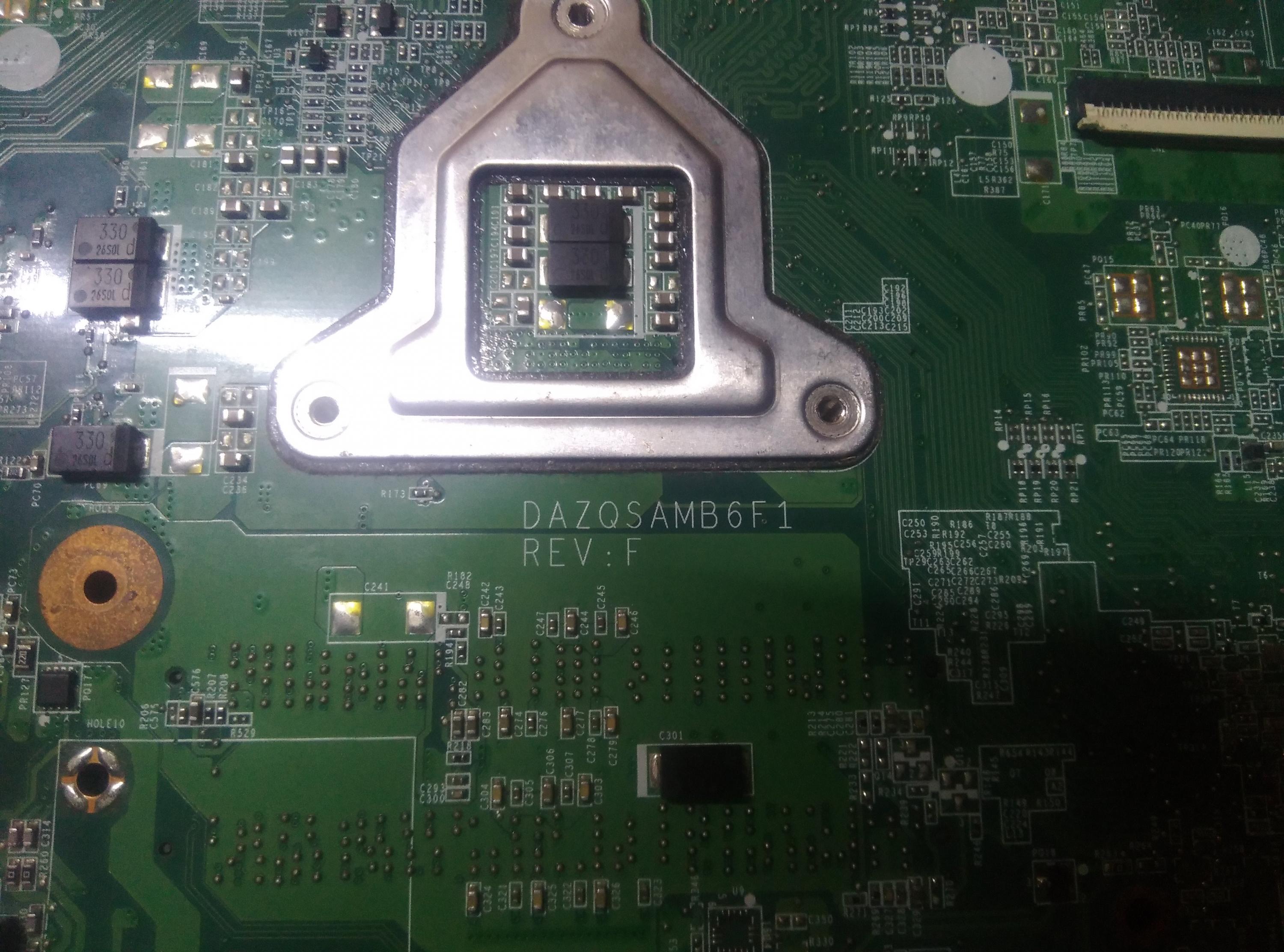

    Just a small tips, if you search for laptop schematics don't search using information in the label on the laptop casing, search using information printed on the mainboard. Example picture attached, in this example DAZQSAMB5F1 REV. F
