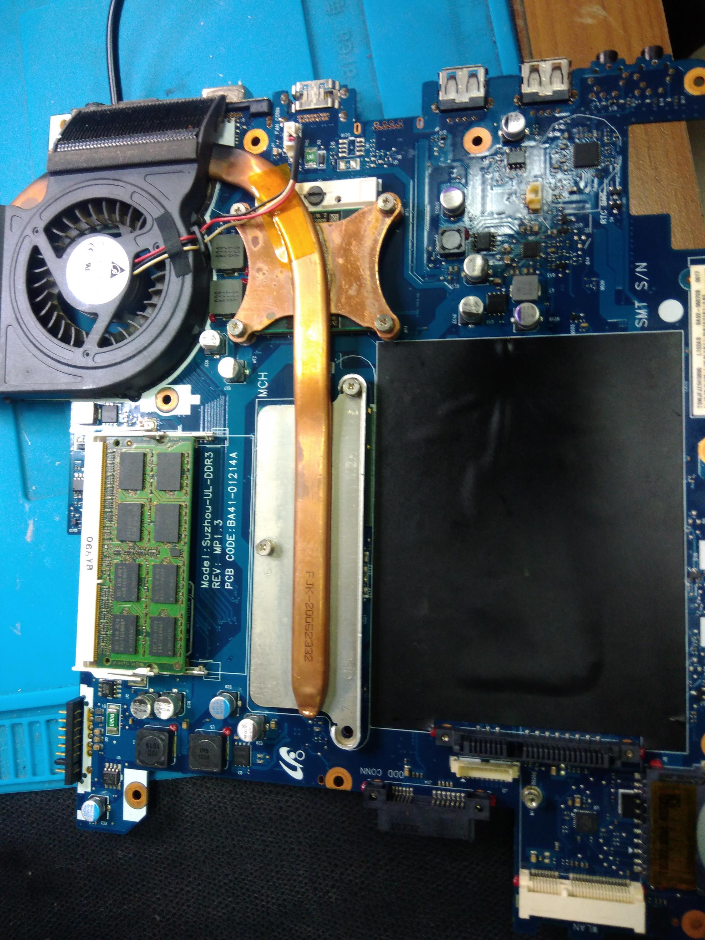

    hello every one. i just wanna ask for help. i got samsung r428
    model: suzhou-UL-DDR3
    BA41-01214A
    Can't power on.

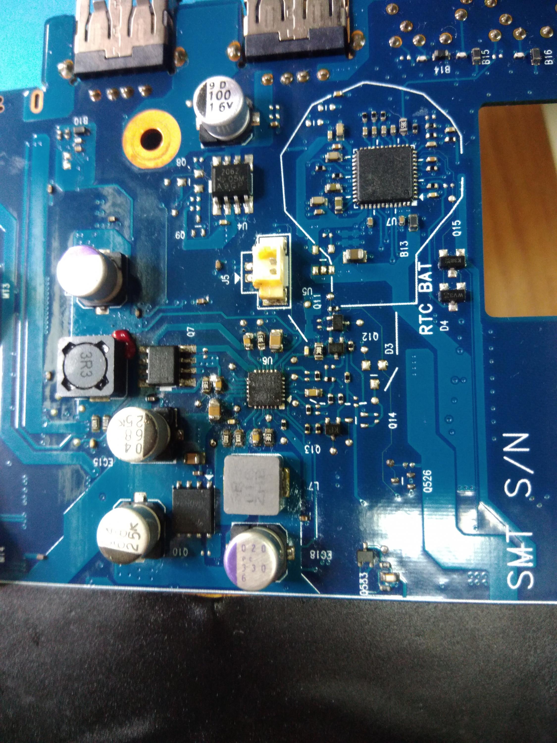

    checked : 19v line is ok
    there is no 5v & 3.3v on coil
    and i notice TPS51125 for 5v & 3.3v supply is getting hot.
    i already tried to replaced it but no luck it was same
    could anyone help me to find out what was the problem.
    thanks.
    tps 51125 checked Pin output voltage
    pin 16 VIN 19V
    Pin 13 ENO 4.8v
    pin 17 VREG5 3.9v
    pin 3 VREF 2v

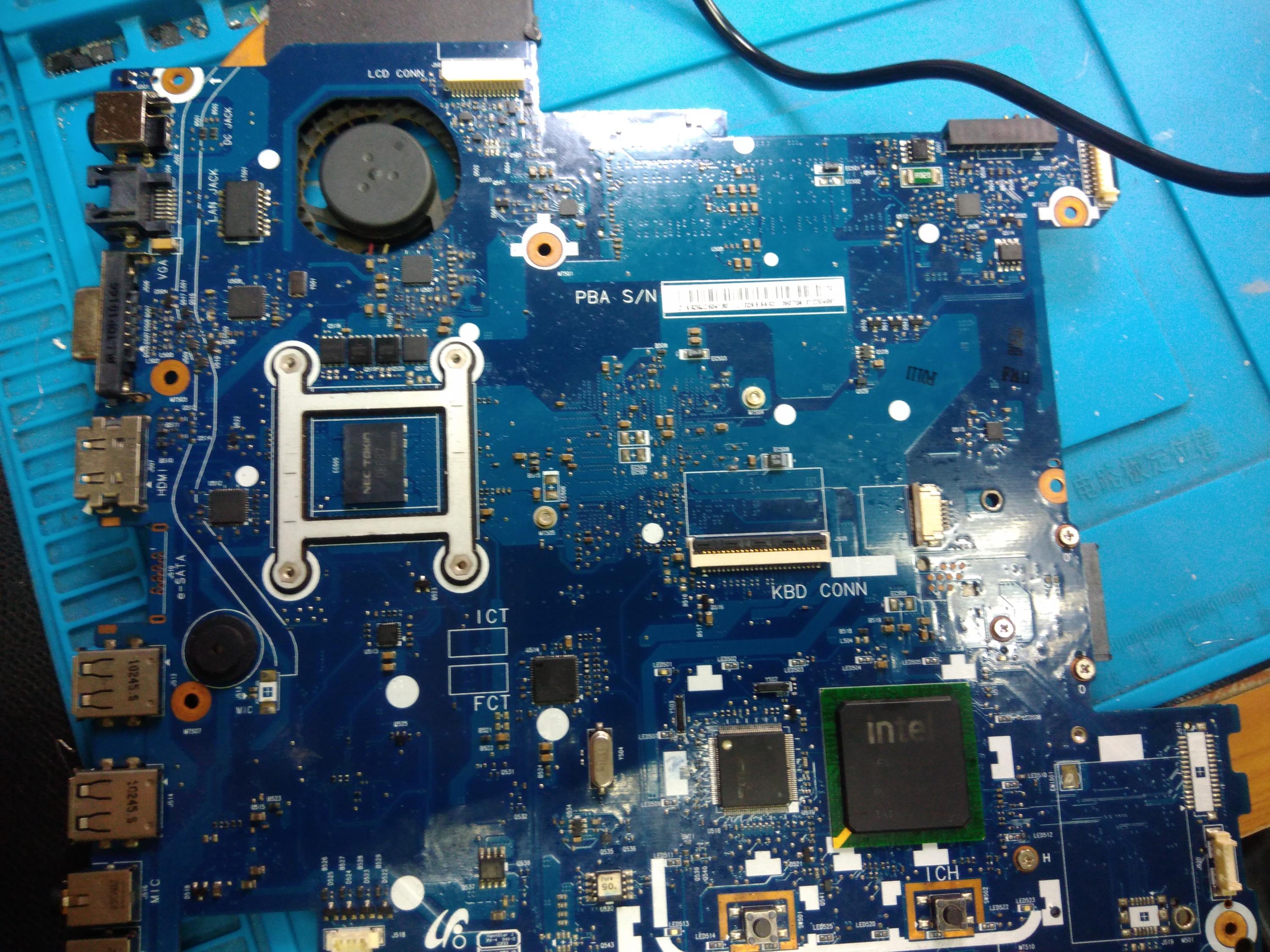

          this goes to KBC Controller U516 Pin14,39 and some other
          check for short

                  here is the schematics:
                  https://www.badcaps.net/forum/attach...5&d=1500837159
                  how much resistance is at Pin8 and Pin17 and L6 and L7 relative to ground? the value of resistance is important.
                  • rickybucalan
                    • May 2013
                    • 322
                    • philippines
                    Re: samsung R428 no power
                    i got
                    04.15k ohm pin 8
                    083.0k ohm pin17
                    1.880k ohm L6
                    15.70k ohm L7
                    • caspian
                      • Oct 2015
                      • 1591
                      • Laptop
                      how much voltage is at pin1 and pin6 of tps51125?
                      • rickybucalan
                        • May 2013
                        • 322
                        • philippines
                        no voltage at pin 1 and 6
                        • caspian
                          • Oct 2015
                          • 1591
                          • Laptop
                          considering all the symptoms, it seems tps51125 is faulty itself. but I am not sure. if tps51125 is available from scrap boards, replace it again.

                                check the impedance of smd capacitors around ICH(U517) and SIO(U516).
                                Once i got the same problem,that time my SIO was faulty. Replaced SIO. it got ready.

                                  I'll suggest to remove kbc, clean the pads on mb and connect ac adapter and check tps51125 is getting hot or not.
                                  • dj_ricoh
                                    • Jan 2013
                                    • 2073
                                    • uk
                                    If that tps gets hot then there is something shorted to ground.
                                    If kbc it's shorted then you can't power if you lift it right?
                                    There need to be an output that tps it's giving that is shorted.
