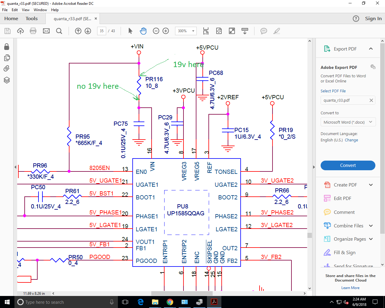

on page 35 i got 19v on one side of pr116 but nothing on the other side..ive already changed it but same result..attached here was schematic..thank you in advance
need help quanta r33 rev 3.0
Re: need help quanta r33 rev 3.0
Check PC75 -
It doesn`t have to be shorted, take it off and see if voltage comes up, if it does make sure to put a new cap on there ,don`t leave it off.Comment
PU8 pin 16 (VIN) may be shorted to ground. Or there is a break in the line between PR116 and PU8. Or either PR116 or PU8 is not soldered properly. Also make sure PR116 is indeed 10 ohms.OpenBoardView — https://github.com/OpenBoardView/OpenBoardViewComment
ive already change pr116 and still no 19v on the other side of it..pull-out pc75 still same result..ive notice that pu8 is getting hot..thanks by the wayComment
PU8 shouldn't get really hot, try to replace it.OpenBoardView — https://github.com/OpenBoardView/OpenBoardViewComment
