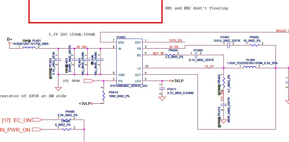

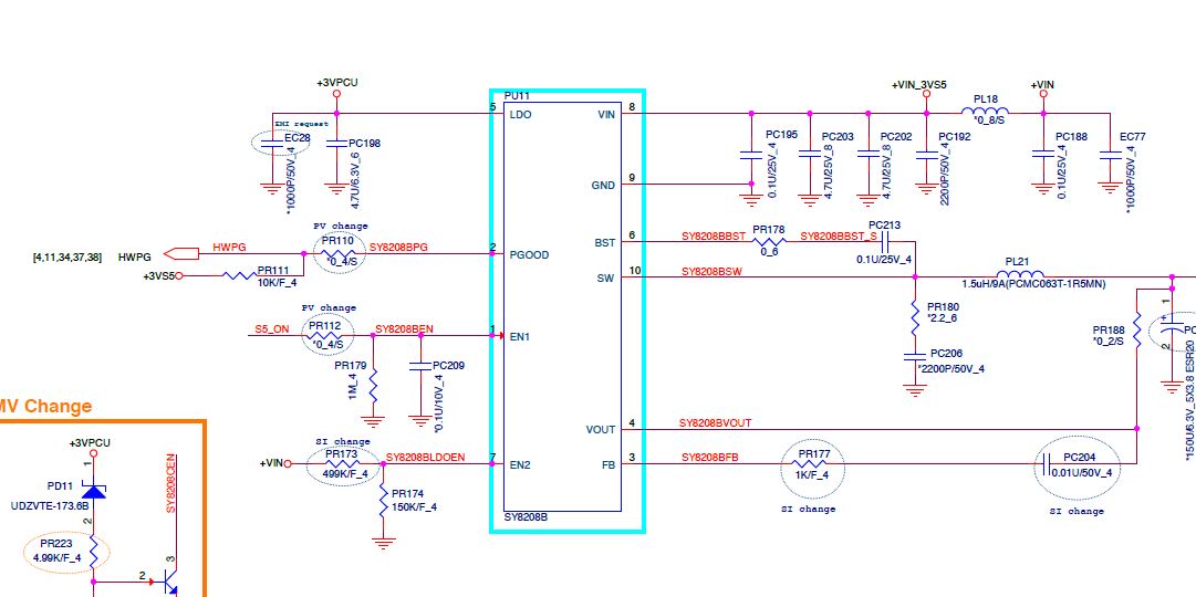

    I'm searching a datasheet of the SYX196BQNC with no luck so
    it's possible to replace SYX196BQNC (lenovo yoga 3 _LA-A994p ZSO50) with SY8208B (hp y11A)
    I have another chip marked MS3KD but I don't have any info
    thanks

    MS=SYSX198BQNC=SY8208BQNC
    So i dont think it is equivalent. SYX196BQNC=RIxxx
    Dont know much about this IC.

      Re: lenovo yoga 3 11 compatibility part
      thanks
      Based on your circuit diagram, both are same
        syx196bqnc equivalent sy8206bqnc tested 100% working
