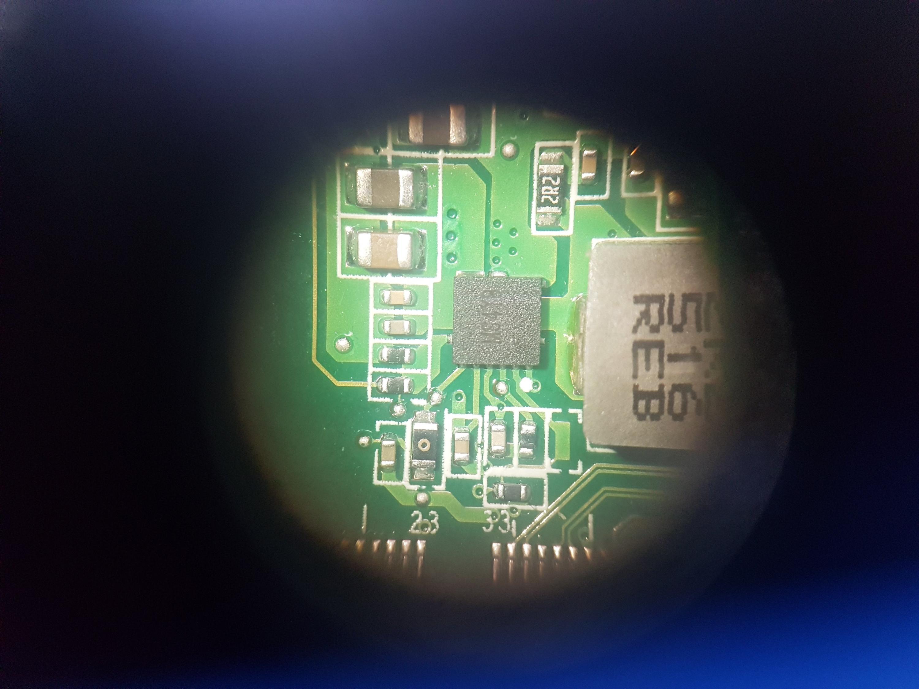

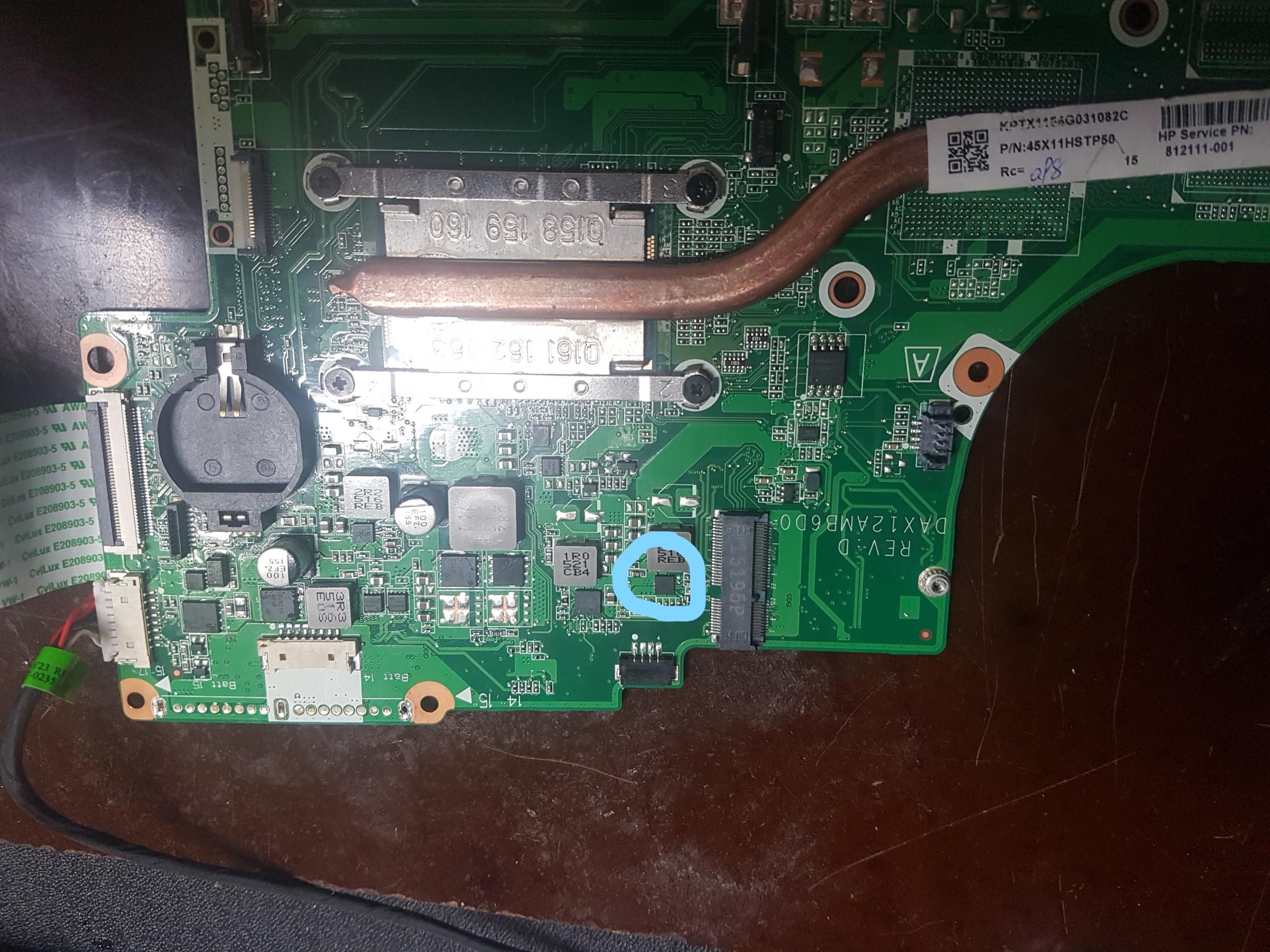

    hi hp motherboard :HP 14-ab015tu - DAX12AMB6D0
    No power, and looks like is a short on the component marked on picture 1.
    on the component is marked as MS4Y8 and was imposible for me to find any info about it and no boardview file to find it.
    Pease any help on the componenet or better providing the brd view file?.

    Re: hp Mainboard component find help
    is there any schematics file available for this laptop? if so, you can find the IC easily.
        look for schematics of mainboard model: Quanta X12 or Quanta X12A
              Seem it silergy's IC SY8208B
                Yes looks like SY8208 Here is a link to one with almost the same letters, https://www.aliexpress.com/item/10pc...9d15ee3ed37-29
                  Originally posted by R_J
                  Yes looks like SY8208 or sy8206 I also see similar number SYX198CQNC, but is likely SY8208
                  Thank you very much. will order one now.
